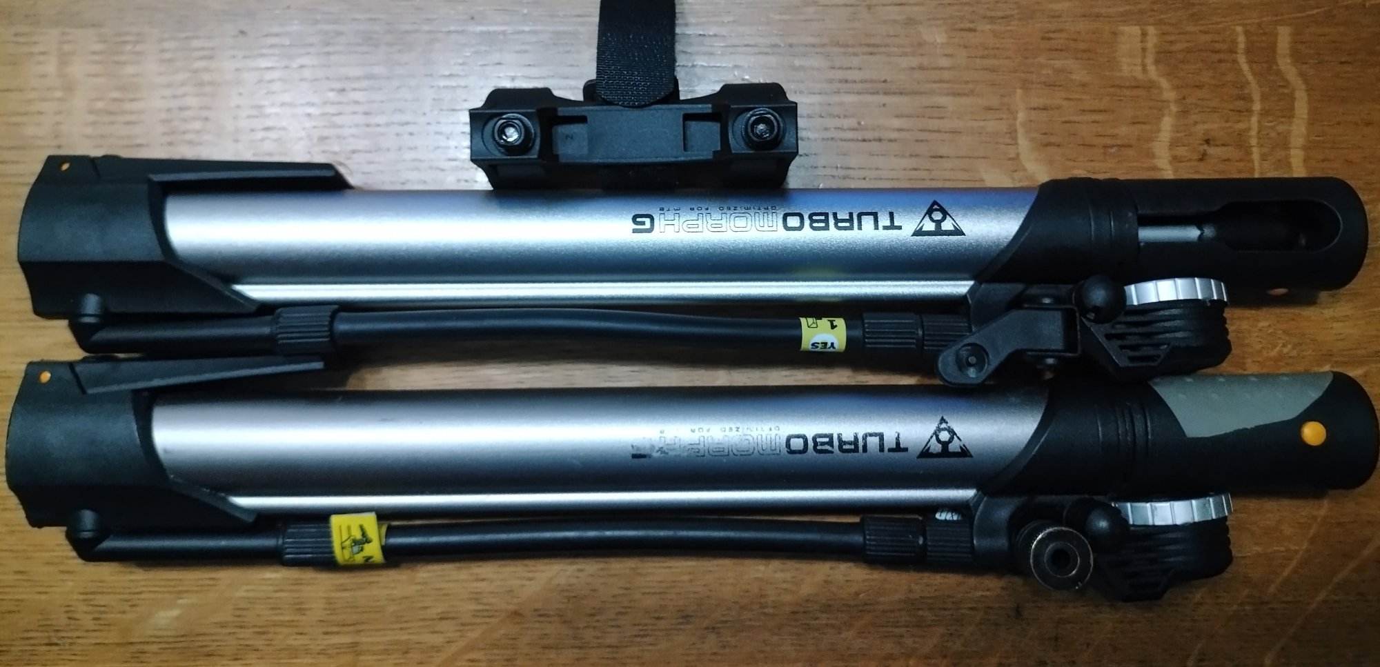

What I do use is this larger pump called Topeak Mountain Twin Turbo G. It can deliver up to 58 psi, which is fine for all my purposes. Each stroke (both directions) produces the air. The pump is designed to produce a large volume of air fast. The gauge shows you precisely where you are. However, I have never tried to mount this MTB pump on any of my e-bikes (I carry it in a pannier).
