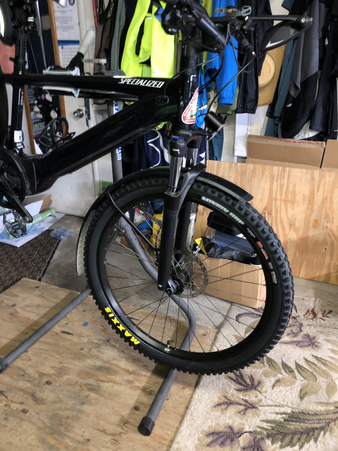

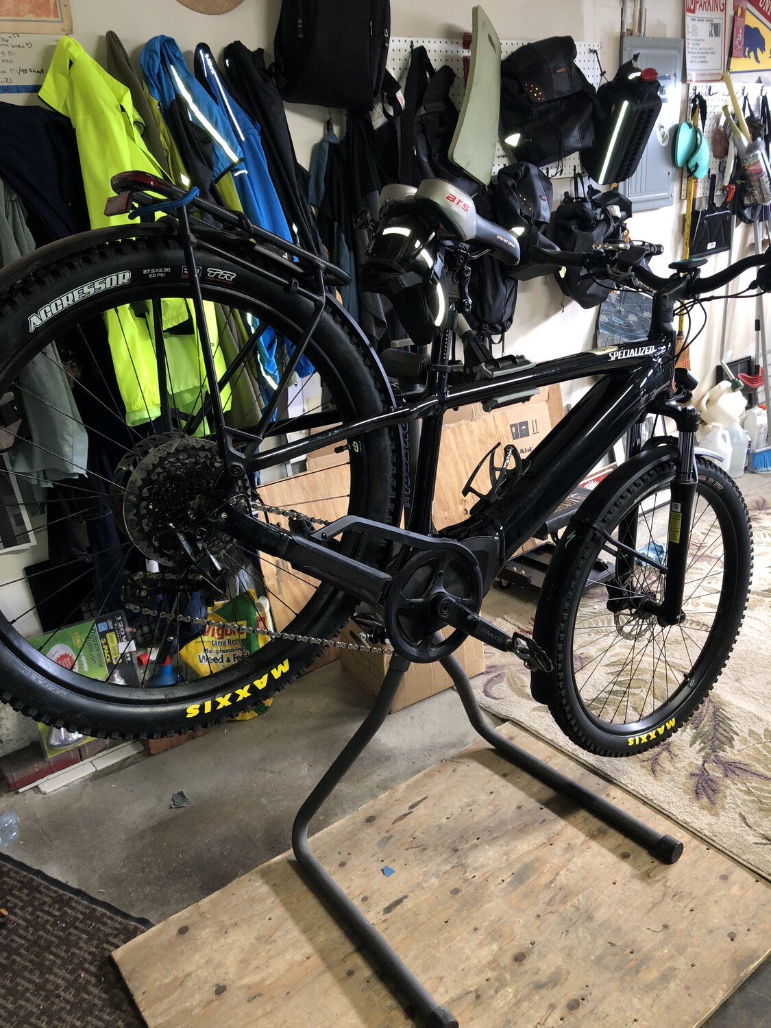

I have a 2022 Turbo Vado 4.0. I installed a Maxxis Minion DHF Maxx Terra EXO (it's a mouthful) 27.4 x 2.3 for my front tire, and a Maxxis Aggressor 27.5 x 2.3 EXO on the rear tire. It was hard getting the OE tires off, the bead refused to release but after some hot water and much pressure from my thumbs, I was able to remove the OE tires and install the much grippier Maxxis. I did the same with my wife's Turbo Como 2 years ago. Absolutely no issues with fender clearance. We ride alot of rough gravel double track as well as hilly rutted dusty California style fire roads: alot of short burst climbing, short but quick rutty downhills and some sweeping double track style "switchbacks". The Vado does just fine. The SRAM 11 speed is great for quick bursts burst up steep climbs and the 70nm of torque is just right. The Maxxis tires are like night and day when it comes to handling these types of trails and varied surfaces: we can power through deep gravel and small rocks with inspired confidence. I replaced the original suspension seatpost on my Vado with a Cane Creek Thudbuster ST and the stock 80mm travel Suntour Mobie works fine. Not as plush as my old Rock Shox and Fox air forks, but it takes enough off the stutter bumps and 2 inch ruts with ease. My wife's Turbo Como rides with a French built Baramind BAM City suspension handlebar and it weirdly enough works great on light trail chatter and bumps. Her Como also has the Thudbuster installed as well as the Maxxis tires, and the Como also does fine off road. I used to cross-country mountain bike somewhat extensively in the late 80's and 90's and I still once in a blue moon, rock my 1994 custom Klein Fervor and 1996 Klein Mantra Comp, which are presently considered "vintage". I am in my mid 60's now and remain relatively fit, but my single track x-country mountain bike days are way behind me. The Maxxis tires make my Vado 4.0 trail ready, at least for the types of trails I ride now and the fun and adventure once again can resume.
