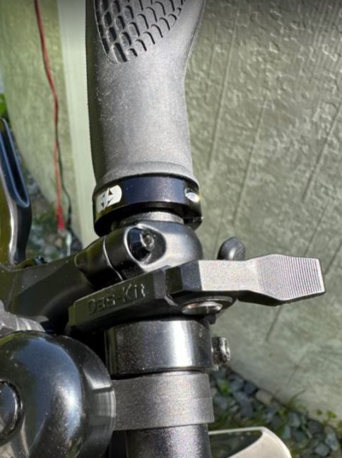

Has anyone found a throttle on handle that works with the T1000? My dealer says it doesn't work with what's on the market!

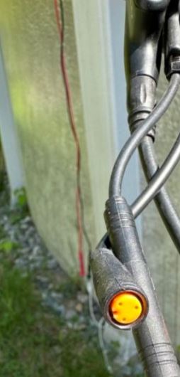

Show us the throttle and its connector, unplugged. Nobody is going to have a clue what your seller used but its most likely a reasonably standard throttle with a variation on the plug end.
This is the throttle and connector.

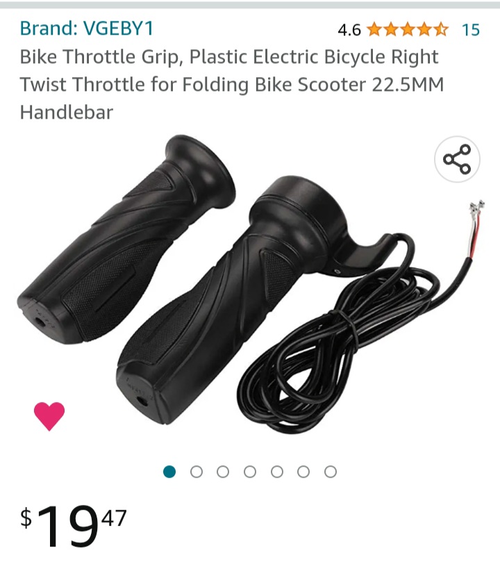

I managed to hook up this throttle to my T1000.
I cut the connector off the factory throttle and soldered the wires to it.
Bike Throttle Grip, Plastic Electric Bicycle Right Twist Throttle for Folding Bike Scooter 22.5MM Handlebar https://a.co/d/7uXLIP8
It worked, but it had the same problem as the factory "quick" throttle.
It was essentially just an on off switch. The slightest engagement of the throttle and the bike went to full power.

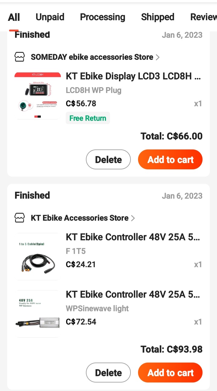

This is what I bought,..
As well as a thumb throttle for about ten bucks, or a twist throttle for about $30.
The original cadence sensor can be reused and I think the wires are long enough to reach into the KT controller?
(I didn't hook up my cadence sensor. I refuse to pedal unless I have to. 😂)
(Those are Canadian dollars, so about ten bucks USD. 😂)
I didn't get the best deal on the controller.
I thought I was buying an ORIGINAL KT controller from Kunteng, but that wasn't the case.
There were other KT controllers that cost ~$63, and included the 1-5 cable.

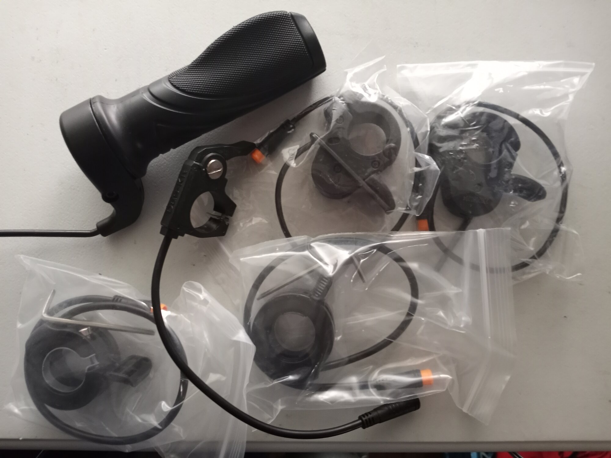

This is my collection of throttles,..
Well over $100 worth.
