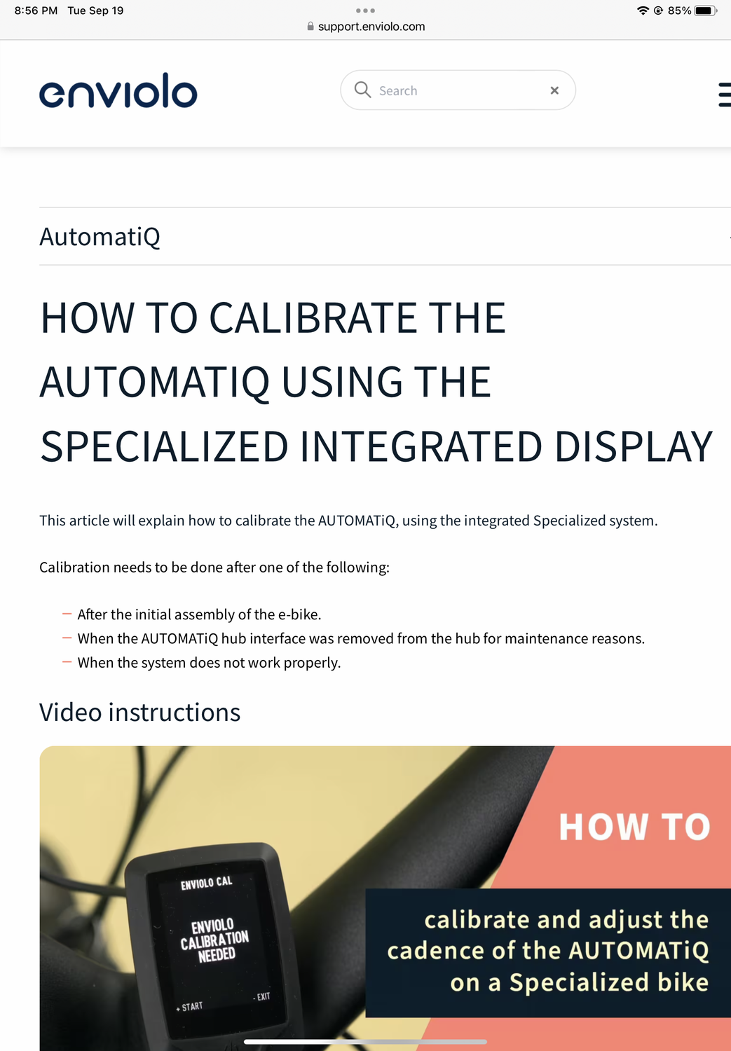

I'm not sure if you have other sources, but I read that it should be calibrated twice a year, whenever wheel is removed, "repaired", etc. Documentation is open enough that I wouldn't exclude tension adjustments.
Can you please point to where this documentation is located? Their website lists only 3 reasons calibration is required. I found nothing about twice a year or whenever the wheel is removed.
Are you trying to figure out when / why you should calibrate? There is not a lot of interesting detail on calibration. Basically they tell us how to do it, and then a few bullets with a common theme of calibrating whenever something changes.
Nuvinci (before they were enviolo)
"On the first set up or after system maintenance
or incorrect functionality the system has to be
calibrated."
Serial 1
"All Serial 1 eBikes are correctly calibrated during assembly. However, it is recommended to re-calibrate your hub after removing the back wheel and disconnecting the AHI (Automatic Hub Interface) or when updating the Enviolo hub software. "
Specialized Vado 5.0 IGH
"On the first setup or after system maintenance or incorrect functionality the system has to
be calibrated."
"We recommend calibrating twice a year and after a repair is conducted. Calibration can be easily done via our Veloretti app."
