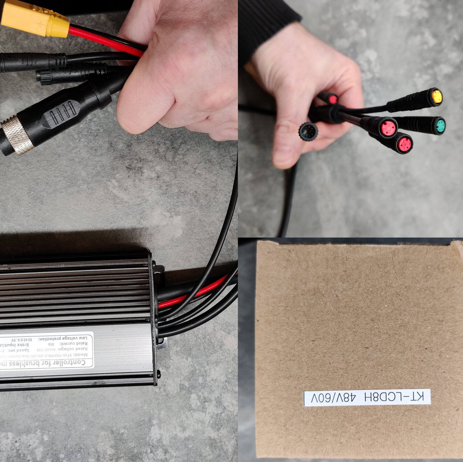

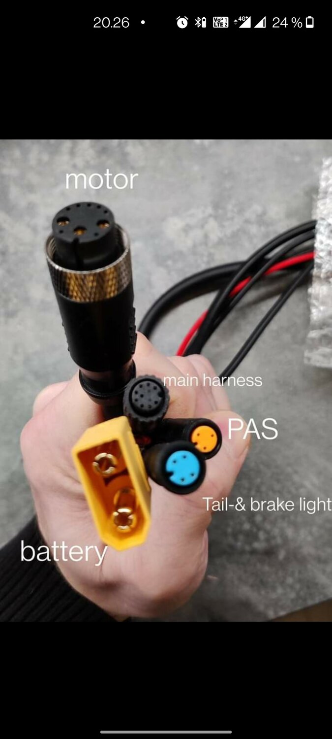

Hi. I sell these L10 40A controller kits for Rad fitted with G062.1000w motor. Most of them sold to USA, Canada and UK.
That's what I'm looking for.i seen your thread.tried email @outlook no response. any way I have juiced rip current S. Has 750 bafang burnt up motor. Replaced with Go62 1000 watt geared hub motor. Your kit includes lcd correct. Not worried about other connects .except battery xt90 or xt60.ps thanks for getting back.Don

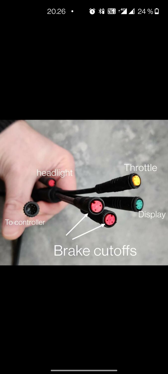

Kit includes controller+display+main harness.

Connect all good,will go to rad for throttle. Unless you sell. Display is what KT.
Display KT LCD8h 60v version (48v, 52v & 60v battery compatible just like the Controller).
I prefer Wuxing 130X throttle. Haven't got those to sell though.
Cool Will look that up. I have kt lcd 8h used with kt controller I bought this for first 750 upgrade . I have 52volt system.i run 2# 20amp/hr batterys.bms 50amp max.Continuous 40amp. how much is kit you sell shipping included . I will by throttle separate
Just checked lcd display will match your controller and Amazon has the throttle that is compatible.would you sell controller only or just whole kit with LCD display. Thanks for all your help much appreciated.Don
I would like to purchase the whole kit. That way I have back up lcd.
