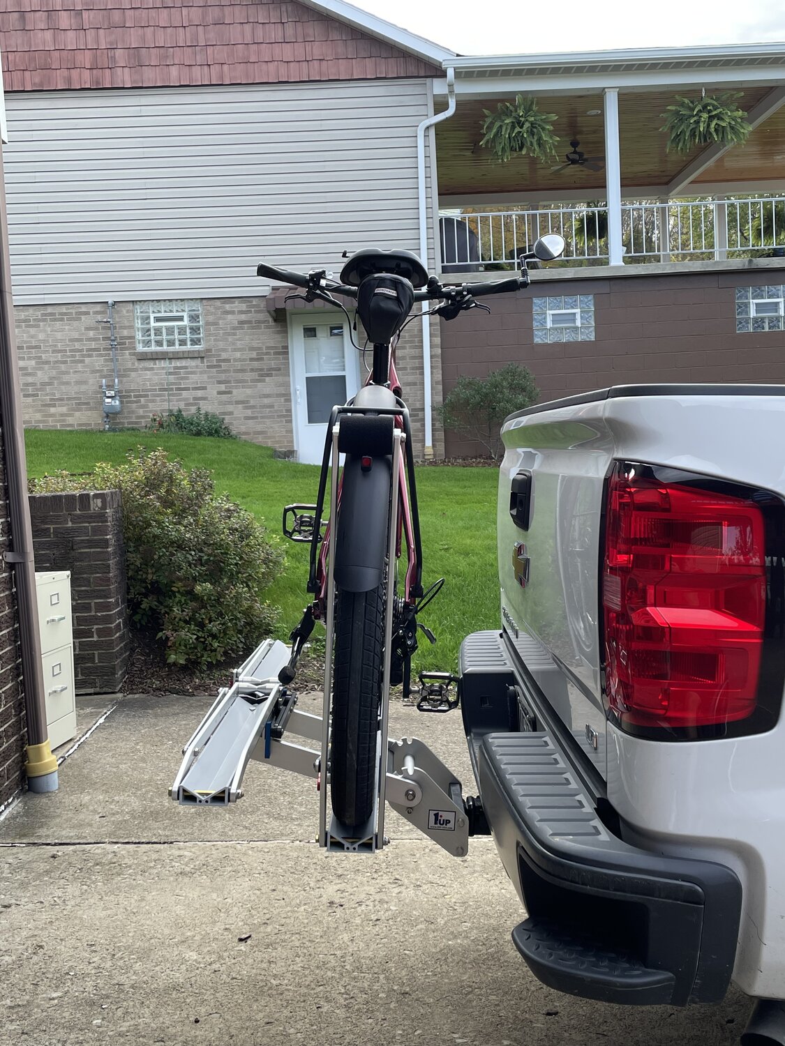

Very happy with 1 UP racks.
Here is the one I have coming, you can also get this same carrying rack in alum,
and is also in a 2 bike version if needed.
I went with steel that way I can change anything that needs to be changed,
as I have a welder.

That 1UP rack looks very good and it appears that would work very well for a Trek Allant 7 with fenders. I do not want to remove the fenders nor do I want to have a clamp dent them. Seems the 1UP tire support ‘clamp’ attaches in front of the tire fenders.

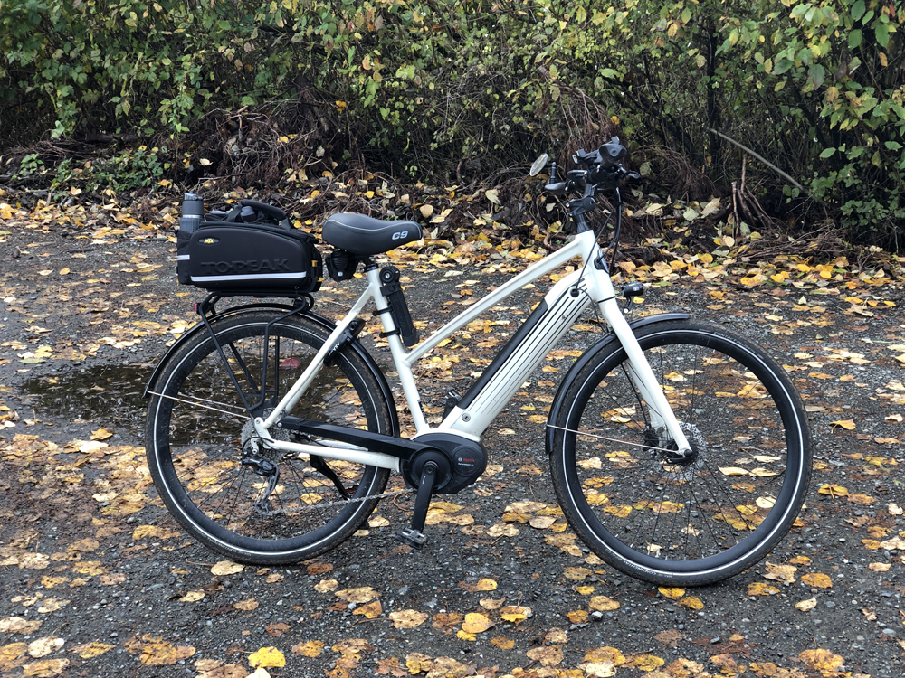

I have the 1Up with the fender guard and use it with my Gazelle which has fenders. Never had an issue . Also, if you're close to the border have it shipped to the US and pick it up. Shipping is much cheaper and you'd avoid the horrendous brokerage fee that the courier charges.

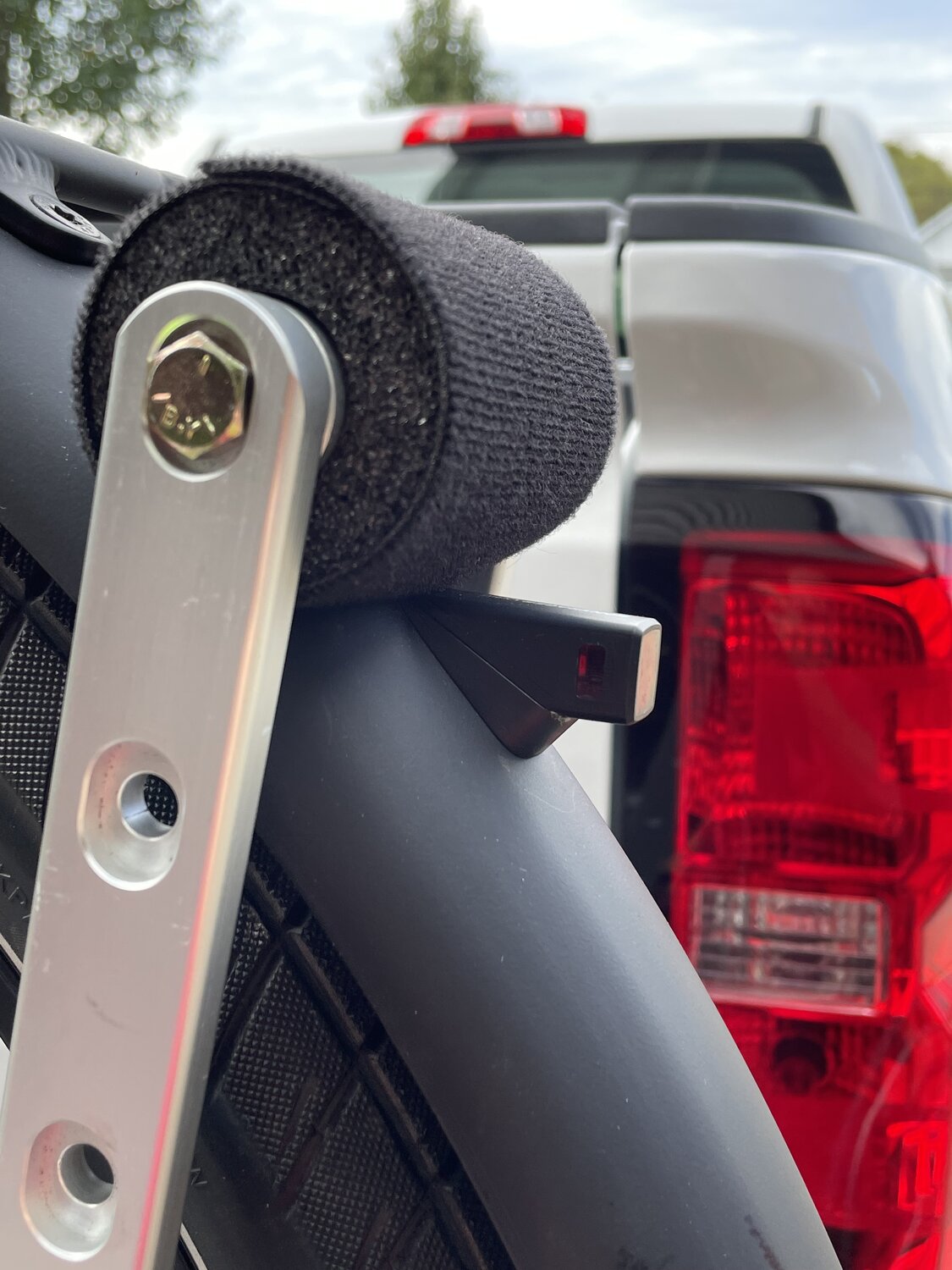

If you use the fender guard there is no problem using this rack with fenders. BTW you can also make a fender guard from a pool noodle..........

No issue so far. I do use the fender cushion they sell. You can also use velcro around the rear tire if you drive on bumpy roads.
Hi,
Thanks! Does that fender cushion prevent the fender from being dented? It looks like the fender would be pushed into the tire, thereby creating a possible dent in the fender.
