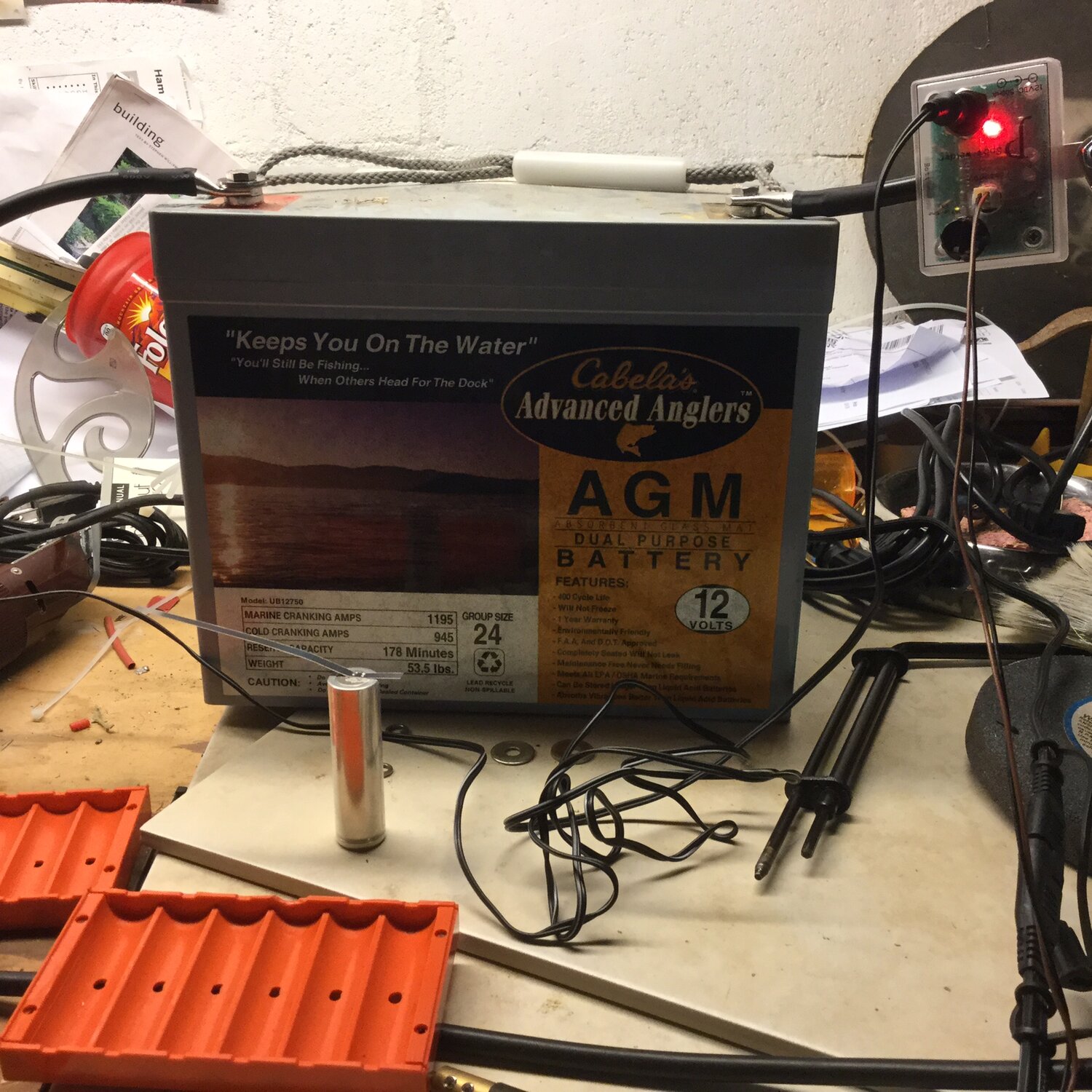

There are MANY pitfalls as well as expenses. By the time all the pieces, parts, and tools are assembled it WILL be cheaper to buy a new battery.
I wish the OP would provide more details and pictures. Especially who made the battery or who was the seller. How long ago was it purchased? What was the claimed warranty?
There are cheap welders but the failure rate is high. Remember these batteries put out 15-30AMPS. If you've ever seen one arc and the fireworks, well sensible owners will walk away from that adventure.
Sadly the low resolution pictures make reading the cell versions impossible to read.
