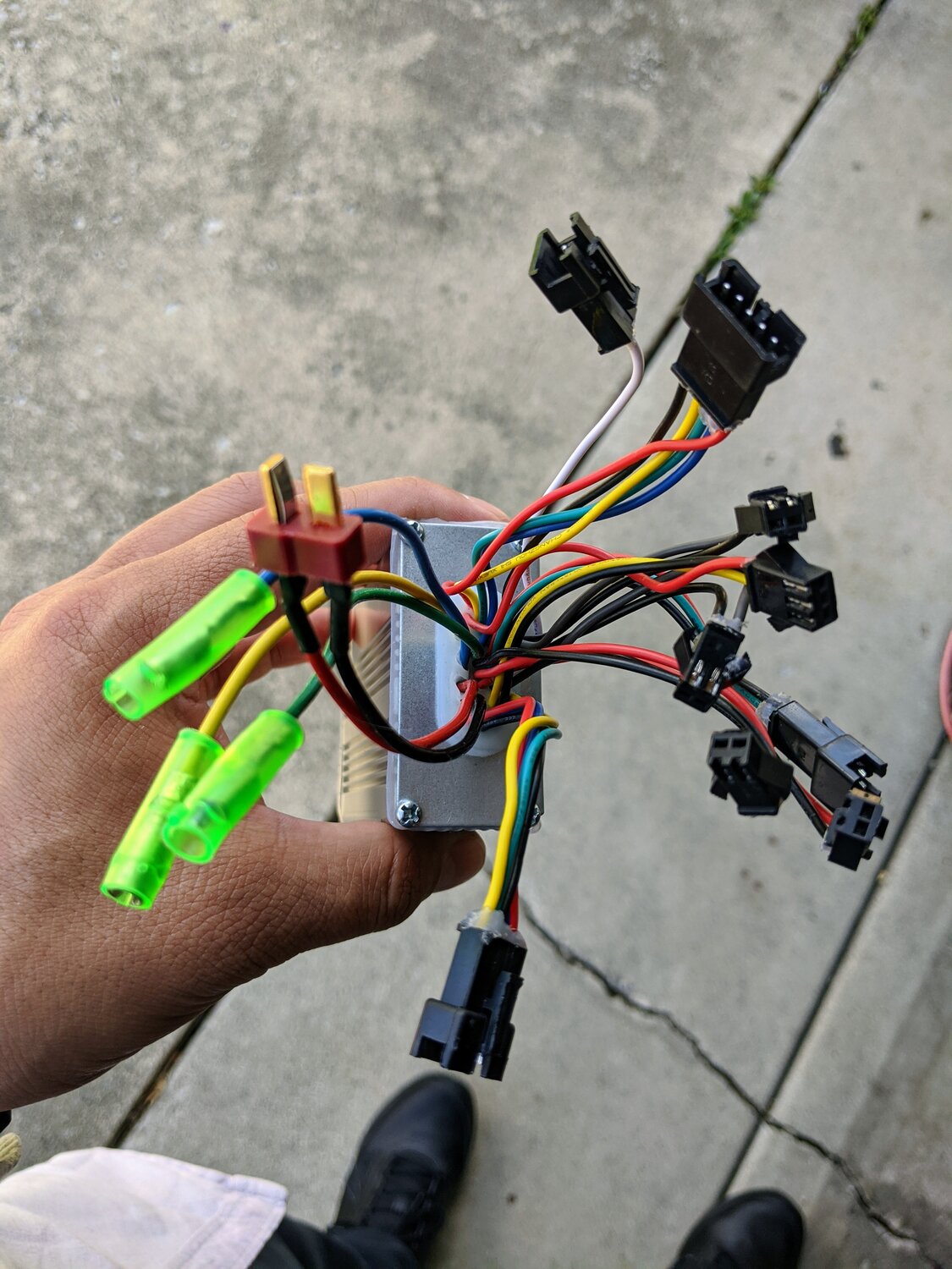

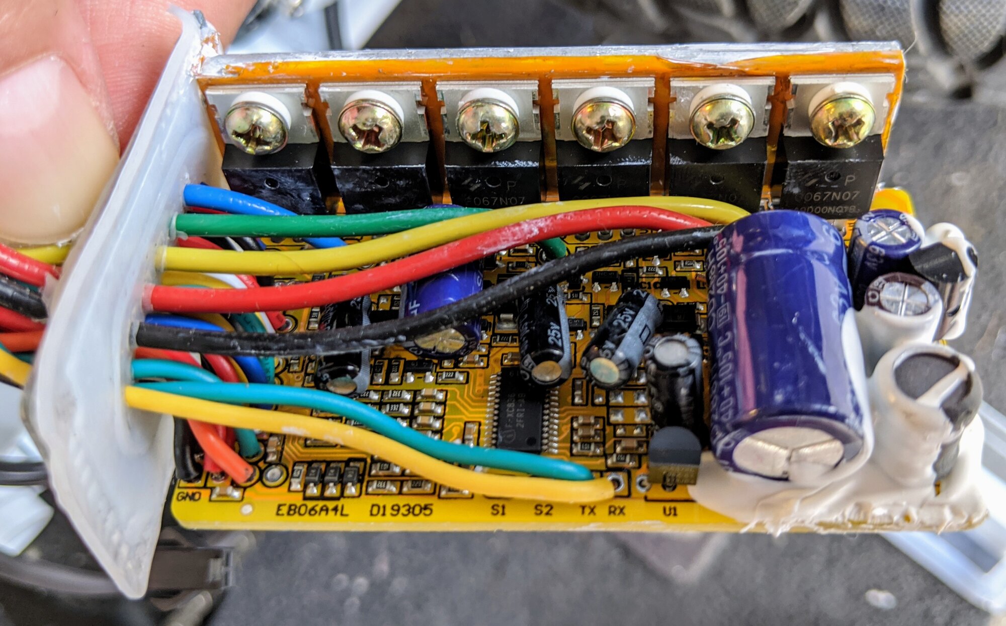

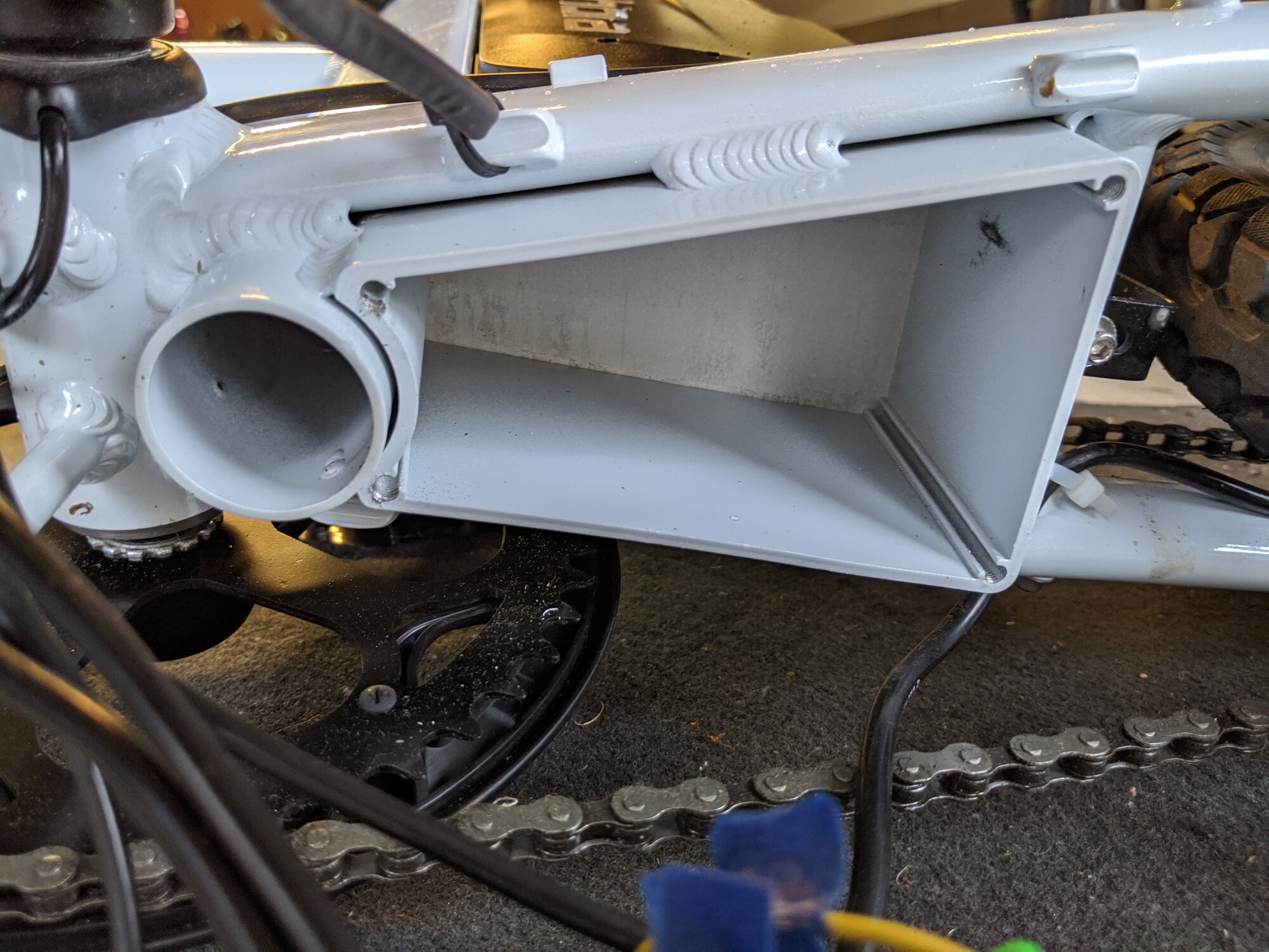

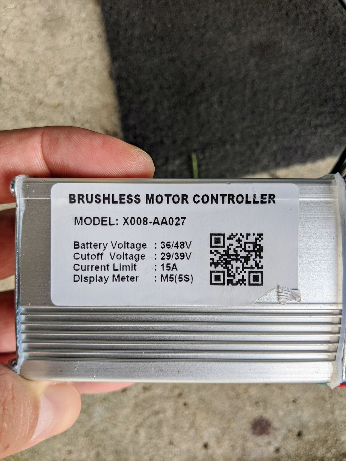

I finally got a chance to check out the controller in my X3. Two things that stood out about the stock controller are that you can use either a 36V or 48V battery and it has an unused connector for a wired rear taillight. Nice!
The controller fits in the frame enclosure with just enough room for the wires and connectors. Unfortunately the connectors are not the waterproof kind so that may be something to upgrade to in the future. I recommend using Loctite on the bolts that fasten the cover to the frame as mine were almost loose.

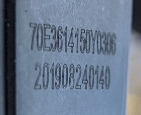

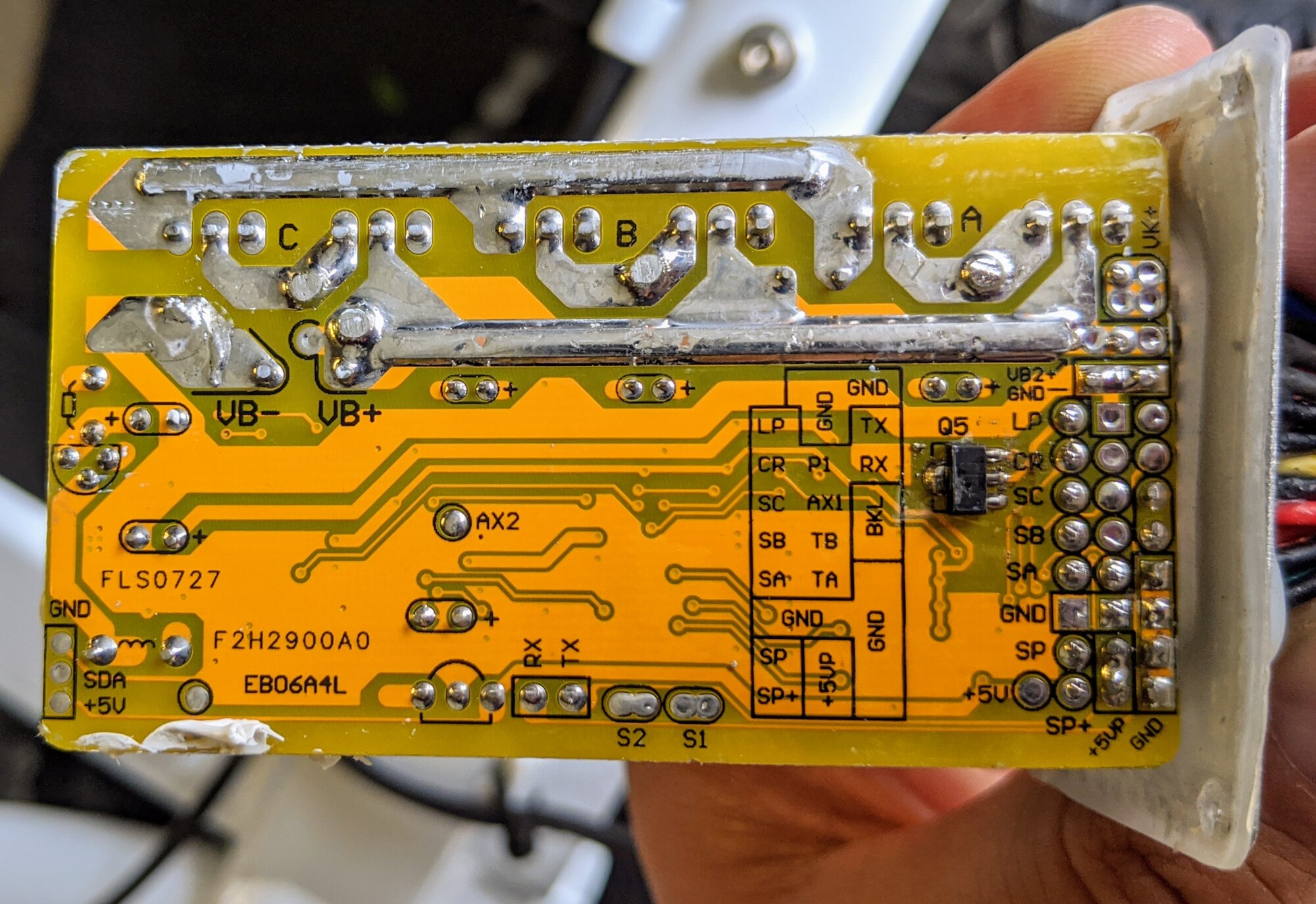

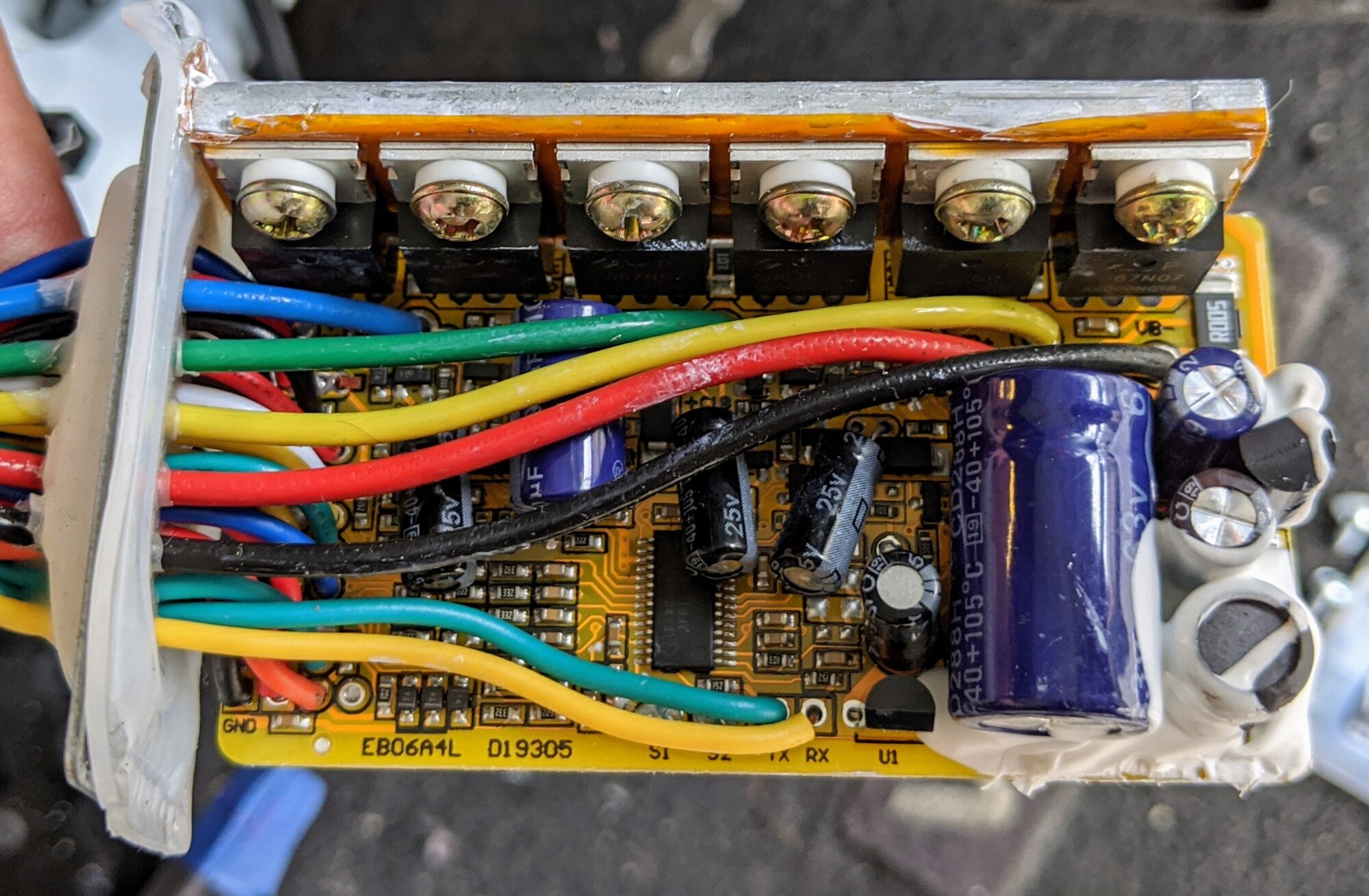

The controller components are housed in a very small aluminum box (I forgot to measure the dimensions), it uses 6 MOSFETs which are bolted to the housing for cooling and it has one large 63V capacitor. Current limit is 15A, and a 36V or 48V battery is compatible. You can access this setting within the LCD. Cutoff voltage is 29V and 39V respectively. Interestingly the sticker states it's also compatible with a M5 (5S) LCD. Fun fact, my Lectric XP uses an M5 LCD so I may decide to test that out.
When I scanned the QR code it came back as "eb06a/x008-aa027/36/48v/15a/pas3s/190903005". I'm going to search for the controller part number in hopes of finding more information.

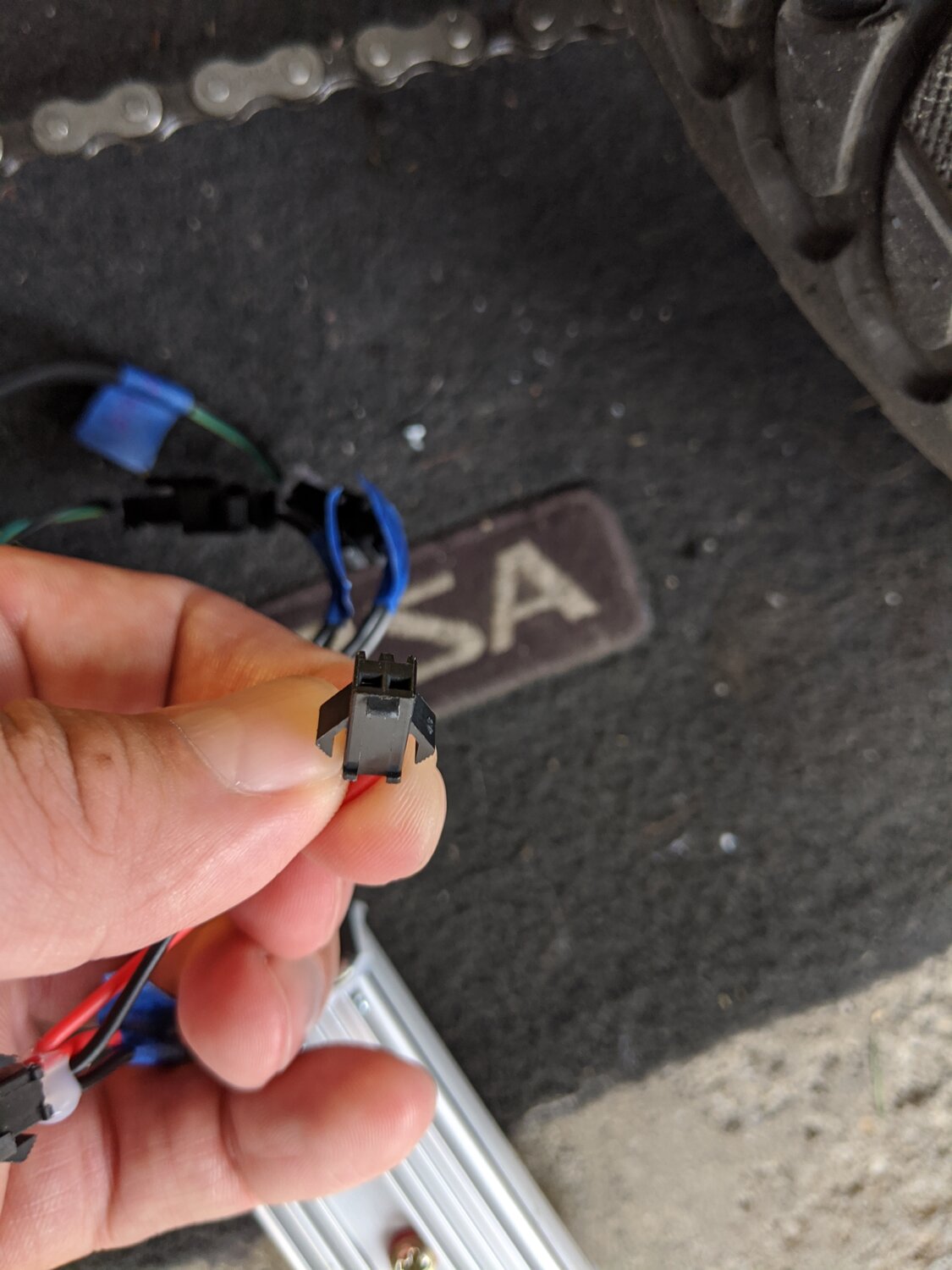

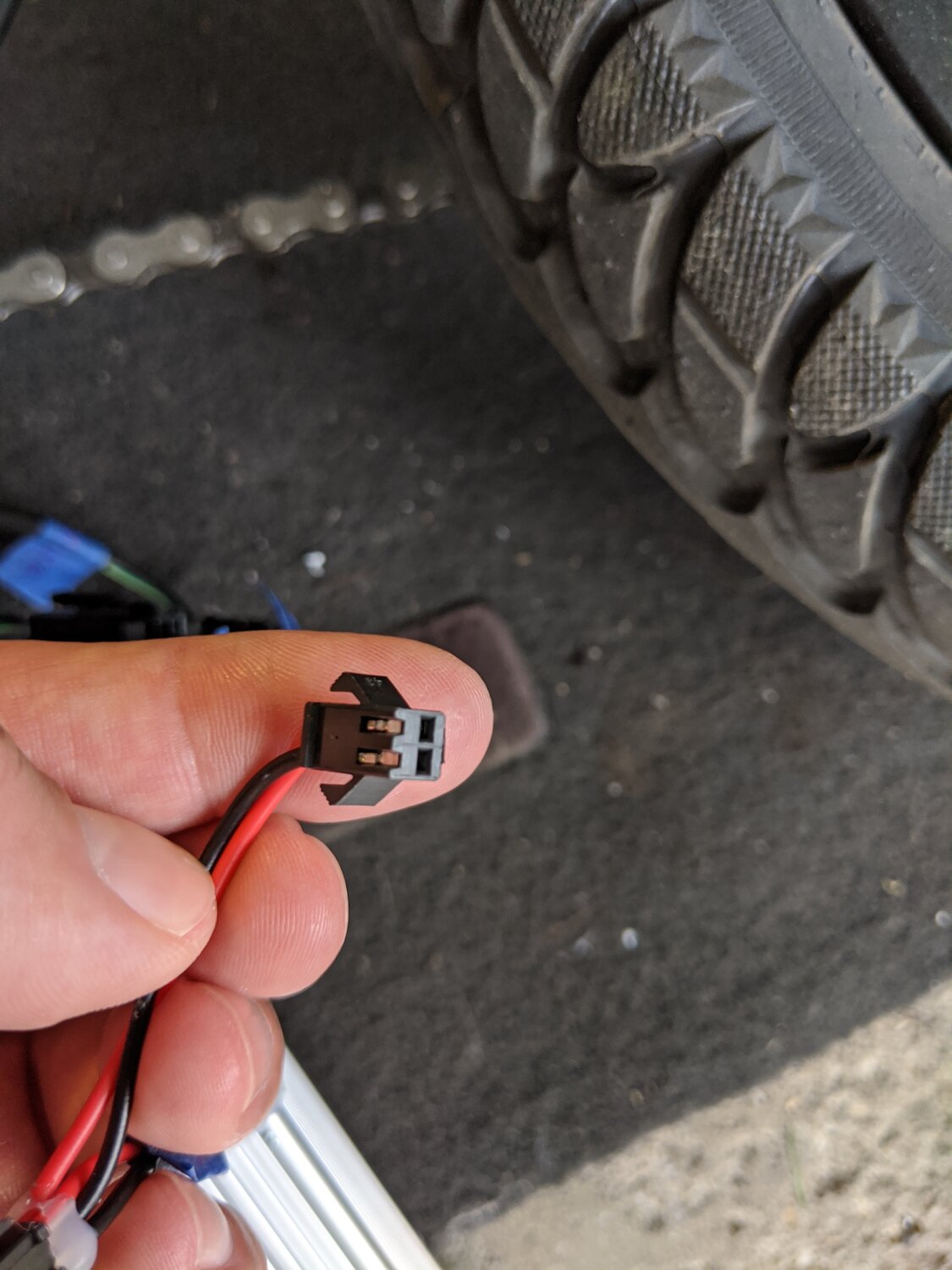

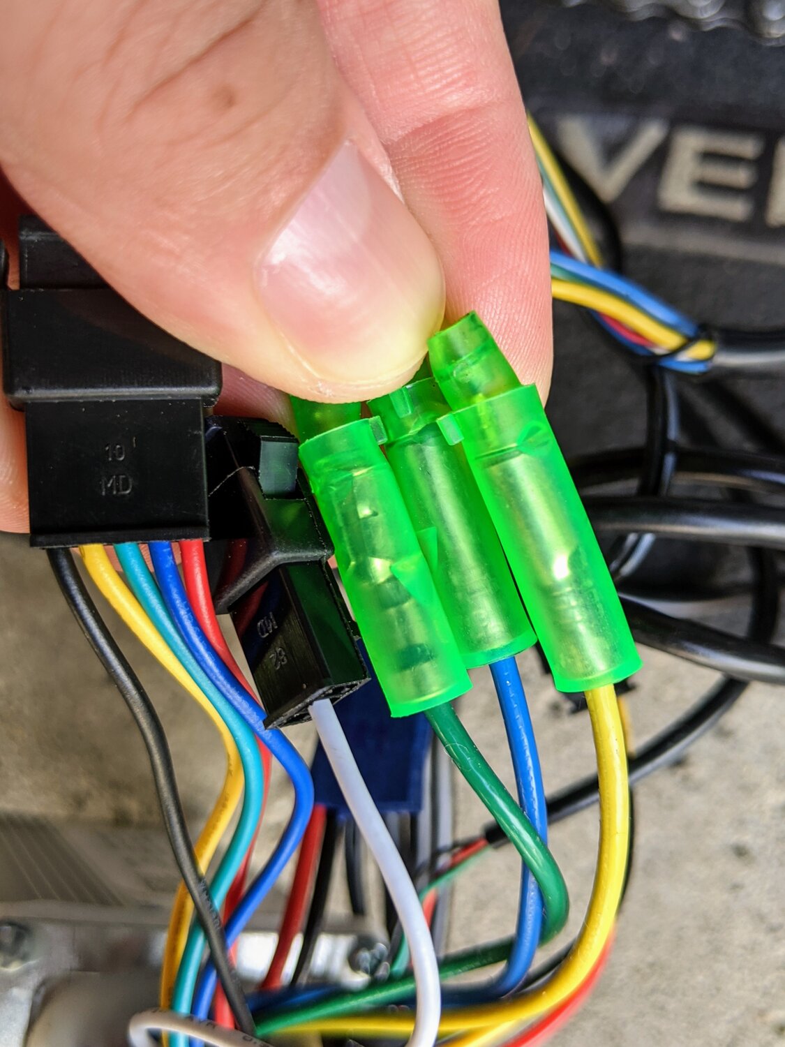

As I mentioned before the connectors are not weatherproof but they do look like standard controller connectors. The motor is connected to the controller via 9 wires (5 wire connector, 1 wire connector, and 3 single wire bullet connectors).

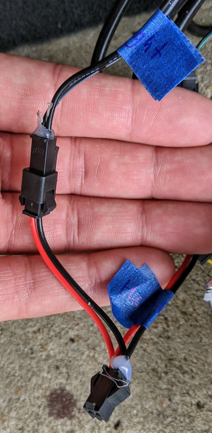

The controller has two 2-wire connectors for wired lights, a headlight and a taillight. I'm going to look into wiring in a taillight.
I didn't take pictures of the other connectors but do remember what they look like if anyone has any questions.
  • The LCD uses a 5 wire connector
  • The thumb throttle uses a 3 wire connector
  • The brake levers each use 2 wire connectors
  • The PAS/cadence sensor uses a 3 wire connector
  • The battery holster uses a 2 wire T connector
I'd like to find out what the make and model of the LCD is as well as finding instructions on the settings menu. Luckily it appears to be a very basic display with only three menu options.
  • Setting 1 (36/48) changes the voltage from 36V or 48V. Default is 36.
  • Setting 2 (07-30) changes the wheel diameter which affects the displayed speed output. Default is 14.
  • Setting 3 (07-25) I'm not entirely sure what it changes but I think it has to do with motor response. Default is 22.

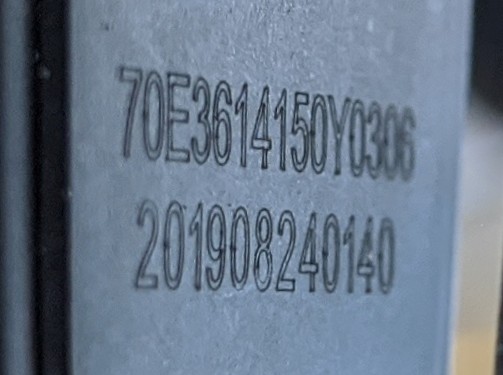

Motor part number, 48v stock! I plan on getting a 48v battery soon. Only other thing to do is switch the controller from 36v to 48v and test drive. I'm hoping for a top speed beyond 20mph.
JB-14" 48V350W20190903959N

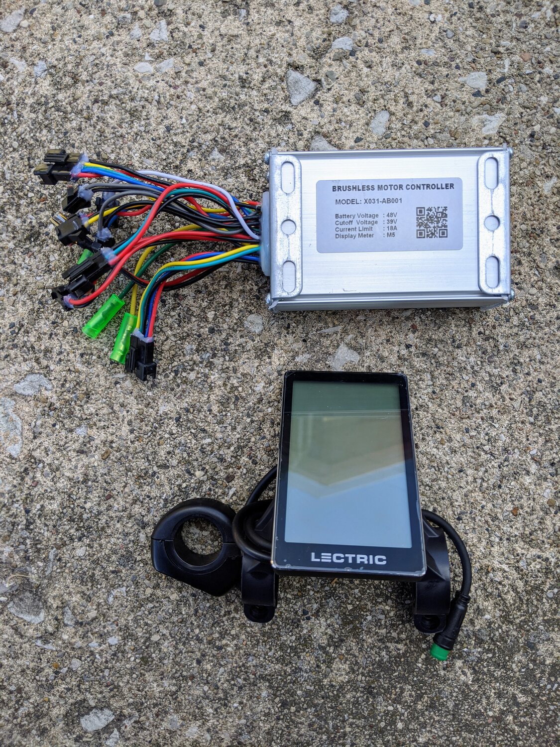

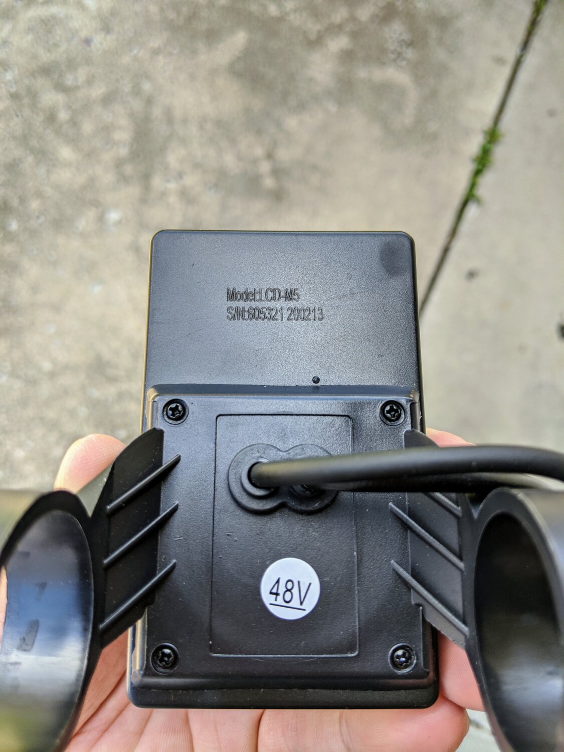

I couldn't help but notice how my Eahora X3 controller looks like my Lectric XP controller. The QR code, the font, and the format of the wording all look very much alike. I was told that Eahora's and Lectric's ebikes are produced in the same factory so this sort of confirms this I suppose.
X3
XP
Anyways, for fun I'd like to test out the XP controller on my X3. The XP controller provides an extra 3 amps for the Current Limit and bumps up the voltage to 48v (X3 controller can also do 48v). I'm still shopping for a proper fitting 48v battery for the X3. I may test on a workbench with my 48v XP battery.
The great thing about these two controllers is that all the respective connectors are compatible so a controller swap is just a matter of plug and play. Everything from the T plug battery connector to the 5-pin display connector are the same.
X3 motor connectors and wires (9)
XP motor connectors and wires (9)
I also plan on using the M5 display supplied with the XP controller. If everything works as planned, I even expect the cruise control to function. I love and use cruise control all the time so this would be an awesome feature to have on my X3!

The LCD is a Yolin brand, specifically the YL-70
I tried my old XP M5 display on the X3 controller. It did not work as expected. It flicker once and looked weird which I think is due to this being labeled a 48v display and me using the 36v battery. I got an error code and switching PAS 1-5 did nothing. Strangely the throttle still worked but the response was slow/dull and hesitant like it went into limp mode and couldn't achieve full power. Next, I'll try the M5 display with the XP controller with a 48v battery as that *should* work.

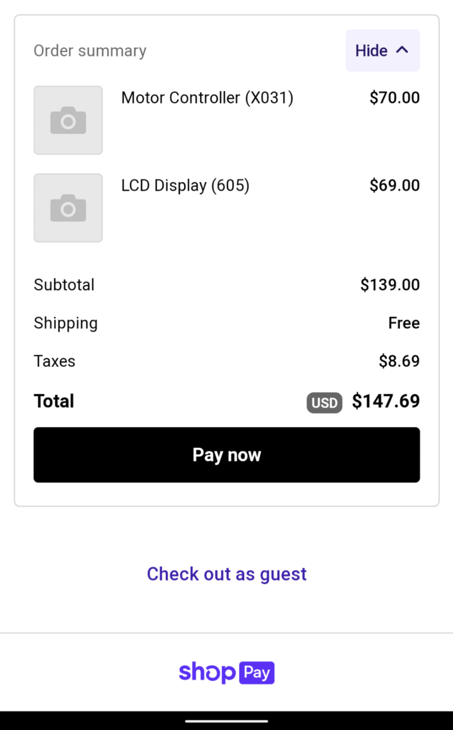

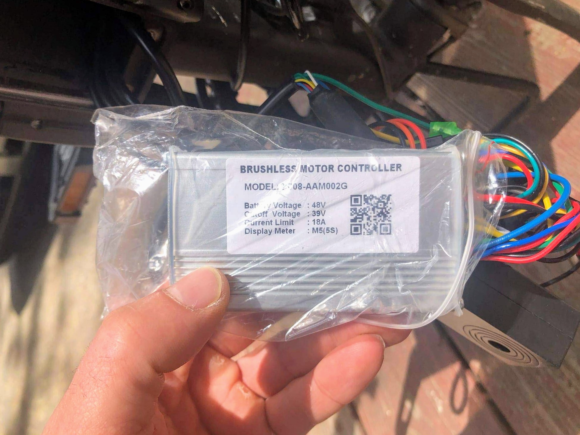

I went ahead and ordered a spare XP controller and LCD to test with.
My parts arrived shortly thereafter. All the connectors plugged in.

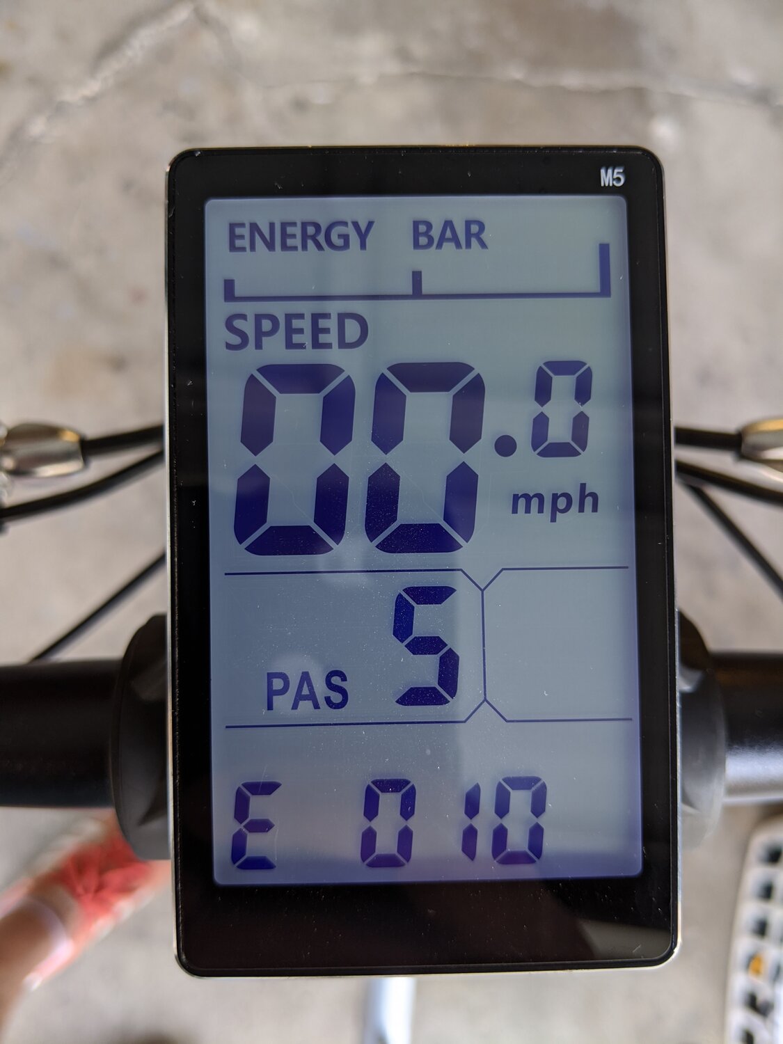

However everything came to a halt there. Even though I connected the XP controller and display correctly I kept getting this E010 error. The motor would not respond to throttle input and changing the PAS level did nothing. I also tried messing around with the settings but everything I tried did nothing. I also tried both 36V and 48V batteries, nope.
Too bad it didn't work, I was really hoping it would've worked. I may try tracing the wires at a later date but for now I'm burned out and bummed out about the XP controller and LCD not working.

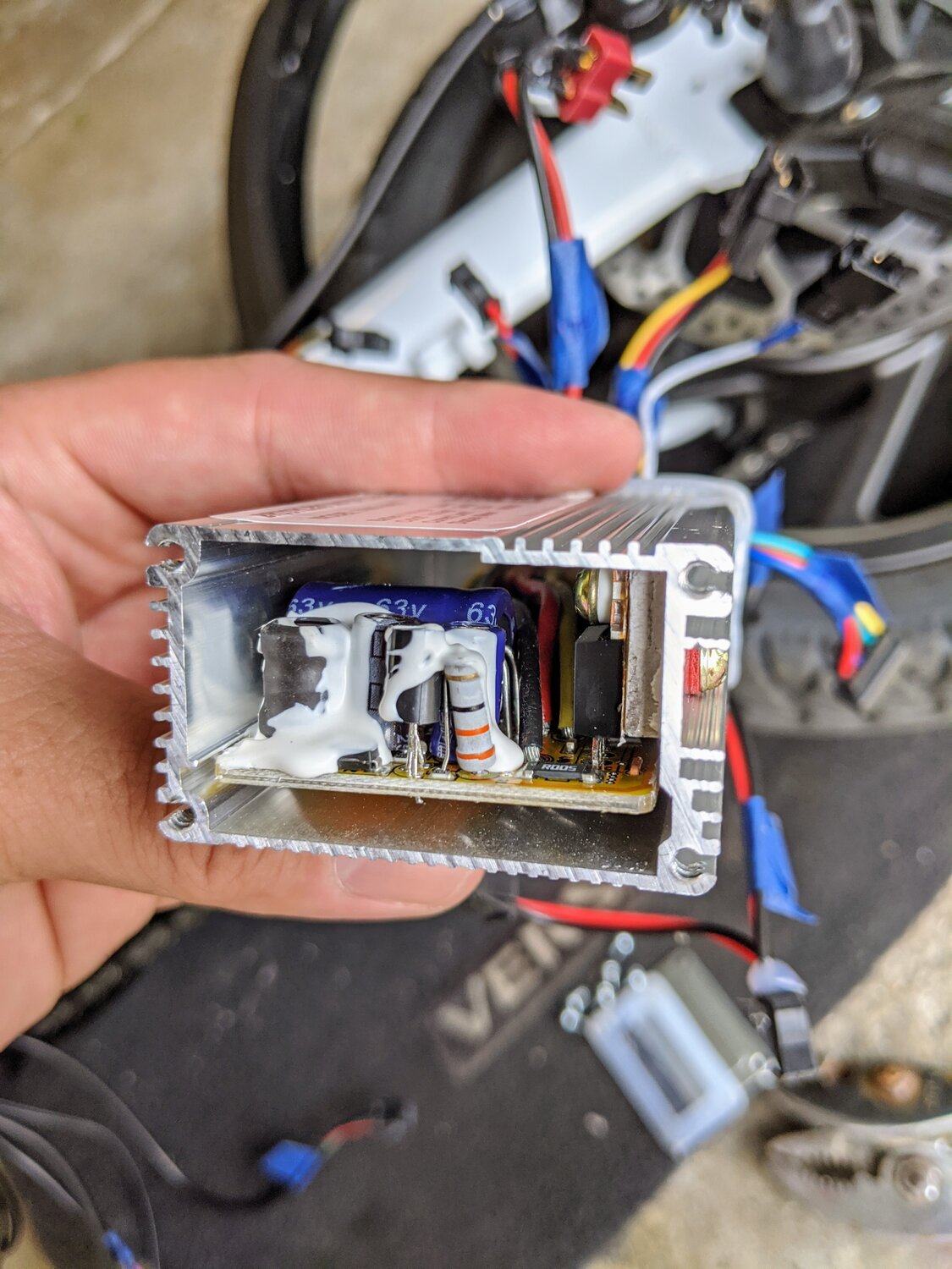

Someone from the Eahora X7 Facebook page posted a picture of the X7 controller, I'm going to see if I can get my hands on one of these for testing. I'm curious because for the Display Meter it says the same thing as my X3, "M5(5S)". 🤔
Well let me know how your testing goes, and if Eahora will sell you another controller.. I don't really have the means to do that myself.. yet again, I will have to give it up to RadPower bikes and their customer support.. I was able to score a 2018 RadWagon on Facebook marketplace for $400. The sellers thought that they killed the battery, but in reality the LCD panel was waterlogged and it would not turn on the bike.. I attached another LCD I had on my rad runner bike and voila it works perfect.. I contacted rad for a replacement LCD, so all when I only spent $500 for a $1,500 bike
