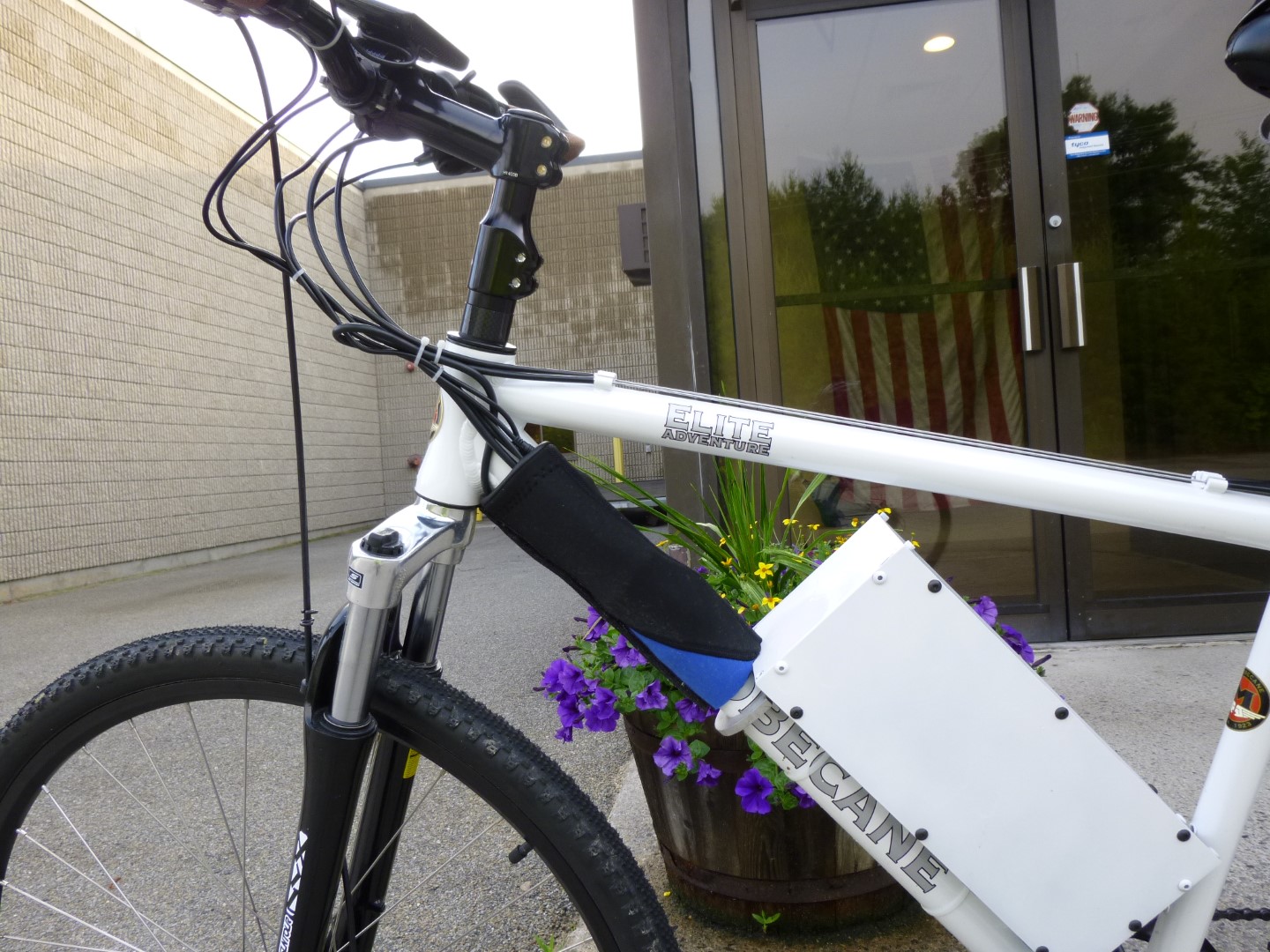

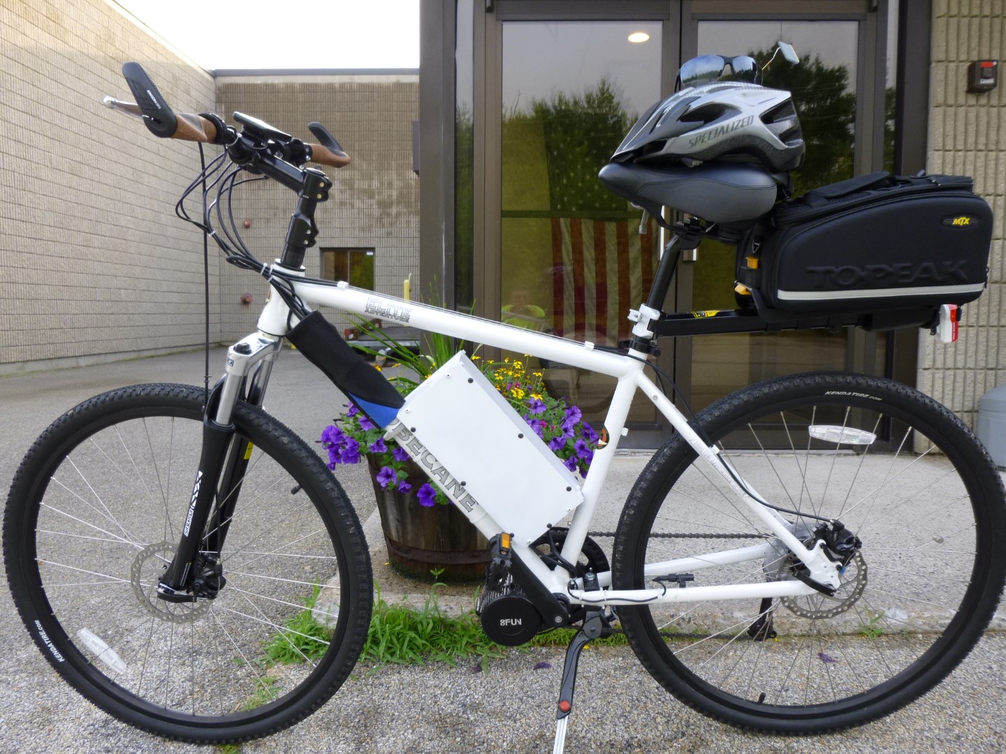

OK....I've had plenty of time and hills to get used to the Bafang Mid-Drive. My overall impression, had I built this bike 1st I would not have bought the Neo Carbon. Don't misinterpret, I really like the Carbon, it's polished works as advertised and is a very good bike. But........
  1. the 36V 15AH battery is amazing. I rode a 22 mile loop with my wife on the Cross, I'm on the E-Motobecane. Lots of hills. She rides in Standard setting, I'm in the mid range output of the motor. When we get home she's lost 2 bars on her indicator, I've still got 5, didn't lose any. Ridden the bike 3 times commuting to work (28 miles) same story. Bottom line, I doubt I'd consider a bike with less than 12 AH in the future.
  2. Once I figured out how to set up the controller riding was a piece of cake. Basically the PAS levels limit your top speed proportionally. I initially thought I'd need more then the 3 settings set at the factory, but after increasing the settings to 5 PAS levels I realized that all it did was constrain the range per setting. So...the way to set this controller (IMO) is to first set the top speed. I set the top speed (motor cut-out) at a speed that I'd push, but not my cruise speed. At the highest assist level this is the speed the motor will cut-out at; for me that's PAS 3. At PAS 2 the motor will assist up to about 80% of the top setting, this is my "cruise" setting. By adjusting the top speed you can find the gear and cruise speed that works. Once I figured this out, I found I could ride the bike indefinitely in PAS 2 "cruise". Haven't found the battery limit, in this configuration but I'm pretty confident it's north of 50 miles.
  3. I've read a lot about the crank drive versus hub and the wear and tear on components...??????? OK, here's the simple solution, the left hand brake is adjusted so the braking action begins at the mid-point of the handle pull. The electric switch that disengages the motor (instantly) is engaged almost immediately when you start to brake...you can feel the motor turn off. So I just use the left brake as a clutch of sorts. When I want to shift gears, I clutch, shift while pedaling, release clutch. I've gotten so use to it that it's very natural and works flawlessly. No stress on the gears or chain.
  4. How quiet is the motor? I can't even hear it. The only way I know it's running is the torque and acceleration. The Neo Carbon hub motor makes a slight whirring noise, or hum. The Bafang Mid Drive is essentially silent.
  5. Torque versus PAS. Now that I've had a chance to ride both I have no strong opinion about which is better. The PAS seems more predictable and positive; pedal and Ye shall receive power. I'm assuming based on cost the torque sensor is more expensive. So for me PAS sensors are fine.
I like both bikes and ride them both. Best part of the deal, since we have three E-Bikes we can invite a friend to ride. Next project. E-Tandem...I have the 750W 48V unit and I think a tandem is in order. Looking for a suitable Cannodale or Trek bike. I CAN'T WAIT!!!
Bottom line...for less than $2,000 and some time you can have an incredible Mid Drive bike with a very large battery capacity.

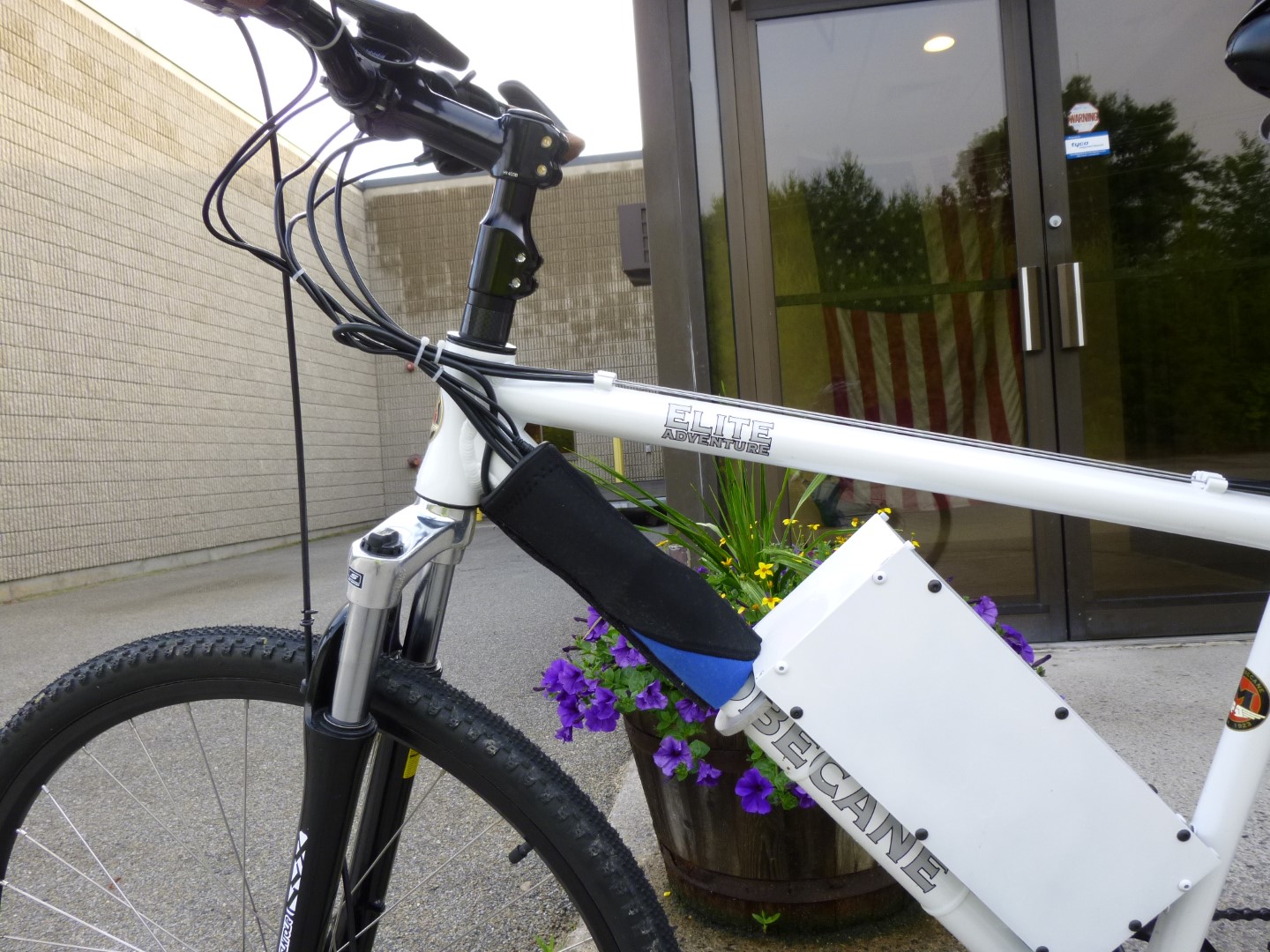

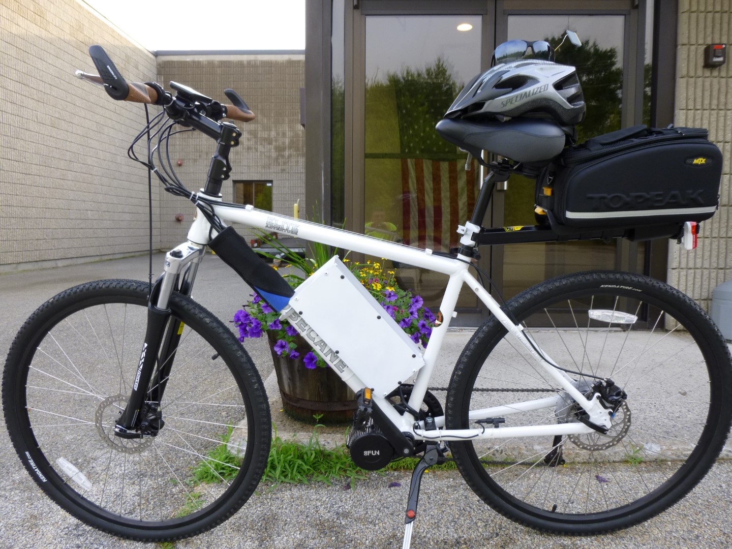

View attachment 1394 View attachment 1395 View attachment 1396
