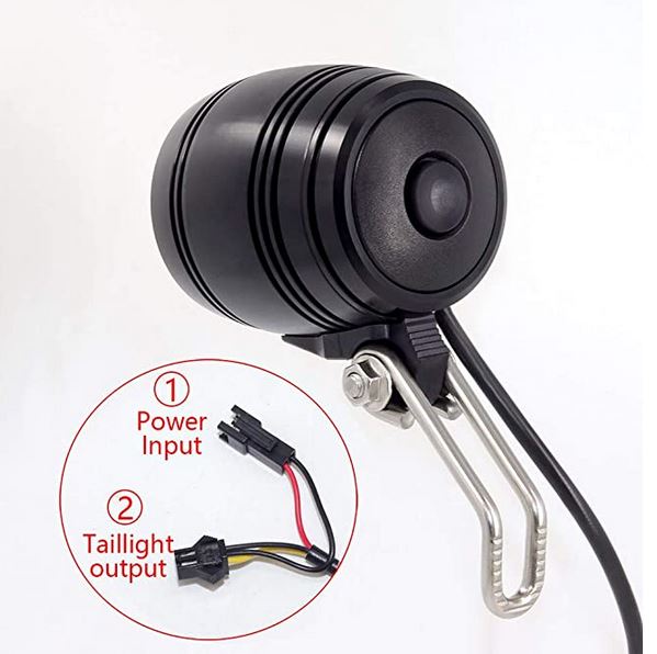

For safety, especially on narrow 2-way bike paths, it's a must to have at least a front light. The particular one I purchased had a dongle for attaching a tail light as well, which I did. The connector for the headlight did not match the connector for a light on my controller--so what, you just clip the connectors and attach the wires directly.
