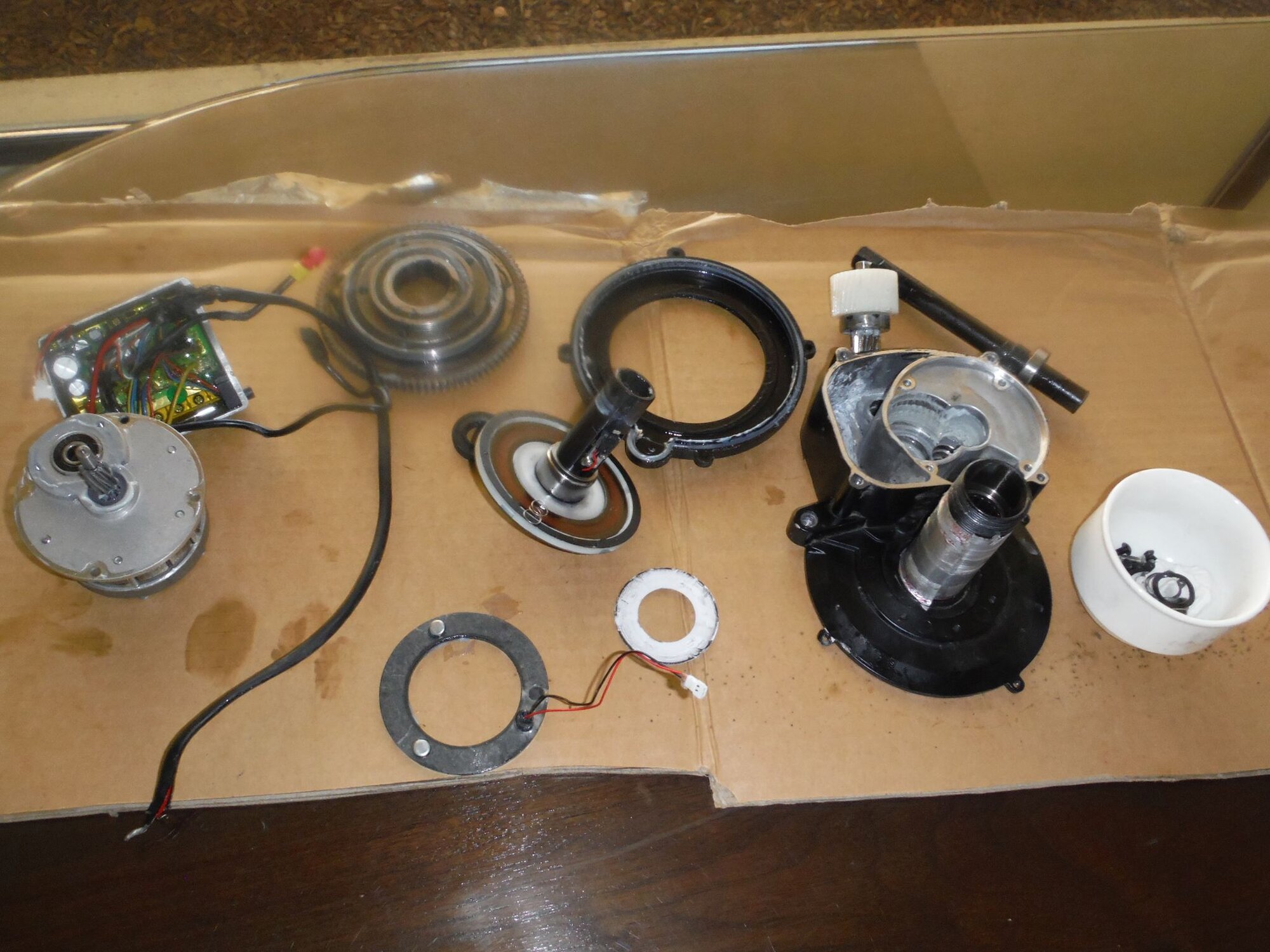

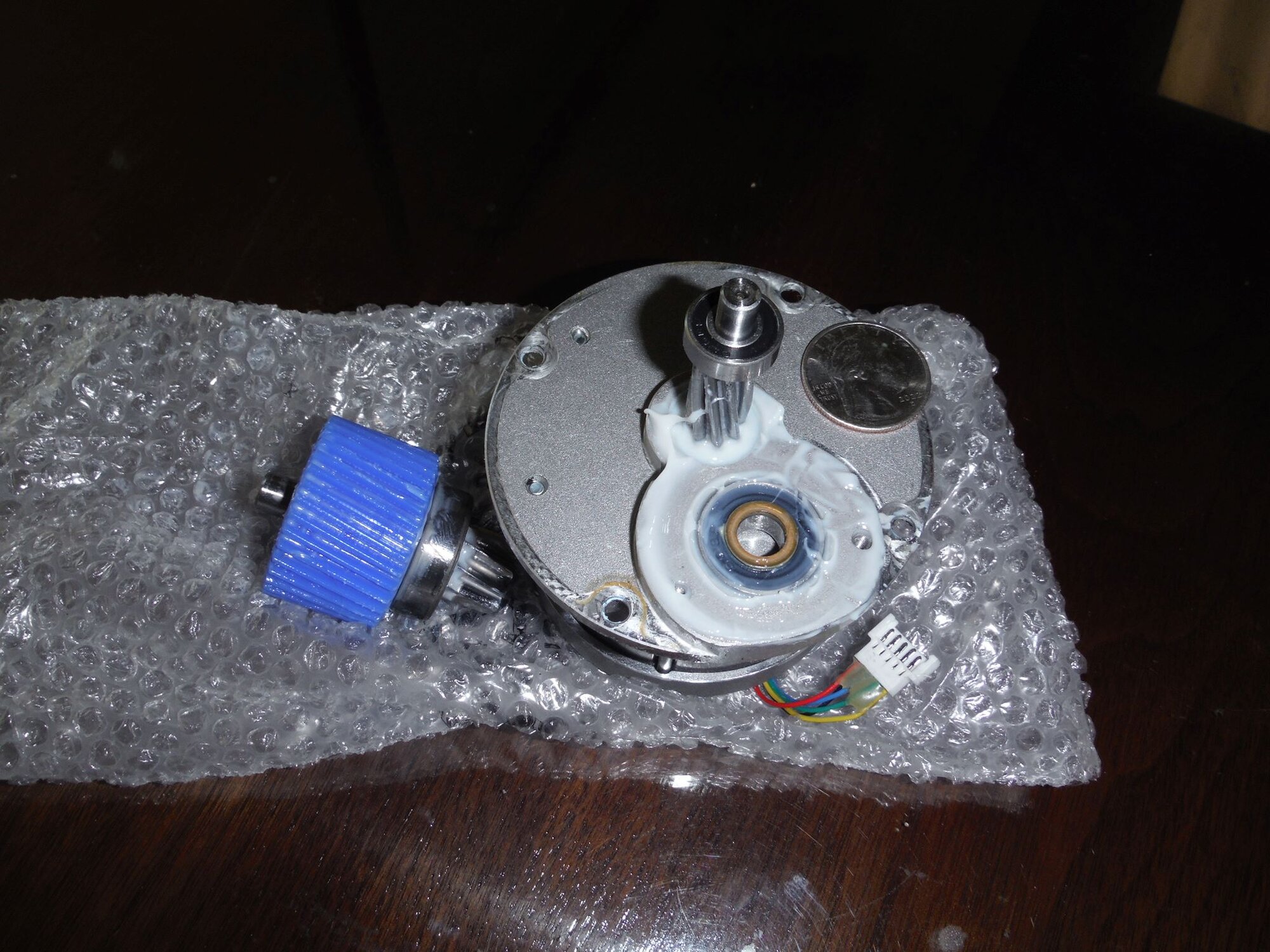

I had something similar to this two days ago. It was the needle bearings inside a nylon step-down 'blue' gear. I replaced all the bearings in the motor and repacked the grease including the main gear. Now it is super quiet and smooth. I also replaced the $65 bare motor while it was open. Why not? On rereading OP it could be a broken tooth on the main gear at top-dead-center. Is it still under warranty?

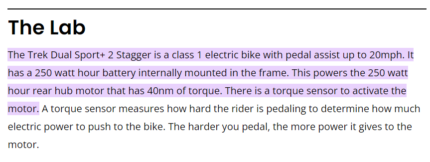

Good point, but I did try it with the motor off and felt the same effect. I will experiment more to try and narrow it down.. And actually this bike has a torque sensor.
