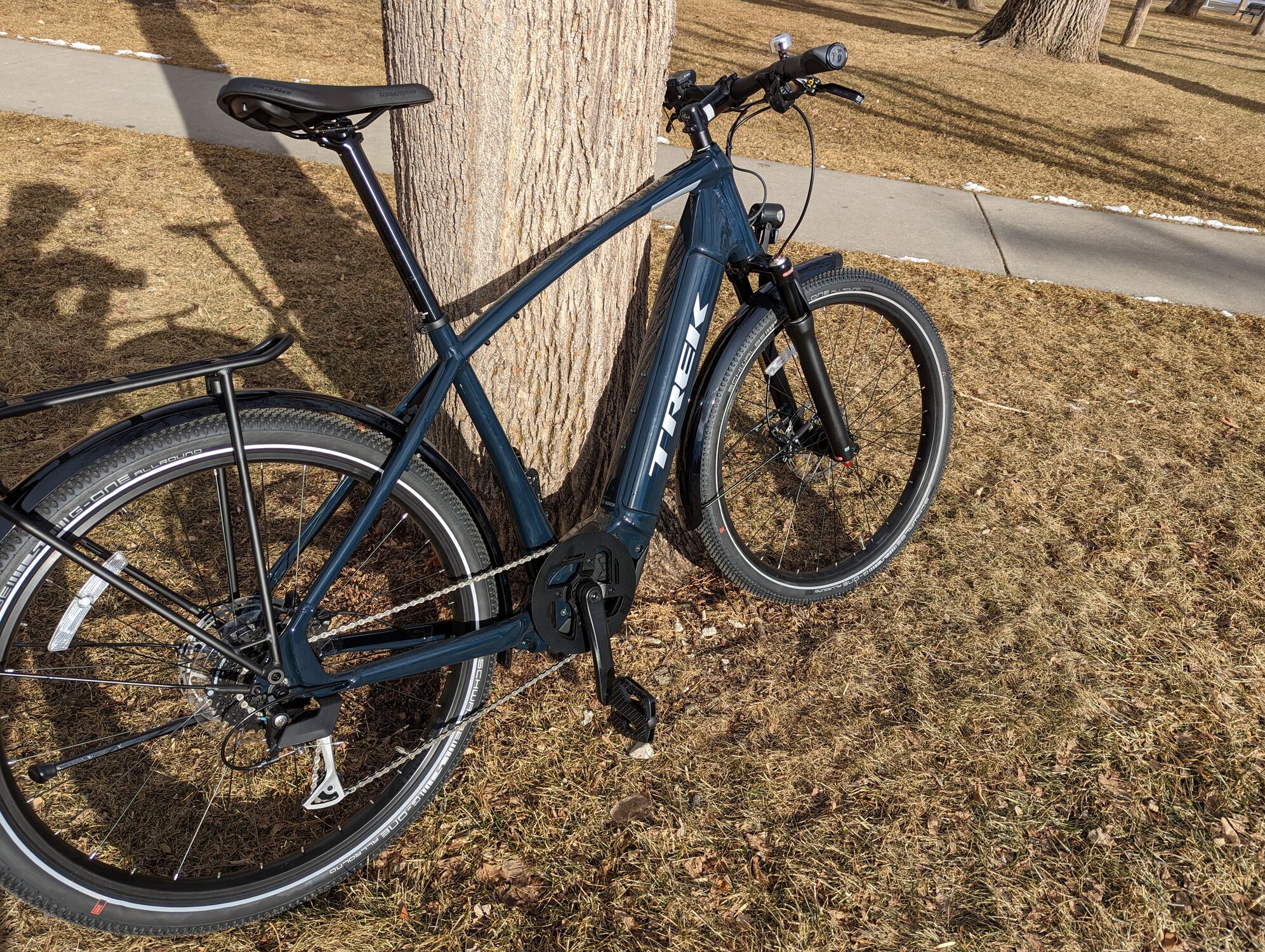

yes, I rode a Yamaha YDX Torc with SLX cassette. A totally great bike, except for my butt being half off the back of the seat. If they made an XL and had a shop that dealt with bike and not just motorcycles and ATVs within 30 miles, I could quit this search for my bike. Instead it is still a question of what to compromise. Also rode Trek Allant+ 7 S today. It sure rode heavy, and what's with the smaller Purion display? I really liked bothShimano's and Yamaha's display that showed how hard the motor was working. Seeing my cadance was elightening too.
Displays personal thing, I like Purion as prefer looking at scenery than watching screen, have phone for that when not riding. Replaced Intuvia with Purion as found it to distracting.
I can appreciate that. There is lots of frustrations associated with interfacing and keeping screen apps working.
Not being used to an ebike, yet ;-) , when the motor is on I find it hard to decide when to shift. It almost seemed that in the extreme, 1 gear and a variable motor was all that was needed to adjust to how much power was left in the legs. The power assist bars on a couple of the displays helped me learn how hard the motor was working and time shifting. Finding my cadence is in the mid 60rpm was informative. But even with the novelty of the display, the safety and scenery are the main attractions.
