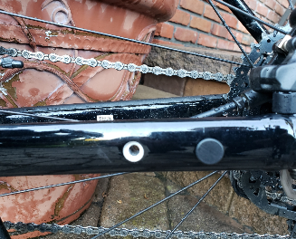

Does anyone know what this little plug is?
YoGe
I lost this thing today on a gnarly gravel trail :) .
Is that this Rubber Cable Port Plug? https://www.specialized.com/us/en/r...813?color=287183-176813&searchText=S179900015
Or something else? If I can't get the plug, what sort of bolt do I need? I don't want to leave that open to get gunked up with dirt.
Thanks for your advice!
Yes, I know that's where a kickstand would mount, but I don't want the kickstand. It's too bulky and extra weight.

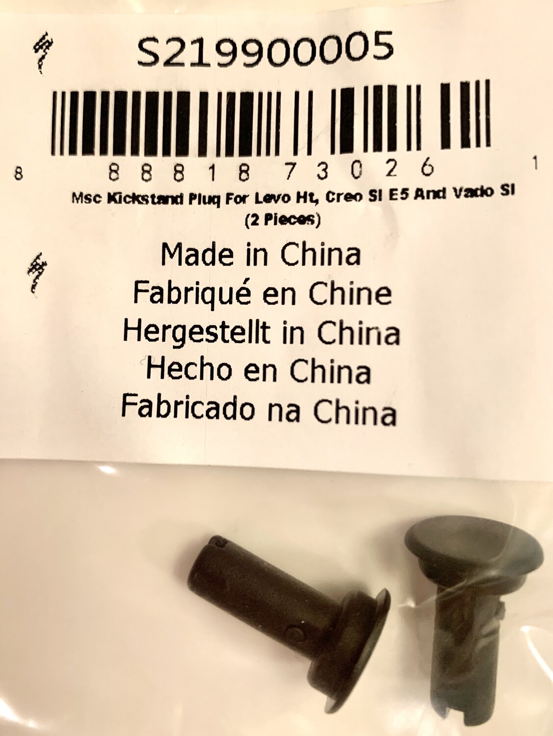

I contacted Rider Care and after a few back and forths he finally found them after I sent in photos. And, yes, their only purpose is to keep the kickstand holes grit free. He sent me four in case I lost another one or two. Now, I don't think that they really keep grit out since they do not plug all the way though. So, some kind of nylon bolt/nut combo might be better or maybe that 3M film to protect frames against wear from cables. I don't believe I have a part number for them.
I've never had a kickstand on any of my bikes until I got my SL4. I consider a major advantage of an eBike in general is that a bit of extra 'bulk' is covered by the assistance of the battery. And I've had more damage to paint on my bikes due to not having a kickstand.
As I read the replies, I like my earlier suggestion of that clear 3M film since I have to check regularly that those plugs are still in place. Obviously, any tape would work and nuts and bolts, too. My left foot/heel occasionally grazes them, particularly the forward one and I will find it slightly dislodged. I don't think the sealant will work until the entire hollow metal tube is filled :eek:
