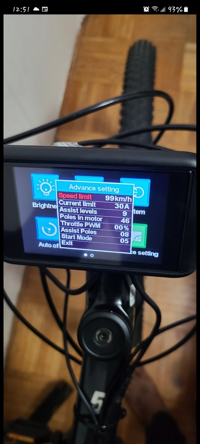

I have a diy ebike with a ukc-1 display and I don't know how to make the pedal assist stop giving me the full motor power when pedal even at assist "level 1",it makes pedaling impossible because it launches me at the speed of the twisting the throttle and then i don't feel anything when turning the cranks
What I would do is write those numbers down, then try reducing them one at a time to see if it results in a change that works better.....
If you get screwed up, go back to the original settings.

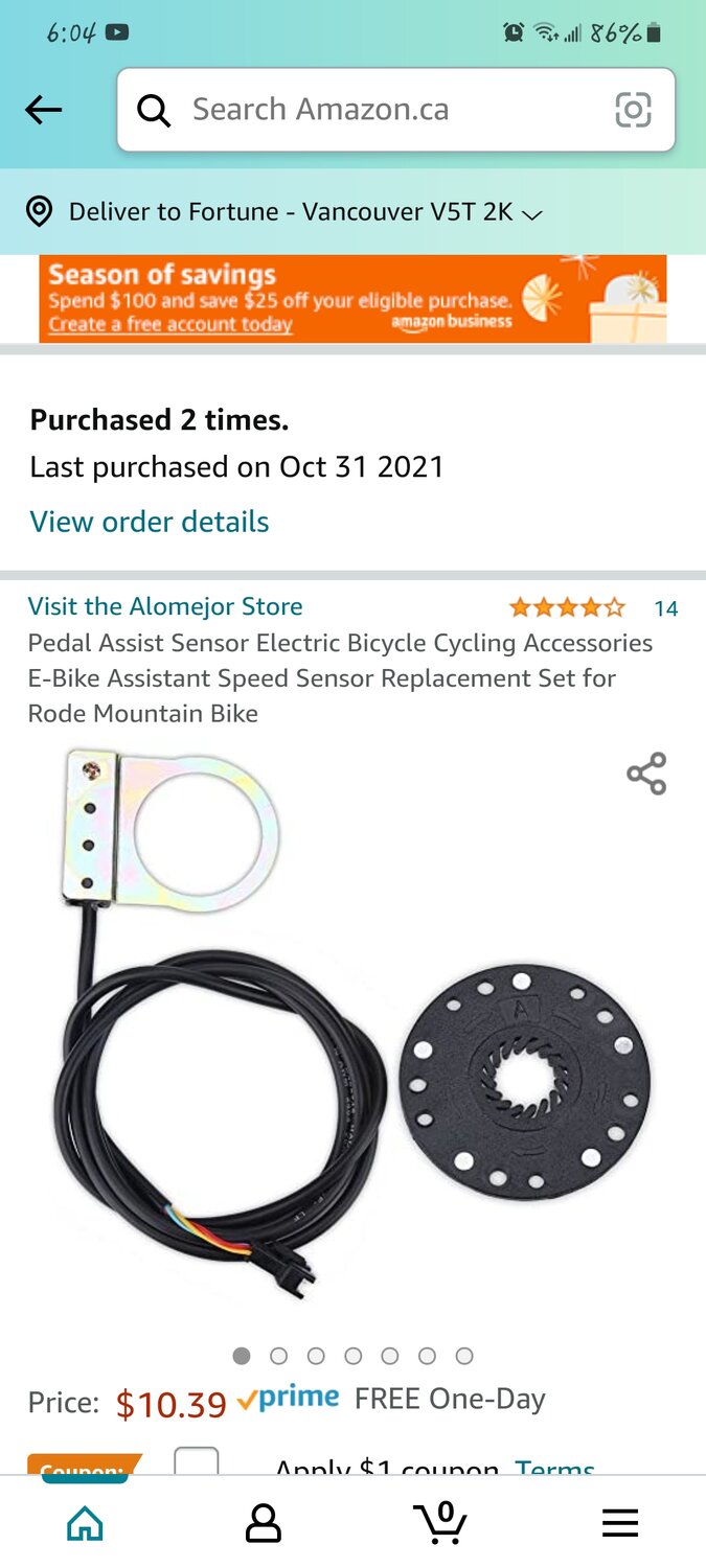

What type of pedal assist sensor have you installed?
Cadence sensor, Torque sensor, hybrid...
Because if you have not installed connected and configured a pedal assist sensor, then you do not have pedal assist, and these 9 modes mean nothing...

My experience with KT LCD's is that the more advanced models allow me to input the numbers of magnets on the PAS wheel into the settings, but it never has made much difference. I can put a basic display with no magnet settings on the same controller, and it works. On the other hand, other KT users report their PAS didn't work at all until they got the PAS setting right. Perhaps they had the magnets reversed, and you can change that in the advanced settings. Getting the sensor mounted and the disk rotation correct can be a pain in the neck. I prefer the fully integrated sensors with disk/magnets/sensor in one unit.
The cadence controllers just detect motion of the magnets anyway. The KT controllers may measure the angular speed, but they don't use it. It's just an on/off switch to them. We get pedal control because they put out current proportional to PAS. I believe they limit the wheel RPM, but I haven't done the no load tests.
Harry, if it's any help, I've found the KT setup just needs the correct polarity. Numbers seen on left side of graph are one direction, higher on right are turning opposite. From there, the number of magnets is a sensitivity issue. ;) Al
