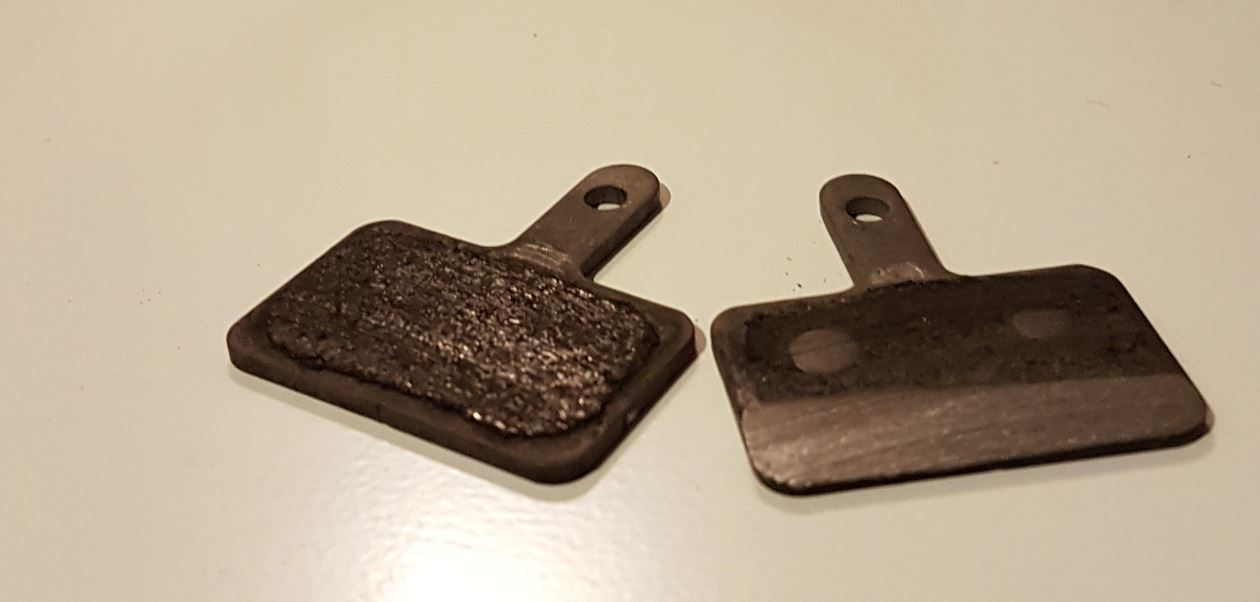

It's a bit hard to tell what the actual material layers are from the pic. The best thing to do is pull the pads and measure the thickness of the pad material. Most manufacturer's recommend a minimum thickness of 0.5mm.I have a hard time telling when a brake pad needs to be replaced. Can someone take a look at this picture and tell me if you think the pad needs to be replaced? Thanks!View attachment 72111
Thanks! that's interesting. in a park tools video, they said change at 1 mm, and that 3 business cards stacked on top of each other = 1 mm, so you could use that to tell. But that's good to know that you could go down to 0.5 mm.It's a bit hard to tell what the actual material layers are from the pic. The best thing to do is pull the pads and measure the thickness of the pad material. Most manufacturer's recommend a minimum thickness of 0.5mm.
Yep, the spreader spring is under 0.5mm thick so it all works out...yeah 0.5mm is good thickness to replace.
I used to try to use all the pad, but it was impossible because this metal spring thing will interfere with the disc.
Thanks for posting a pic.A good indication -- I think -- of the last moment to replace the pads is when the brake lever suddenly feels like it had a deep sag on breaking. Here is a totally worn pad:

I will post a really good example of uneven wear later tonight or tomorrow. Just finished doing my rear pads and I think i caught them JUST in time.Thanks for posting a pic.
One thing to note about this is that the pad wear isnt always 100% even, so while the OP picture looks ok, the actual wear could be different in several spots due to less than perfect pad alignment. Pads also tend to wear more at the back even(where the disc first touches the pad as shown in this pic) when properly aligned .
The inside and outside pads might wear differently as well duw to pad alignment.
All this is likely only an issue when the pad is pretty worn down though, the OP picture looks fine

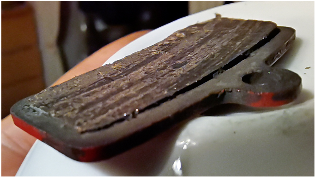

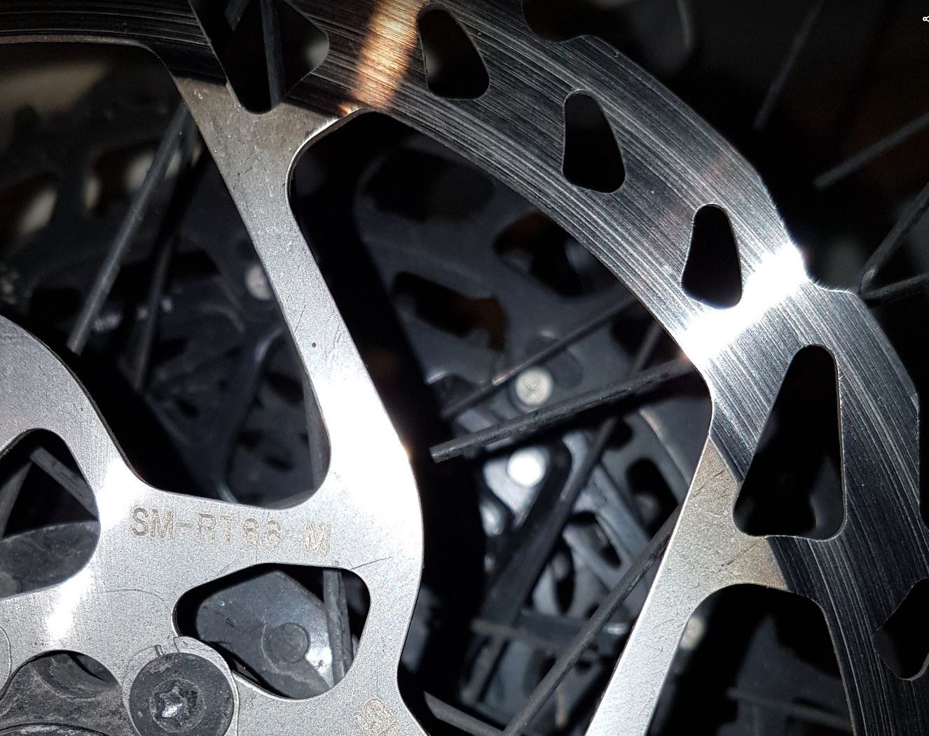

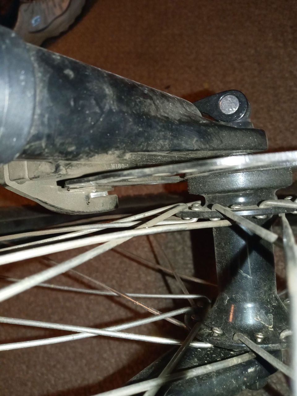

 Can you explain what you mean in the picture about the rotor being “scored”?Ok, here goes the pad replacement from yesterday.
First off - I think I was maybe a touch late. Disc brakes are new to me on a bicycle.
These pads are toast - and should have been replaced about 200km ago I think.
That's Lesson #1.
Rotor is slightly scored, and I'll order one and change it out. $40 Canadian is one of the cheaper lessons I've learned lately.

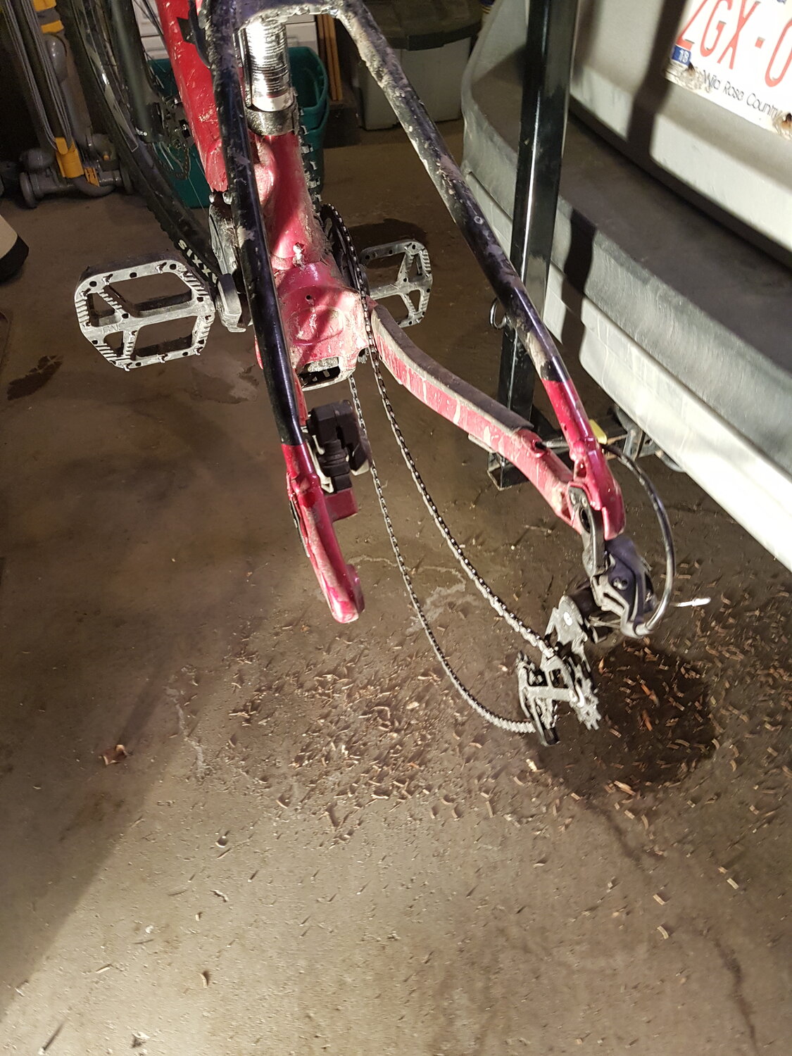

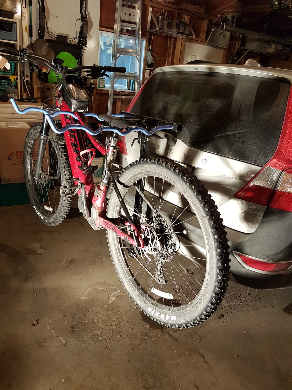

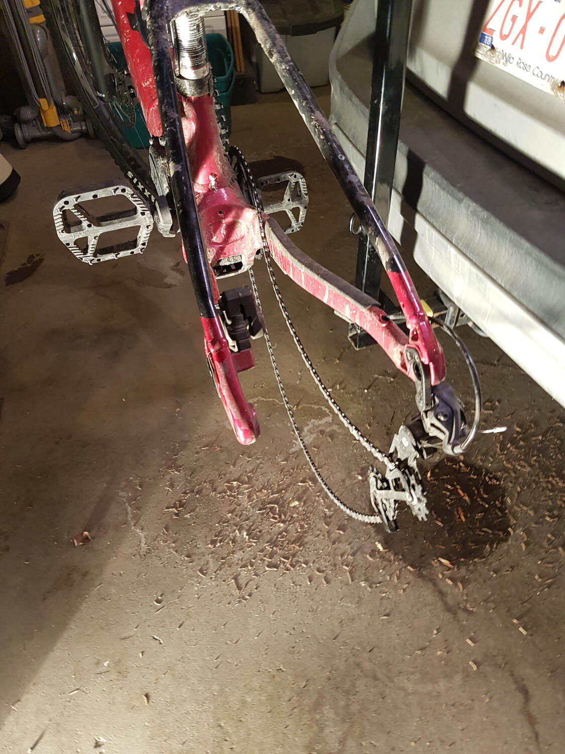

Process - first I put the bike up on my makeshift maintenance stand. This is borrowed from a friend as I have a platform hitch rack.
Then wheel off.

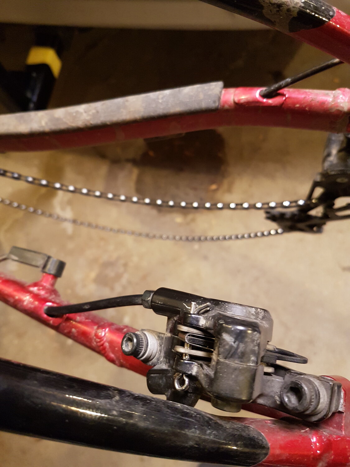

View attachment 72297 View attachment 72298 View attachment 72299

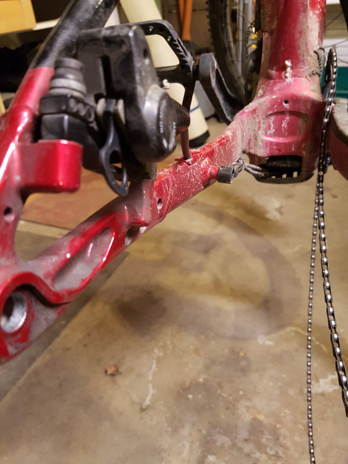

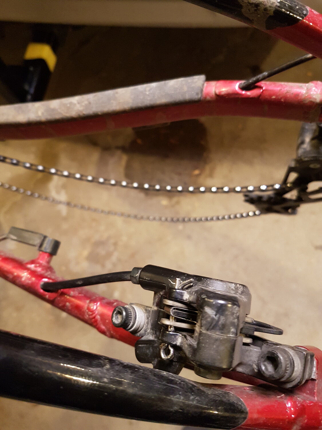

I didn't take any picture of removal, but the above show the new pads and spring in place.
NOTE - the spring is a complete PITA to deal with, and in those photos, it's not sitting correctly.
I was using the shipping wedge to reset spacing and it wasn't right (and didn't feel right) and trying to replace wheel confirmed it wasn't right...
Took it apart again, reset the spring and put it back together - much better.
The process of getting that right are lessons 2 through 11... and wheel slid in relatively easily.
As the old pads had uneven wear, I thought I might be best served to do a caliper realignment.
So loosened the bolts, squeezed and held lever to centre the caliper, and refastened and retorqued the caliper.

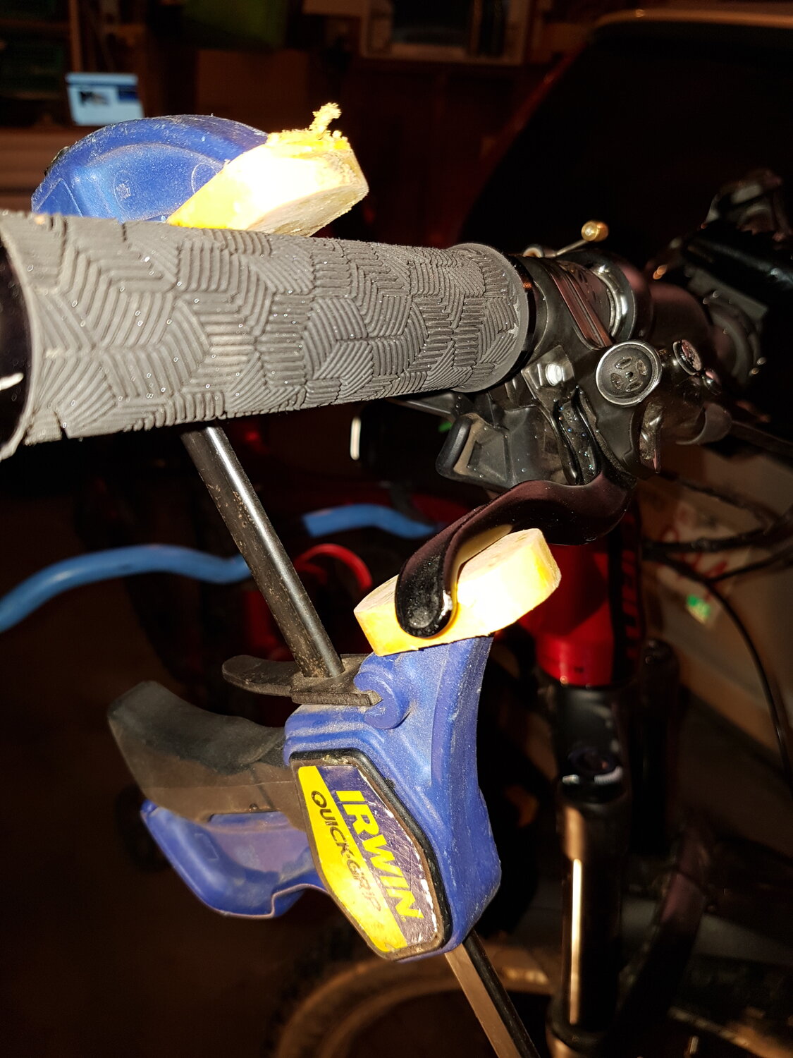

My lever helper:
