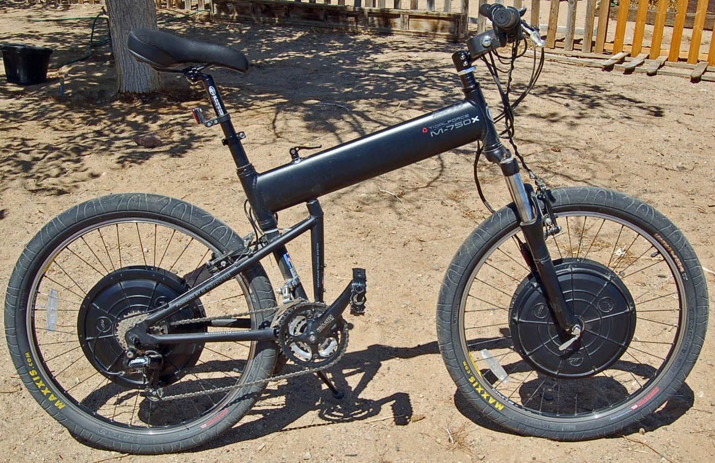

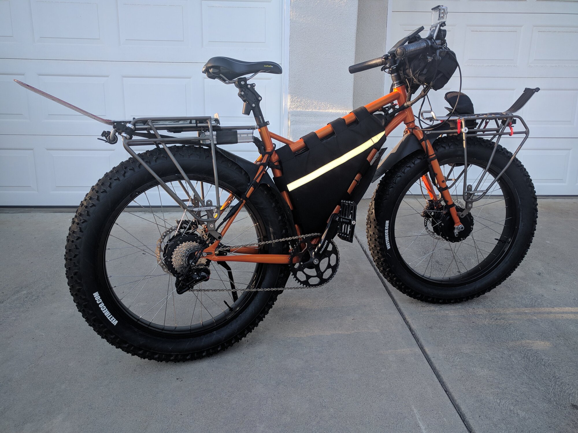

I do believe the military has basically done away with gasoline-powered stuff, do not know what they run Light ICE-powered equipment on, there sure is an advantage to only having to keep up with one fuel type. Not sure of their default, JP4 or Jet A, I do not have the enthusiasm for weapons of war I once possessed, There is a project that pops up into my mind from time to time the "Moon Buggy" 4 wheels, 3 motors HD bike wheels, articulated want 26 inchers on the back plus size knobbies ,South American trike unit with differential on rear installed on good steel cruiser frame, reasonable cargo platform, articulated front axle, bike steering( only part requiring much welding and fab, fatish 20 inchers on front at least 180 disc on front, single large 203mm 0r bigger disc on rear axle, good seat with suspension seat post 36 volt mid-drive motor 6-7 spd drive, 250 watt( 45 nm torque) on front wheels, dual controller for front motors, torque sensor on mid-drive 25-30 Ah lithium power source should be good up to between 15-20 mphThose Montagues were used in the first Desert Storm. The idea is you can land lightly and move quickly with stealth. No heat signature. The military has one design of a motorcycle that uses almost any fuel. It is diesel and can run on anything peanut oil to aviation fuel.
Of course, it will cost more than I think it would, the front wheels maybe can be acquired for around$400( barring good used assemblies, mid-drive$500, frame less than $100, SA trike rear $400, welding. $100 at least , batteries $400, misc parts( may use a continuous axle on the front or make up a narrower double front wheelset to bolt into the dropout, for around$2500 it could be a reality, still cheaper than a good used golf cart. Just a pipe dream being retired makes money flow much slower( still have to modify the fattire beastie for a little more climbing ability.
