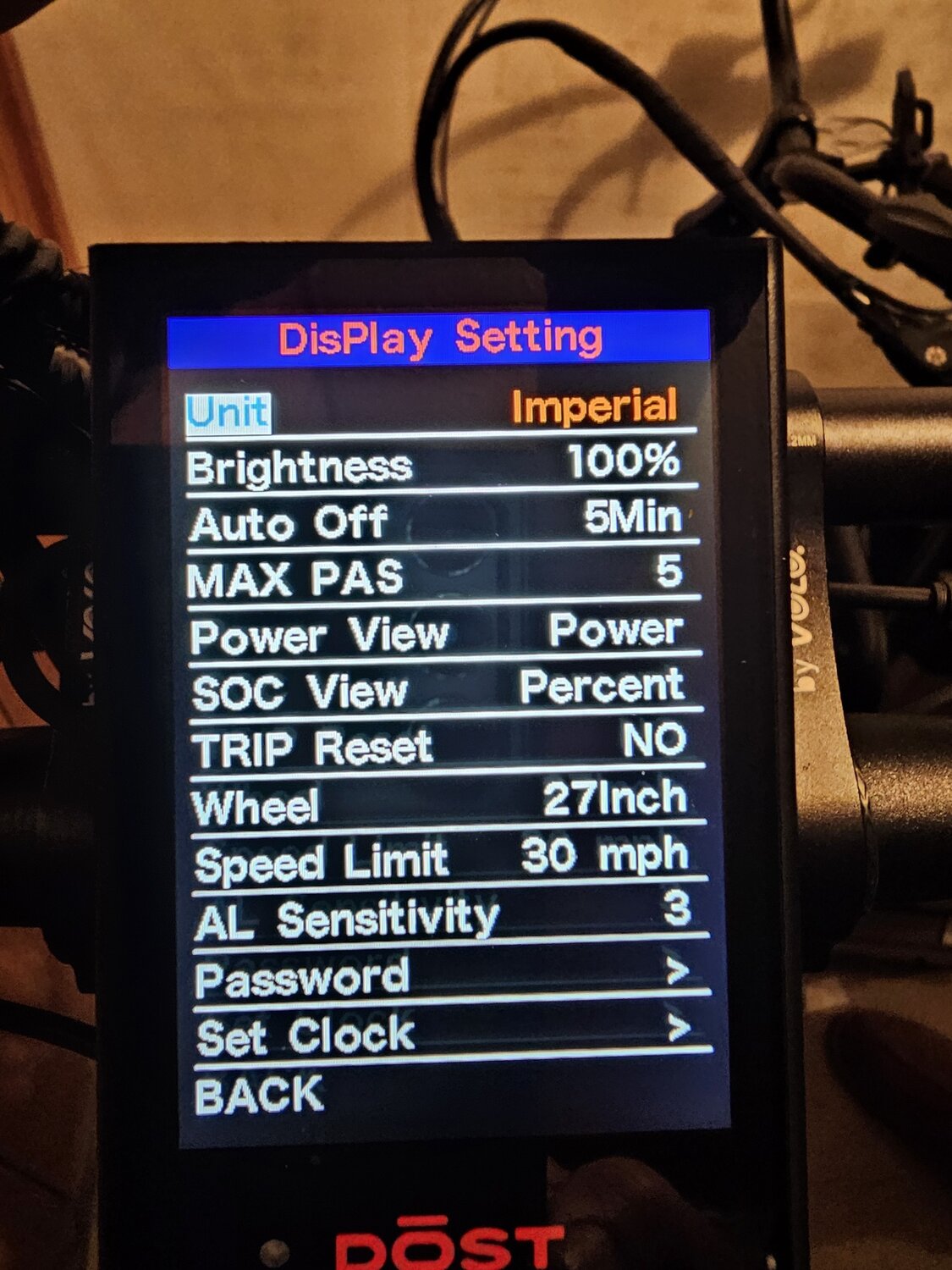

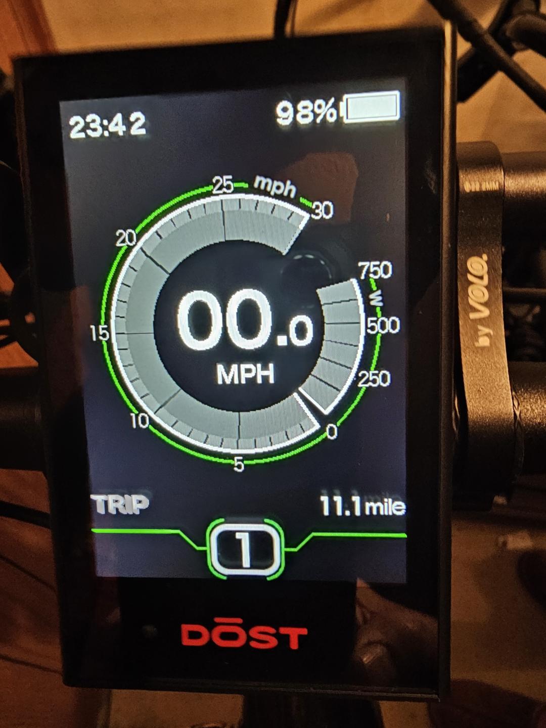

I have a few Pictures to share of my display screen... let me know what you think
Not where I can grab a picture of it right now... I will snap a few tomorrow and post them.
Here are a few pictures of my display... let me know what you think
