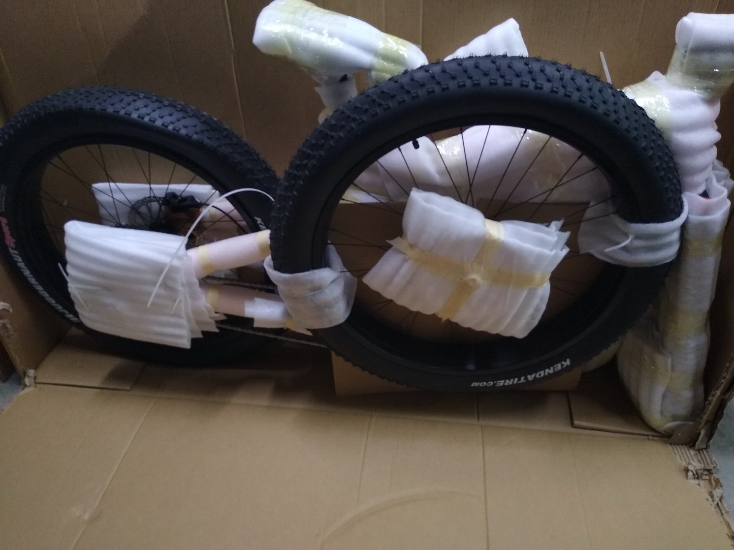

I ordered through Dengfu's store on Aliexpress. I ordered the "Economy" build, but with parts shortages industry-wide and substitutions being made, I can't guarantee these are the exact parts that will come on another bike, just what came on mine. Initial order was on April 7th, it shipped May 18th--I asked for a custom color which may have slowed that down a bit--and showed up July 20th. I got no useful tracking information the whole time in transit, when the shipping company called to schedule delivery, that was the first thing I heard.
Seemed to be well packed.

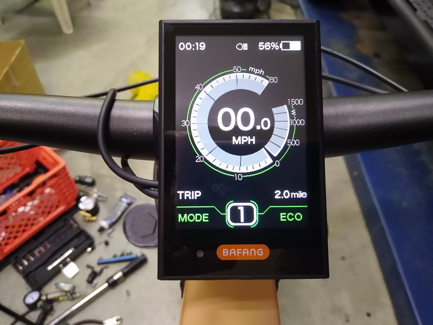

The display it came with was the DPC18, which is much nicer than the G961 shown in pics on Dengu's site:
It's a bit big for my tastes and so enticing to look at it's a wonder I didn't get run over by a bus on my first ride as I couldn't stop staring at it!

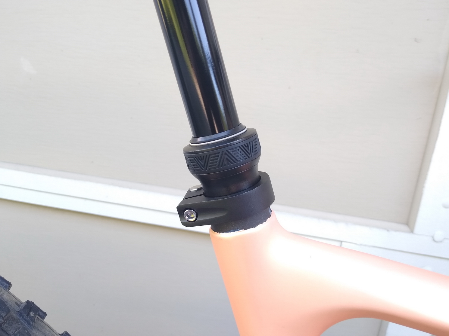

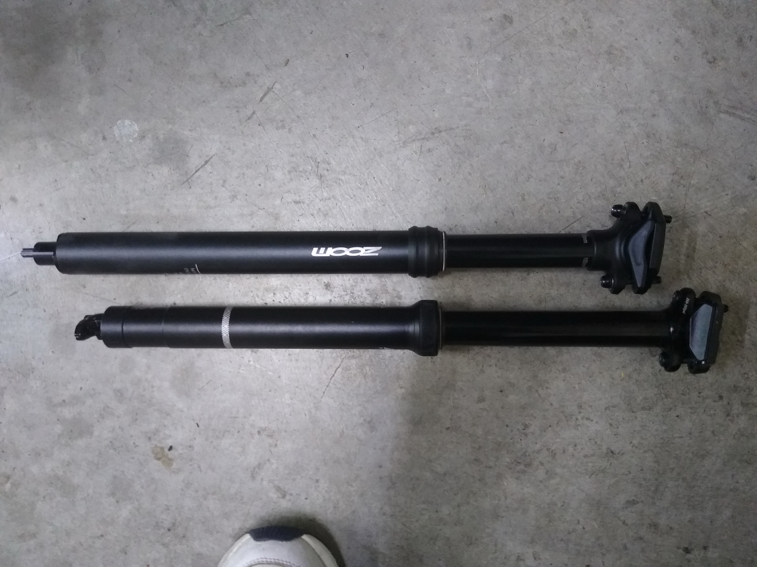

And that's right, even though the Economy build wasn't supposed to, it came with a dropper! It works fine, but for me the 18" frame is on the big side and one of the flaws if the Zoom dropper is it has an obnoxiously long insertion length for a mere 100mm dropper--in the pic above it's lowered as far as it will go. Here it is compared with a Loam 150mm I thankfully had on a shelf:
So on the 18" frame, the 150mm PNW Loam dropper stuffs down almost completely:
The bike's a lot easier to handle when my feet can touch the ground at a stop! I was pretty happy it came with the dropper mainly since I didn't have to route the cable when I added one--I wasn't looking forward to that.

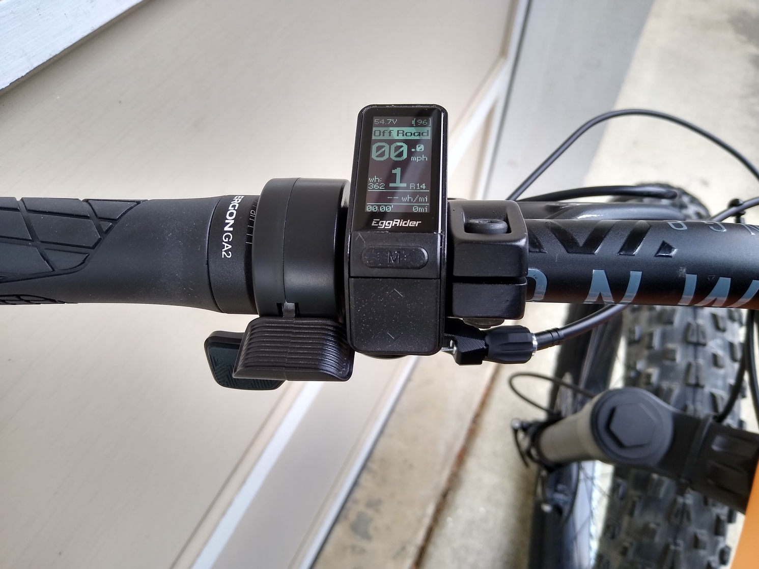

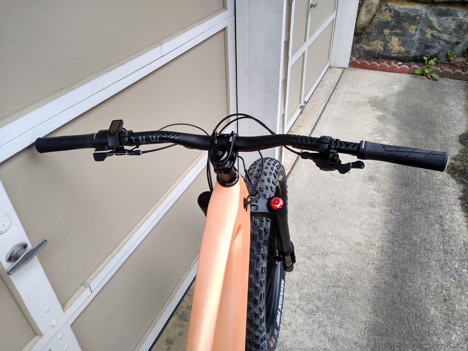

So far, I've installed the Eggrider and re-arranged things a bit to clean up the cockpit:
Also swapped on a PNW bar and stem, though the stock stuff wasn't bad. I was happy it came with a pretty short stem instead of the long ones shown on Dengfu's site. I also threw on some big Maxxis FBF/FBR 4.8's I had laying around:

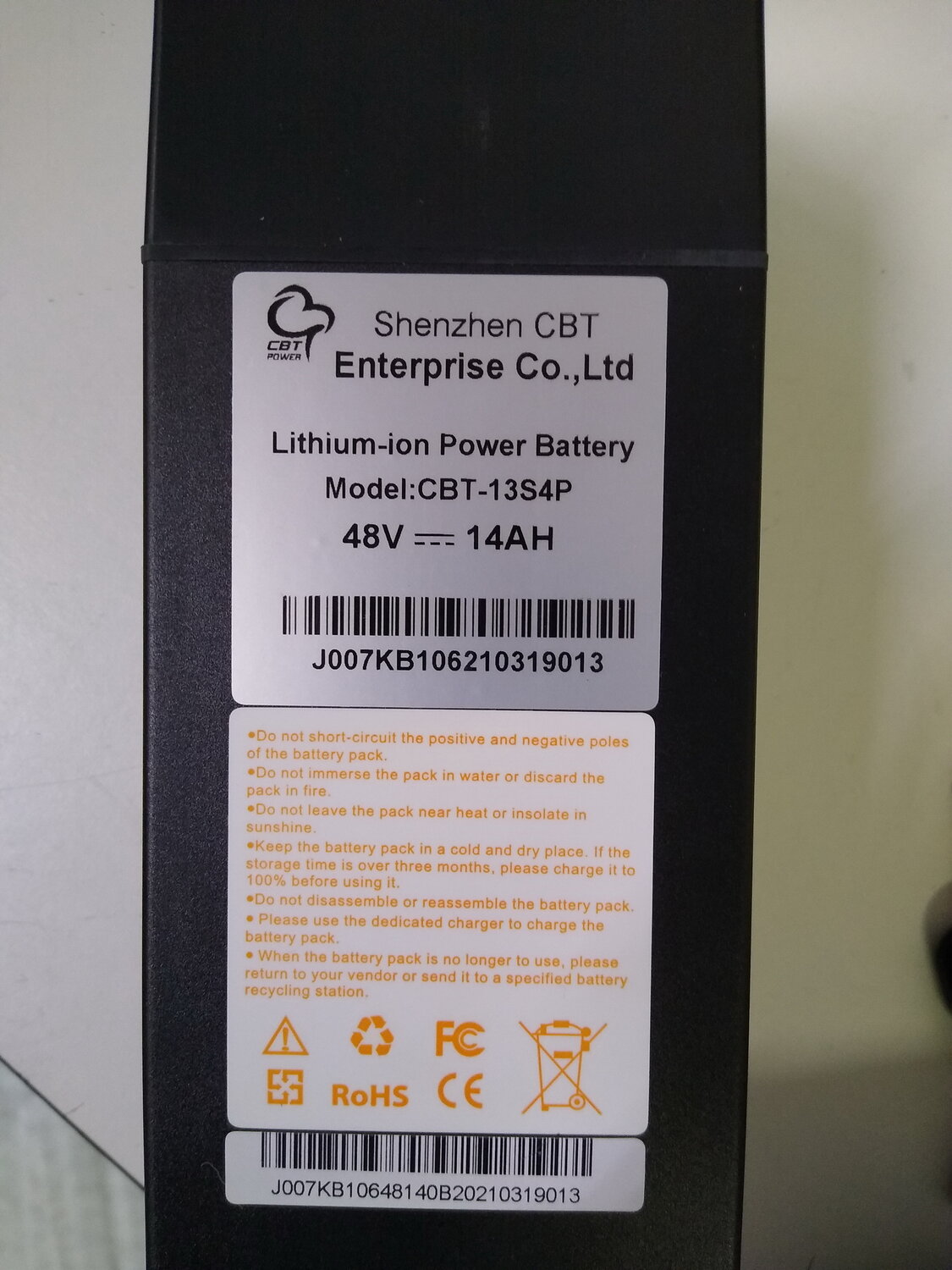

Another pleasant surprise--I was told due to a cell shortage my battery would only be 12.8 Ah...but it looks like I got the full 14:
So I got a lot of pleasant surprises: Nicer display, UART, 14 Ah batt, dropper, decent/usable bar and stem, taller axle to crown than I was expecting so it can handle a decent length fork.... I would say the biggest disappointment was the fork itself--I expected it'd be cheap on an "economy build," but one of those inverted things? I hate those! Definitely a thow-away item. Hopefully my Mastodon gets here soon!

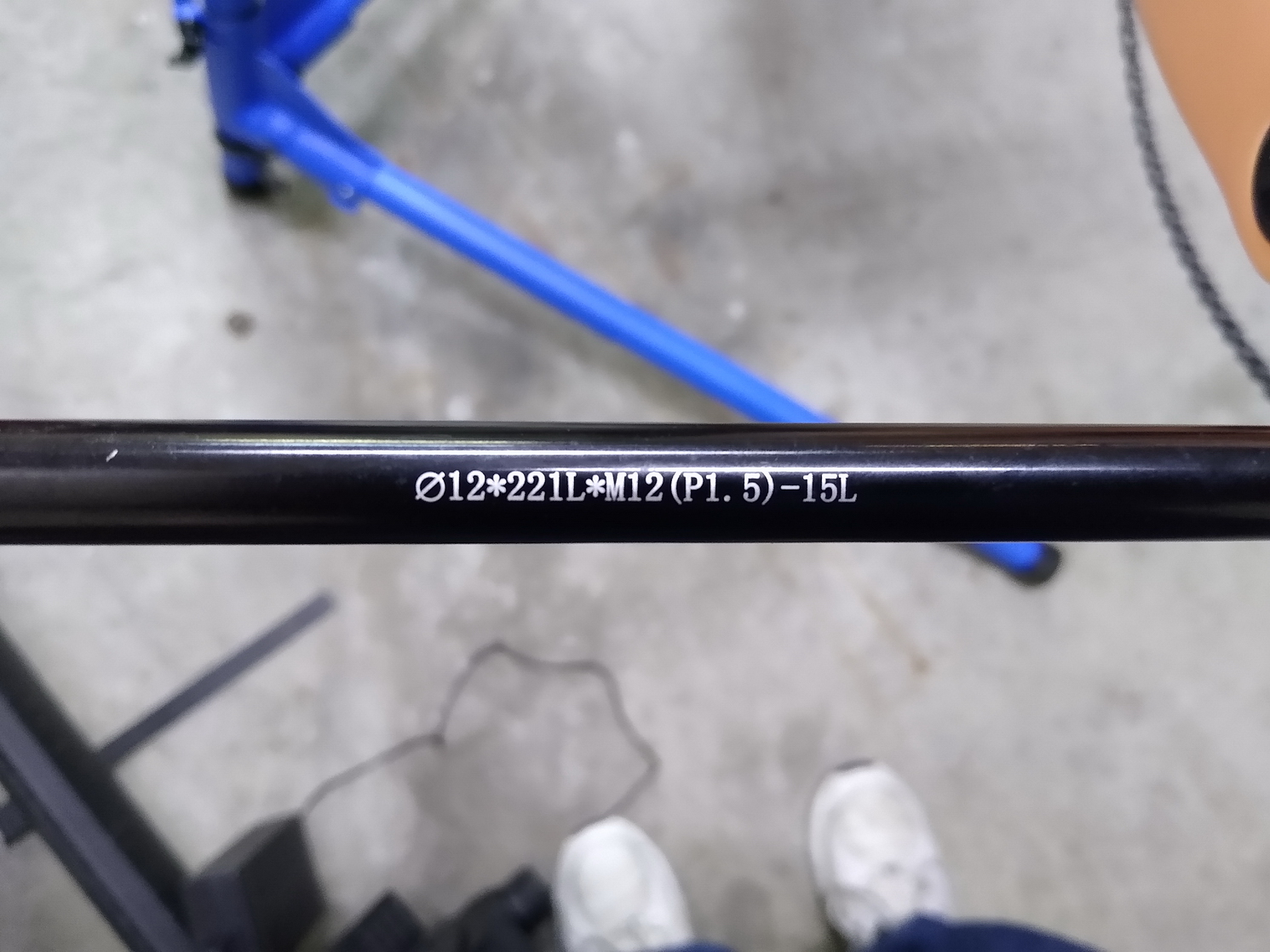

For those looking to add a rear rack, the axle size is:
The Old Man Mountain Rear Fit Kit 808 is listed to work for axles with 223 to 229 mm length, but I talked to the guys at Robert Axle Project and they assured me it would work. If I don't think I'm getting proper clamping force on the axle I should be able to add a washer or two and make it work. I'll let you all know how that goes....

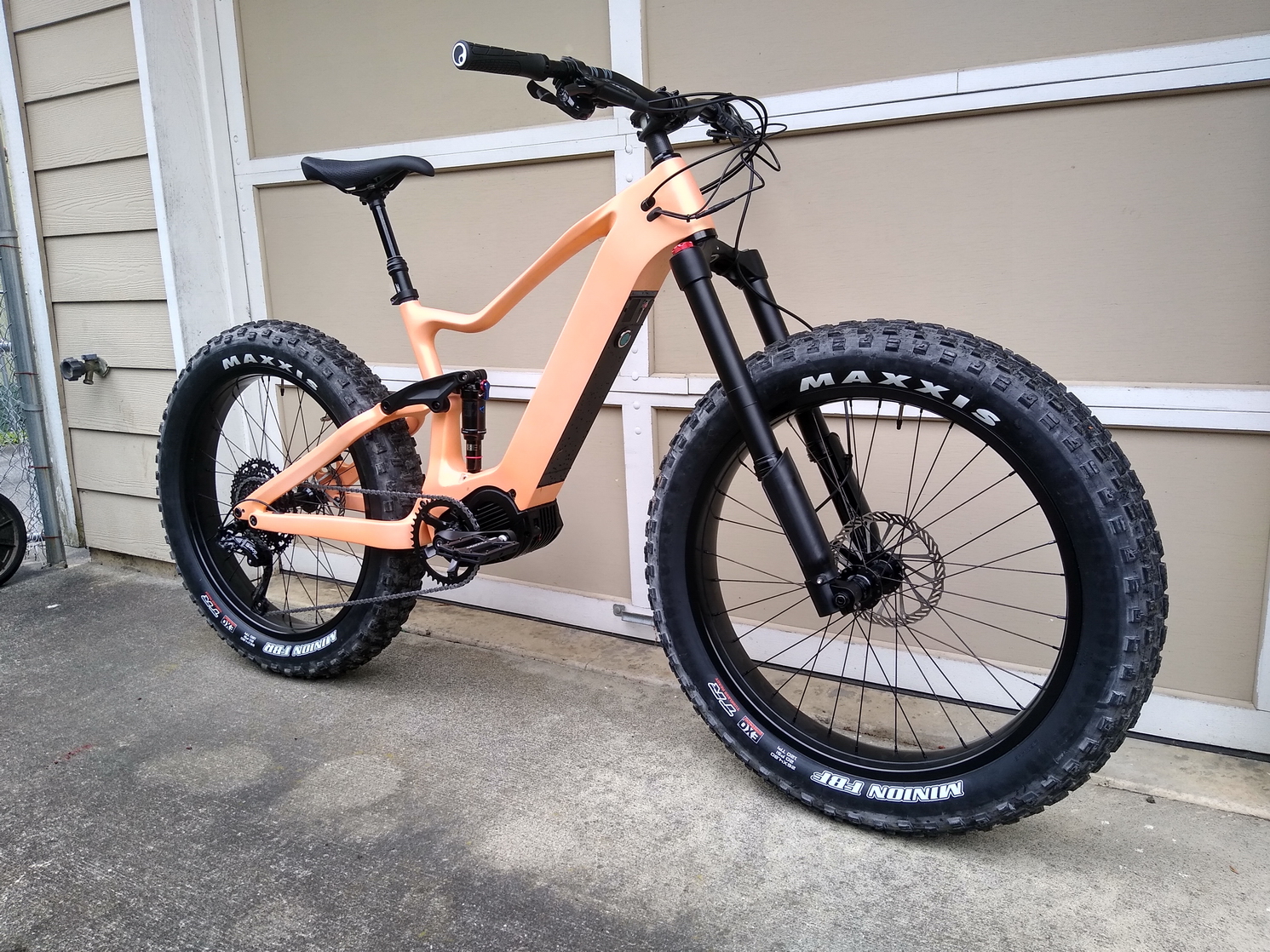

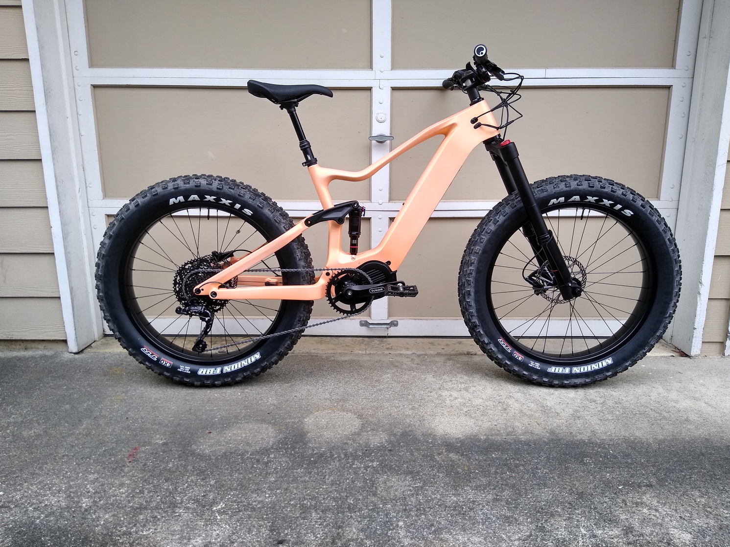

Thanks guys. A few upgrades done, here's how she looks now:

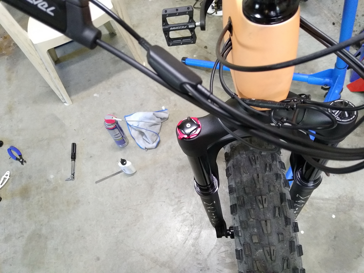

The big one, the Mastodon Pro. I ended up ordering a 100mm STD version since I actually found one in stock. I've set it up to 130mm EXT configuration. My quick measurements suggested the stock fork had 551 axle to crown (a spec missing from all of Dengfu's info). I figured I'd set it up to 561 as 10mm shouldn't be enough of a change to matter much. After getting stock fork off and measuring more closely, it seemed to be closer to 560 than 550, so 561 really isn't changing the geometry any noticeable amount.
I decided to use EXT config (three bottom out spacers on each side) since I might get a wild hair to try 27.5X4.5's at some point. Also, it's much easier to run a decent fender on a Mastodon when in EXT config--when in STD config the arch travels above the crown when it's bottomed which can guillotine your fender. In any case, 561mm axle to crown (one top out spacer on the air side) lets you have 130-150mm travel with this fork depending upon how much tire/fender clearance you want.

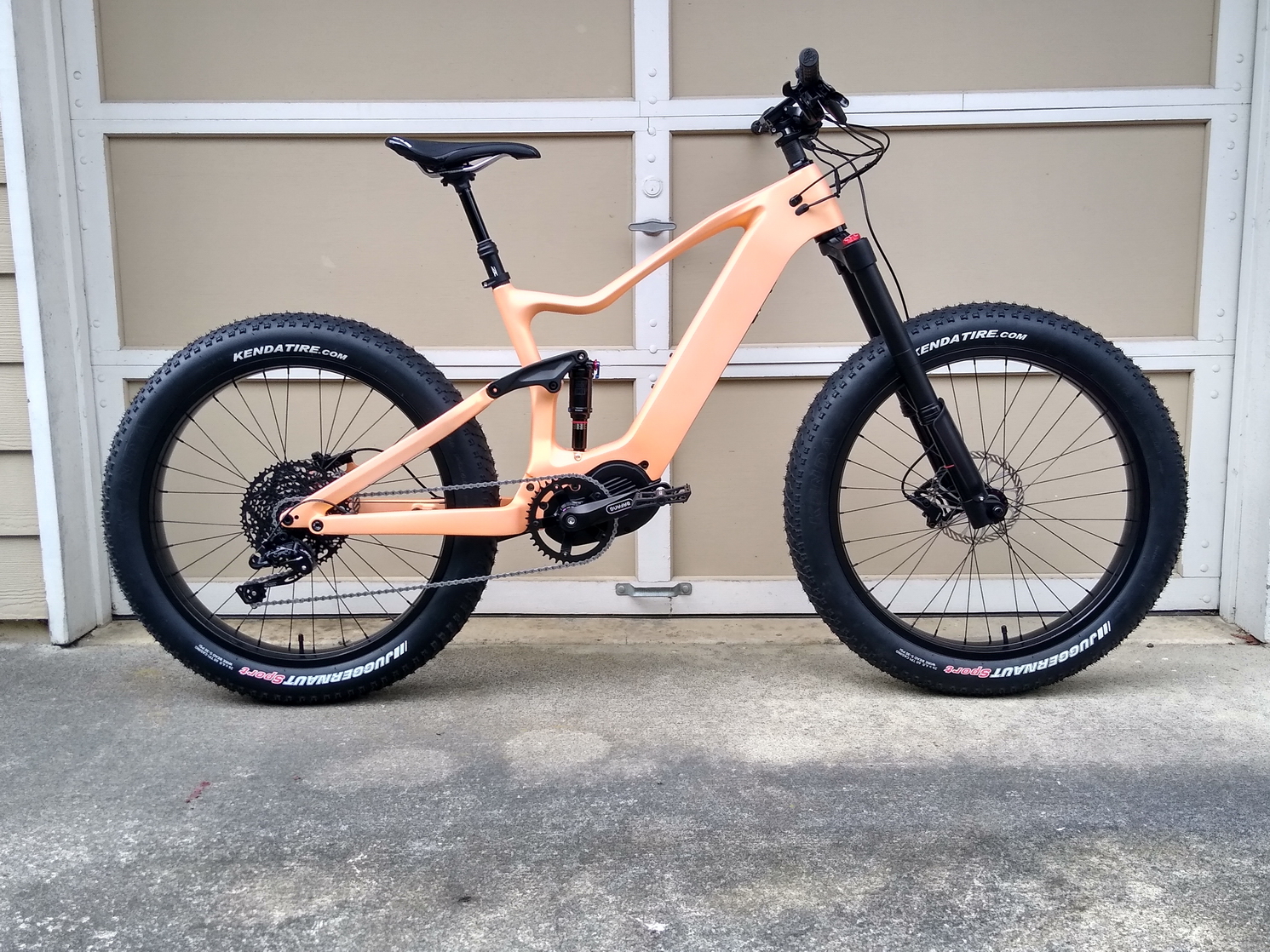

Next was the drivetrain. A Christini 104mm adapter (fatbike version) and a 36T chainring:
Chainline is within a mm or two of stock and about perfect putting the chain right in the middle of the cassette. Speaking of cassette, Sram 12 speed upgrade:
Complete with the blingy gold chain! It was the only one I could find back when I ordered.... I found 126 links was about perfect as-is for the 36T chainring. Besides the better shifting, the best thing about this is being able to downshift multiple gears at once. I'm so used to doing that on my other bikes when rolling to a stop or approaching a steep incline, it was driving me nuts not to be able to do it.

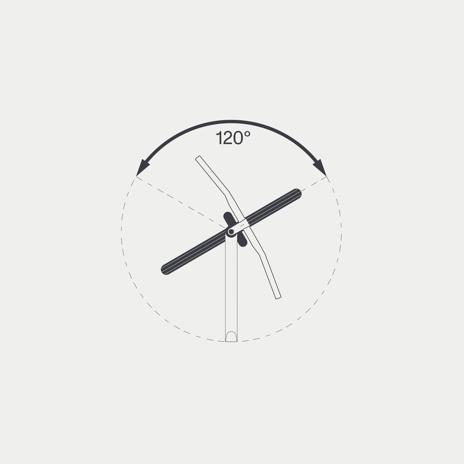

Forgot to mention one thing: The Lekkie Buzz Bars are a no-go, even the "offset" version. I thought they would fit, they looked like they would fit, but after torquing one down completely I found it rubbed the chainstay. Not enough offset.

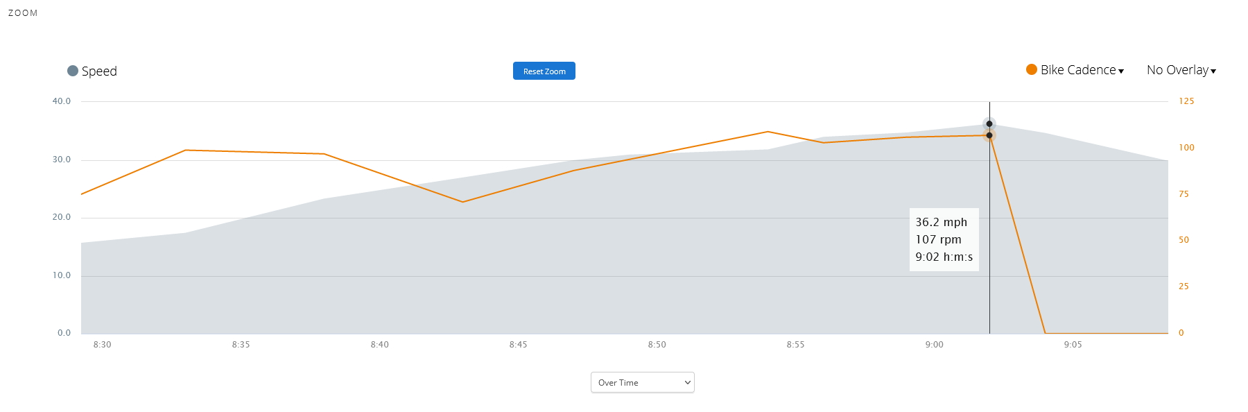

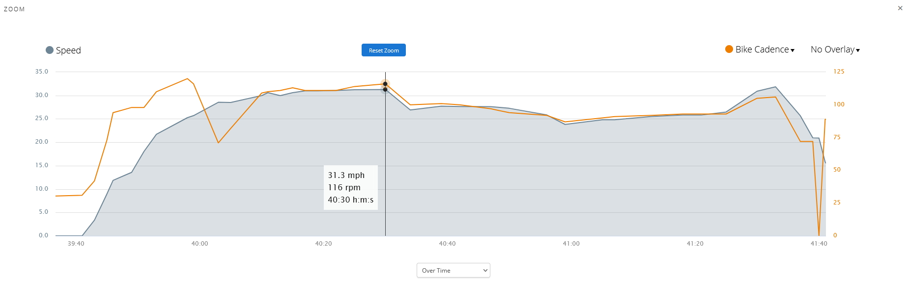

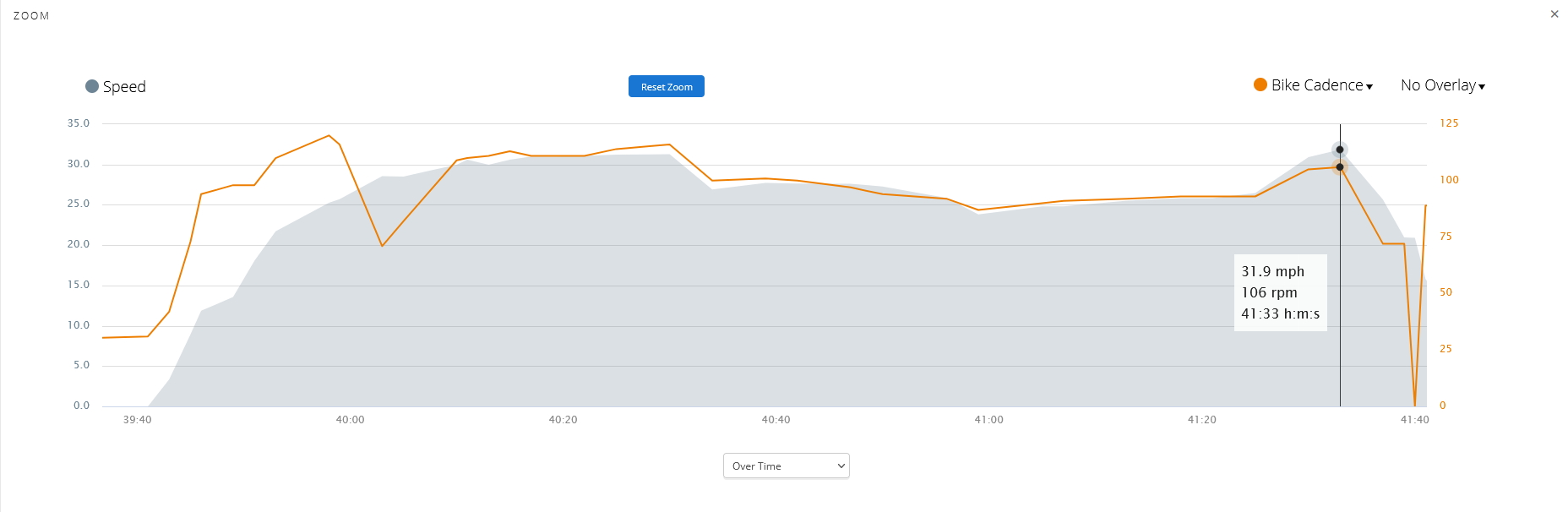

For comparison, here's the fastest run I made with the 40T (had to try one in max assist mode!):
All of those were with the Maxxis 4.8's which are quite a bit taller than 26X4.0's. I think most street tires people might try will be shorter as well.

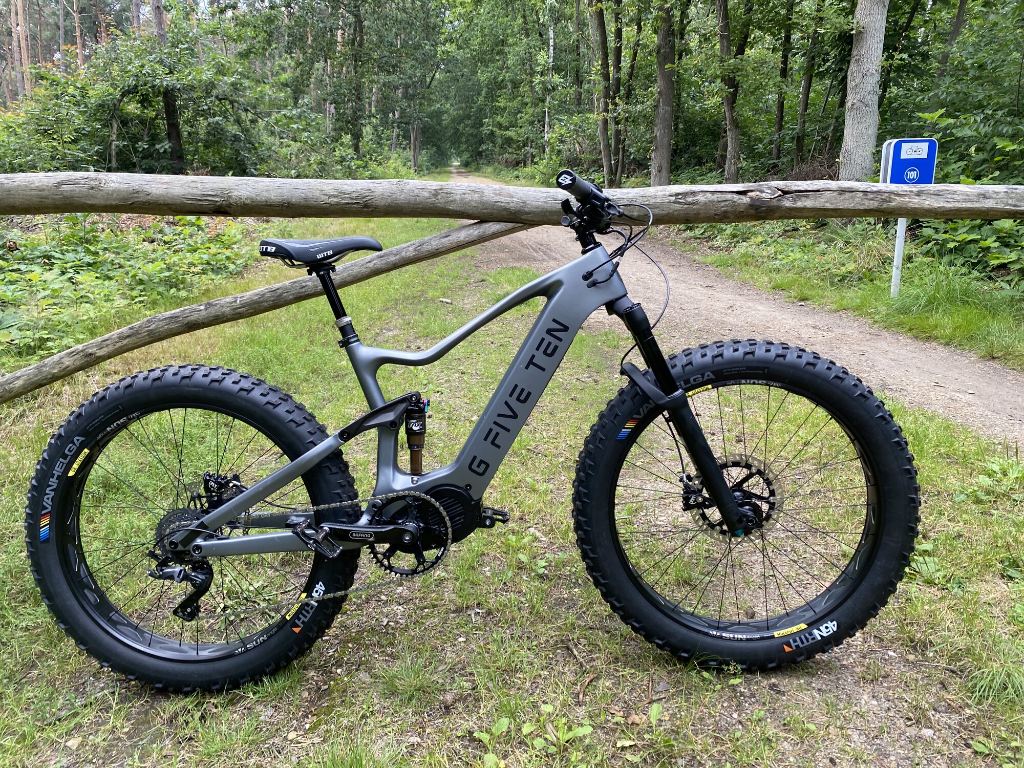

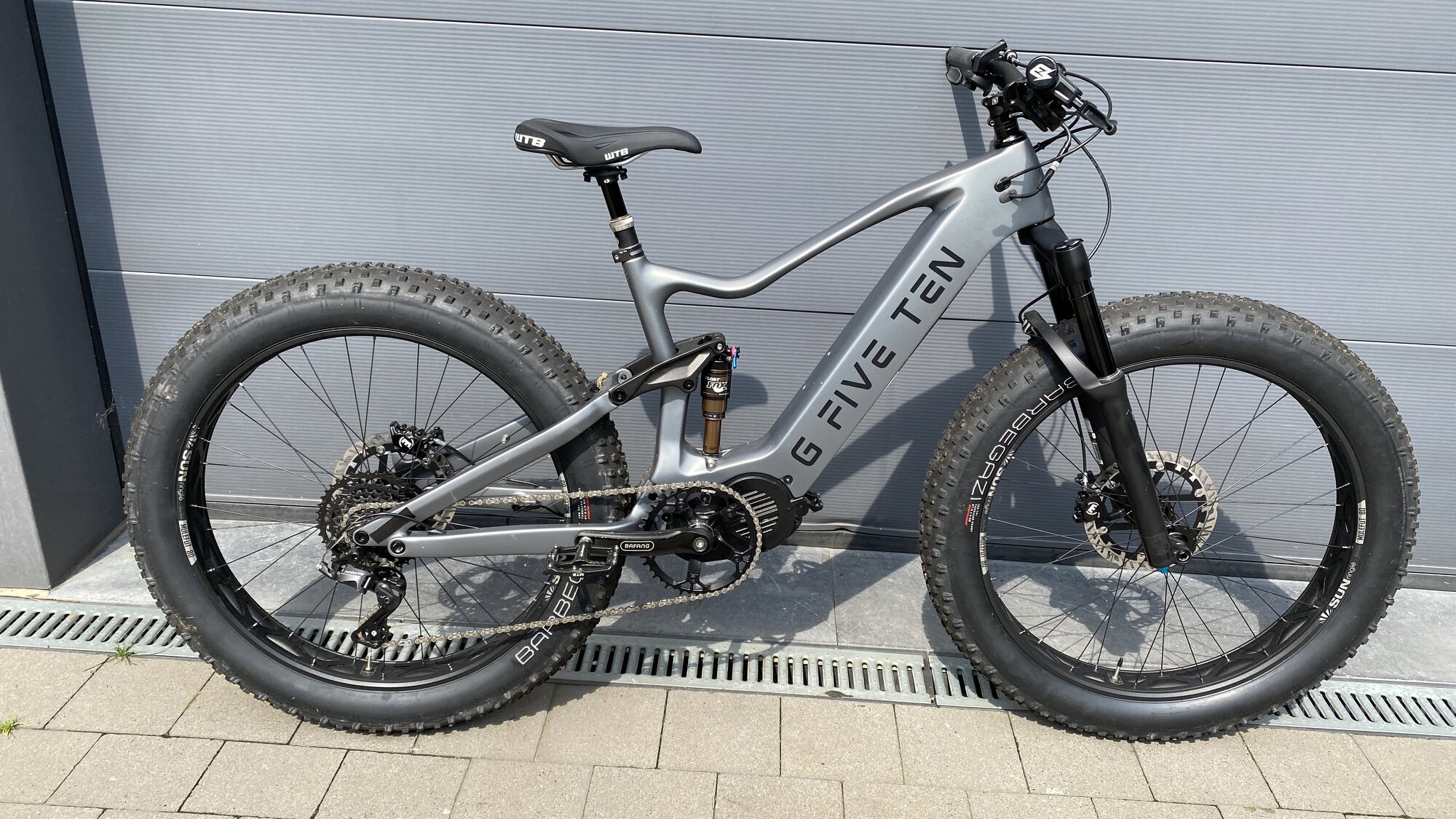

Hi Jon, great bike.
I run 27.5 x 4
and 27.5 x 4.5 on mine.

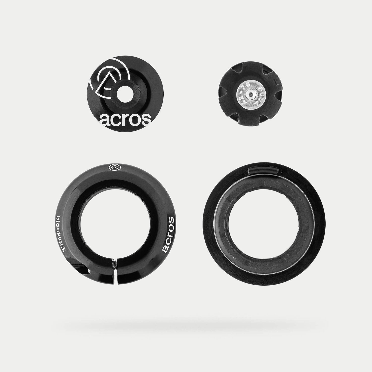

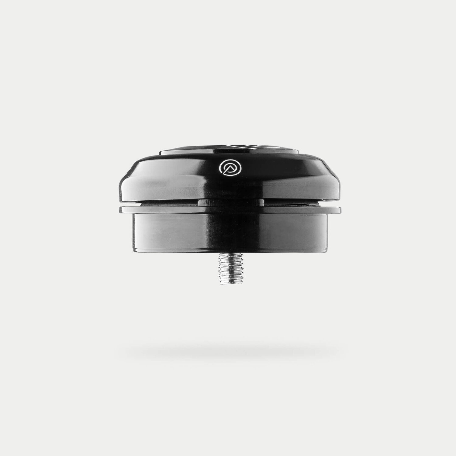

I didn't find an extended lower bearing cup so got a blocklock headset instead to prevent the fork from hitting the frame.
51-02-610S-120_zs56-blocklock-unterteilboden1-5_polygon_120-_5.jpg51-02-605R2S-135_ZS44_BL135-_schwarz_Oberteil_ZS44286_3.jpg51-02-605R2S-135_ZS44_BL135-_schwarz_Oberteil_ZS44286_1.jpg
Chainring is a 46T
Here is a partslist.
View attachment 96956View attachment 96955View attachment 96954
That probably is a better solution. I was looking for those when ordering stuff but couldn't find any in stock. What size lower headset does this frame use?

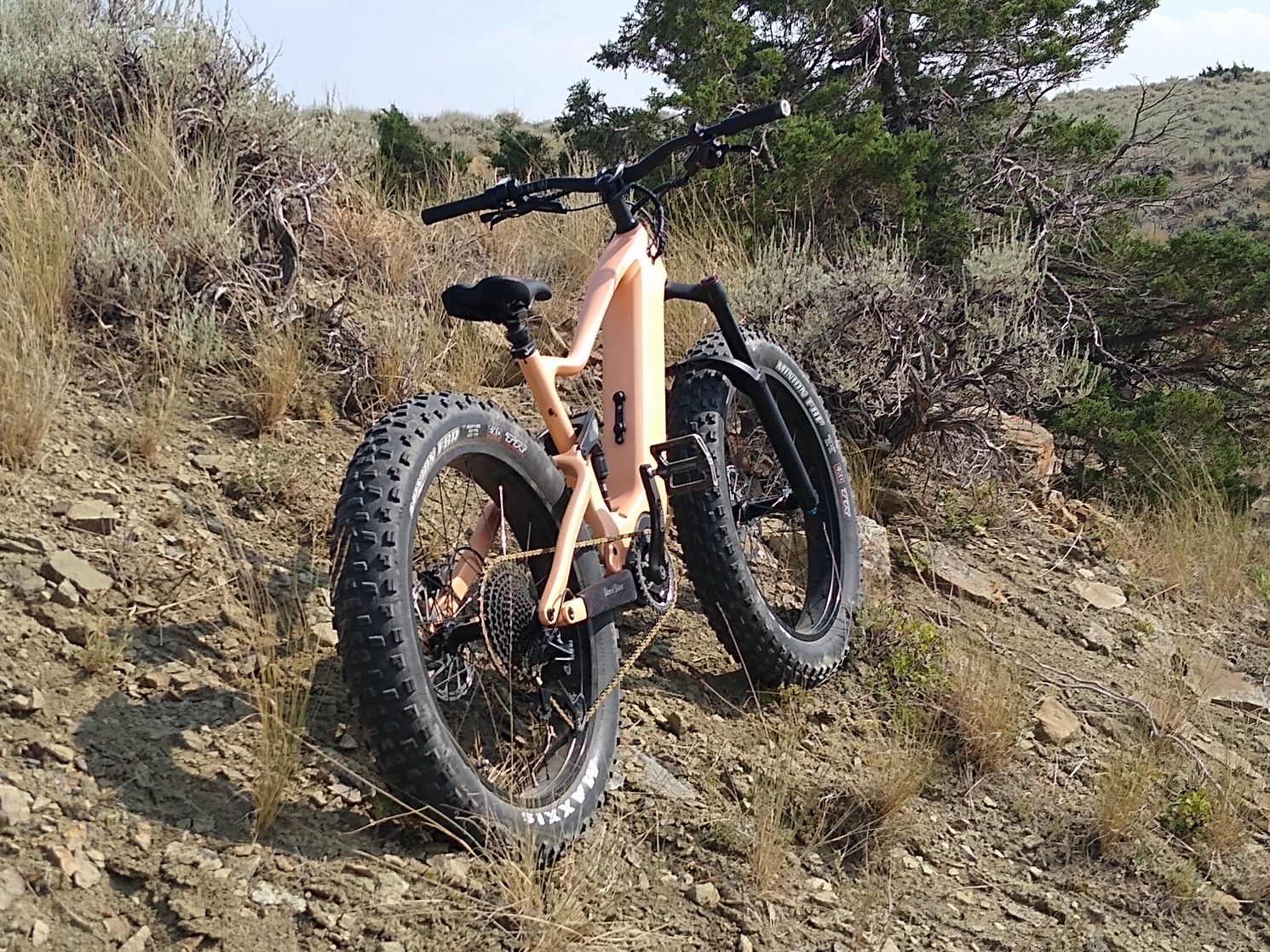

Time for some long overdue updates. I'll try to keep these in order.
I'm still up in the air about the shift sensor--with the stock motor programming, shifting had to be done quite delicately. With the programming changes I've made so far, that is dramatically improved to the point you can pretty much shift it like a regular bike by just lightening the pressure on the pedals when you shift. But I think I'll install one when I put the 12 speed on just to see how I like it.
I went ahead and added one:
While it's intended to mount closer to the motor, with the nice internal cabling there isn't much space in front of the derailleur and since I'll be complicating things with a rack I decided to mount it up on the bars. I had to extend the wiring which was more of a PITA than I planned, but I got it on there and it works as intended.
The verdict? I love it. I know some don't so it's a personal choice, but I love it. Even after programming I was still not getting the motor to back off as quickly/smoothly as my legs when wanting to downshift. I take great pride in my ability to downshift gears smoothly on my manual bikes, even when going uphill, and that was just not possible to consistently do smoothly, even when doing it right. The sensor pretty much ensures if you're doing things right you'll be fine. The cut to motor power is super brief, but as long as you're pedaling with a decent cadence it's enough and it's perfectly timed. I wouldn't expect it to save you if you're doing things wrong...if you find yourself in much too high a gear on a hill and you're standing on the pedals...then no, don't expect it to allow you to downshift as you wouldn't on even want to try on a manual bike.

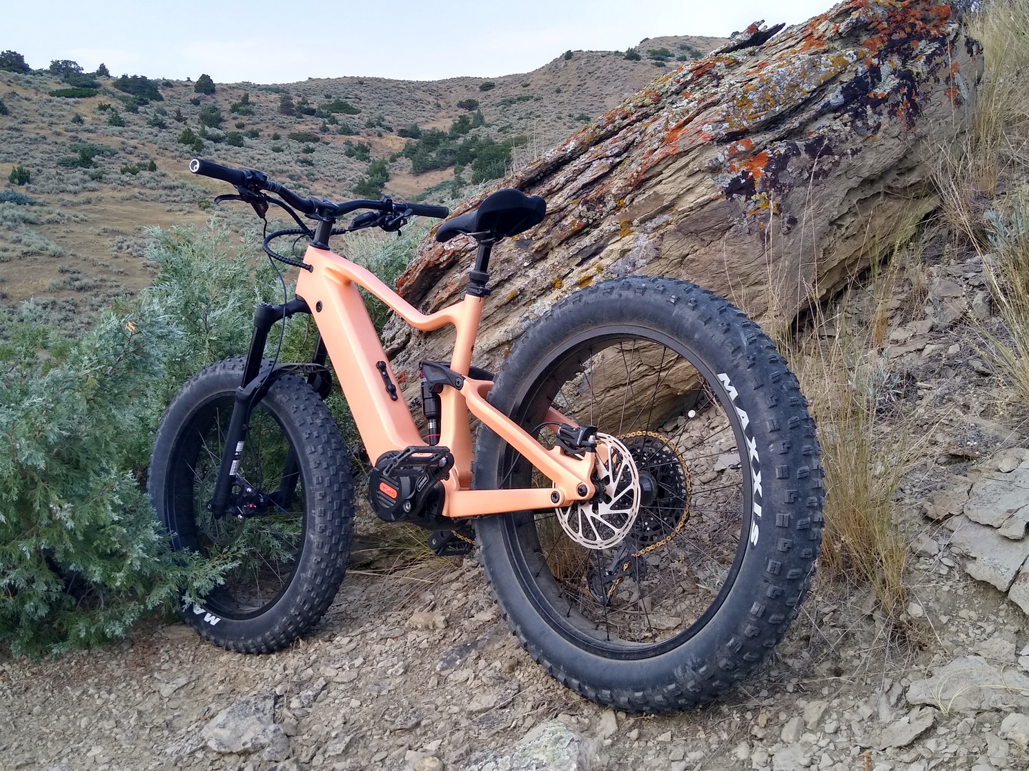

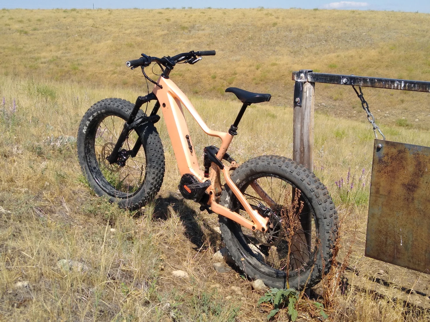

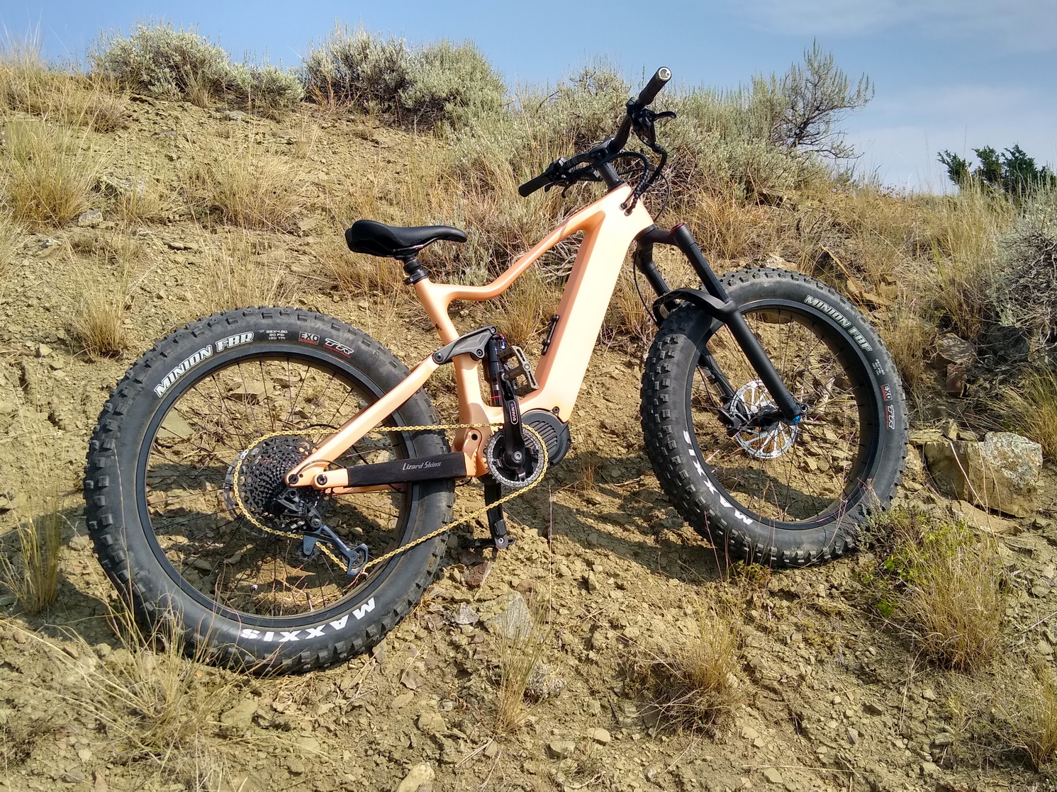

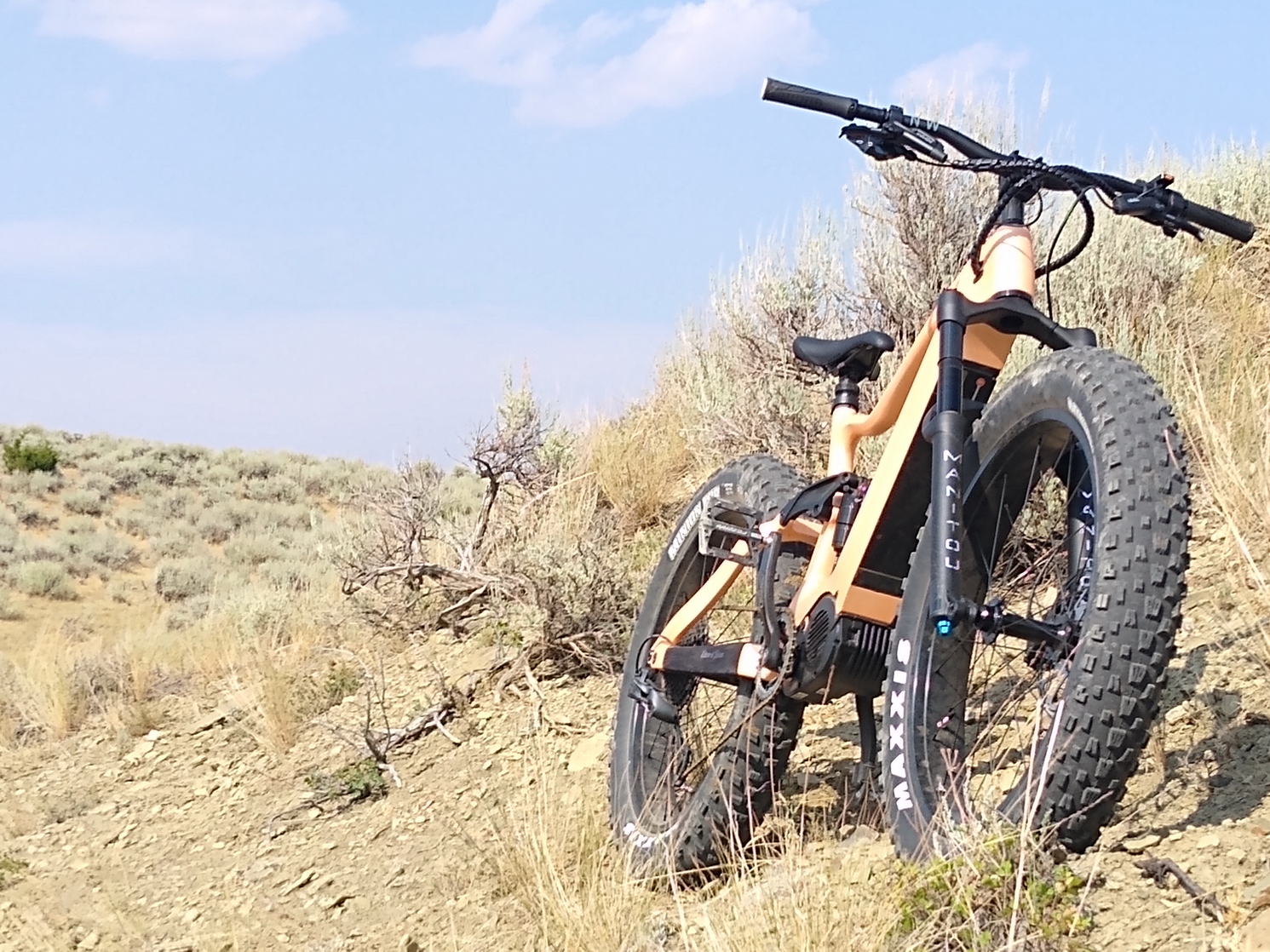

I put quite a few miles on it in its intended habitat:
The bike exceeded all expectations. This thing covers rough ground FAST! I'm so glad I didn't opt for a hardtail--ground that feels really rough on a full suspension manual bike, becomes really, really rough when you're blasting over it at twice the speed! Oh, that reminds me, I forgot to mention another mod made before this trip:

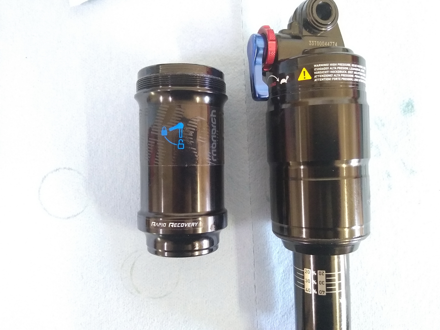

I had told myself I wasn't going to spend big money on shock for this bike (most were out of stock anyway), but found the stock a bit harsher than I expected. So I threw a Debonair can on it and all is well--it's very plush now, a big improvement and quite cheap. Anyway, it worked great as did the Mastodon as expected.
The motor was a monster. I have it tuned similar to the "Frey Smooth" tune and did 90%+ of my riding in PAS 3 out of 5--there's certainly no need for 9 levels with that tuning. Very controllable over slow, technical stuff and yet plenty of power for pretty steep hills. I was averaging between 20 and 25 watt hours per mile for most of these rides, which puts the useable range at about 30 miles for this type of use. Most of these were hard rides and I was pedaling hard (read going like a maniac!), I'd expect better than that under more casual use. It was only the crazy-steep slopes where I felt better upping it to 4 or 5.
And by crazy-steep, I mean CRAZY STEEP! slopes. These are slopes that would be un-rideable on a manual bike. I was amazed at how this thing could climb. Slopes where I'd be flipping over backward and/or spinning out on my manual bikes I was able to charge right up.
There are several reasons for this--obviously it has more weight on the front with the motor and battery biased toward the front, this helps keep the front tire on the ground. Second, this frame as a nice, long chainstay which helps a bunch. And finally, with enough motor power, since I didn't need to be in optimum pedaling position, I was able to lower my seat and crouch forward, significantly lower the CG of the bike in a way you just can't on a manual bike.
That all adds up to the ability to climb slopes that just can't be climbed on a manual bike--not even close. This means I can go places on this bike no bike has ever gone before....
I found the throttle a lot more useful than I thought it would be. Heck, I thought I might take it off when the bike came...not now! It turns out many "trails" I had walked and ridden horseback my entire life have sections that just can't be pedaled. Be it sagebrush grabbing your feet, really deep ruts or really steep sidehills...there are many occasions where you simply can't pedal. The throttle is a great tool to get you through those sections. With stock programming it's quite jumpy though. I found putting it in current mode and power to go with your PAS made it much more usable.
The big FBF/FBR actually did better than expected. This is the most time I've spent on 4.8's in summer conditions and I have to say they did OK. Certainly not "sporty" handling, but they weren't quite as slow and clumsy as I had feared. And they had tons of traction obviously, even through some muddy water crossings. While not my first choice, I have to say they'll get the job done, especially for "transportation device" type of use. If not the best for any one thing, they're certainly capable general use tires.
So all in all, the bike worked very well for the terrain I got it for. It's an extremely capable and very fun tool to have on the ranch.
