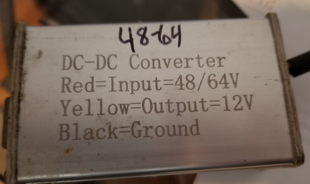

Here is the pic of the converter I have removed from the bike. It is an older GIO - I don't know the model or year.

At this point, I have not moved the escooter. It is just sitting on the kick stand. I was told by a technician that when lights go, it is usually the DC DC converter - so my question is how can I check? Is there something else I am missing that I could check? A picture of the converter is attached.

Most people use a voltmeter to test whether a DC-DC converter is working. It's pretty hard otherwise.
Yeah I'm finding that testing the actual unit is beyond my simple knowledge of this thing. I suppose I could open it up and test that way but after testing the front signal right turn, it was outputting a voltage of 0.025. My guess is that is not very much. Going to test other lights today but I'm thinking I need a new one. But what do I look for when purchasing one?
I just ordered a new one today, this way I can start eliminating possibilities. If it works, than great - if it doesn't. More research has to be done.
