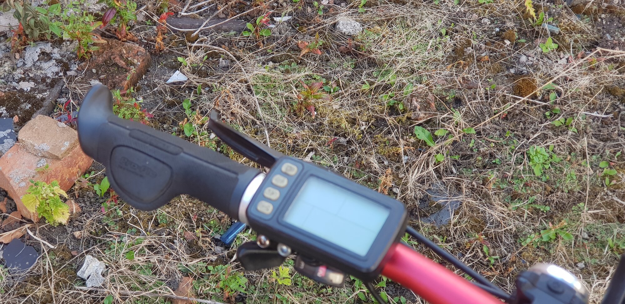

I feel your pain @DavidRu.
For me, I had to hunt down the L6 Display which enabled me to increase the speed limit on my NCM Moscow 29er.
