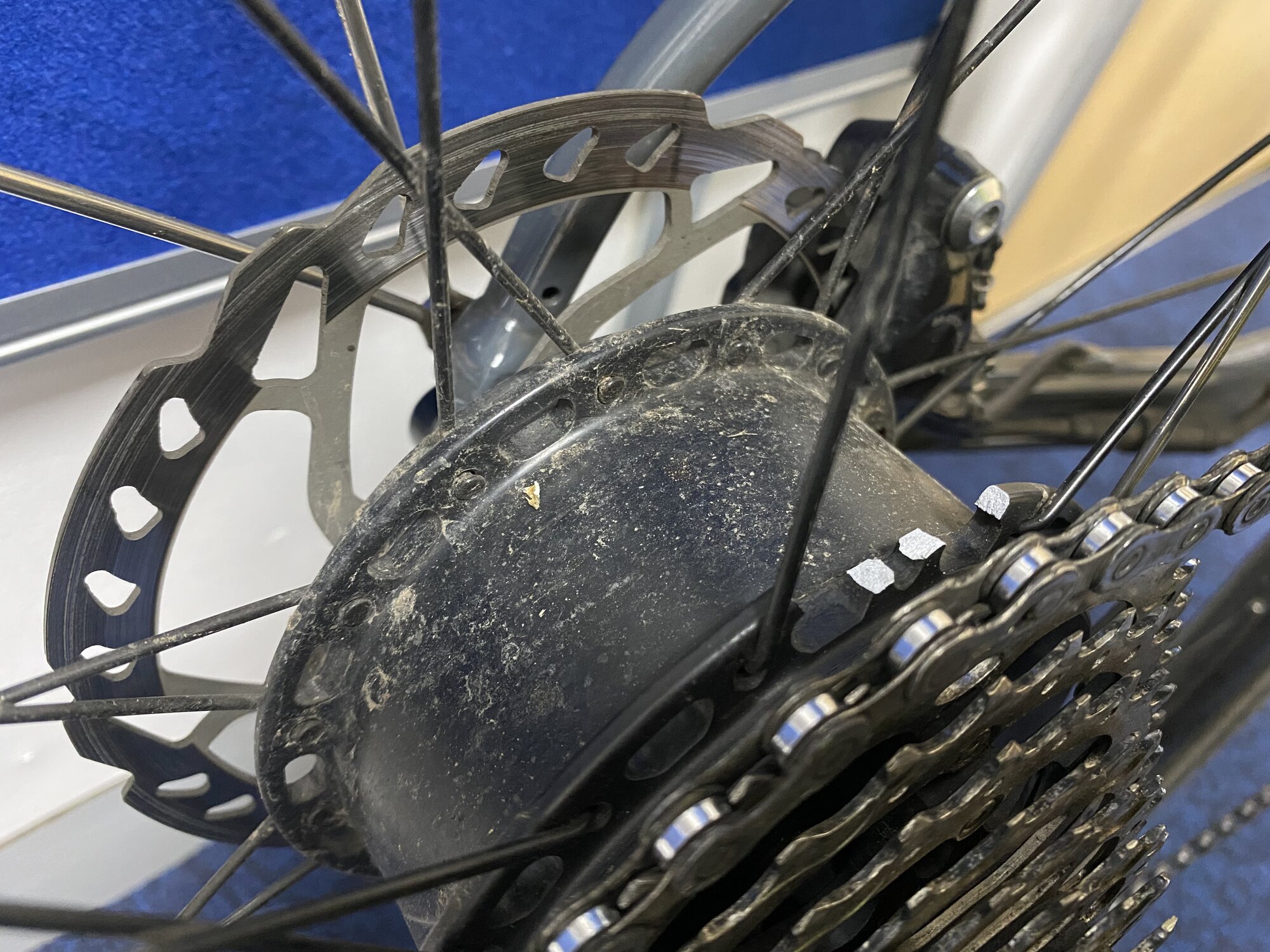

Hi,
my x35 rear hub motor casing has broken where a spoke was seated and now I can’t use my Ribble SLe and am gutted.
I have contacted Ribble but they have still to get back to me.
The bike has only done 2k miles and never been in crash or dropped. I am at a loss to know why this has happened other than a defect.

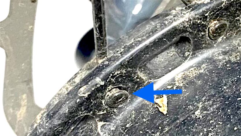

Hi - EXACTLY the same thing has happened to my bike this morning - have emailed Ribble pictures (as shown)and awaith their reply.....how long did it take for Ribble to respond and replace your wheel @Harryfernagh ?View attachment 60219

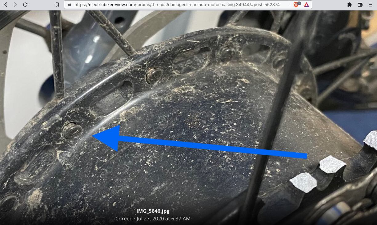

I'm noticing an issue with spoke across from broken spoke casting.
The head of spoke is not seated square in the hole, and looks tweaked at it's bend
to not able to seat squarely.
So this should be tested, but would make me look 180 degrees from point of this spoke to face of rim
that may show impact impression. Or the spokes were the wrong spec for this hub.
Putting too much stress at edge of spoke hole at point of bend in spoke.
Removing this spoke will surely show stress worn deep into face of hub.
