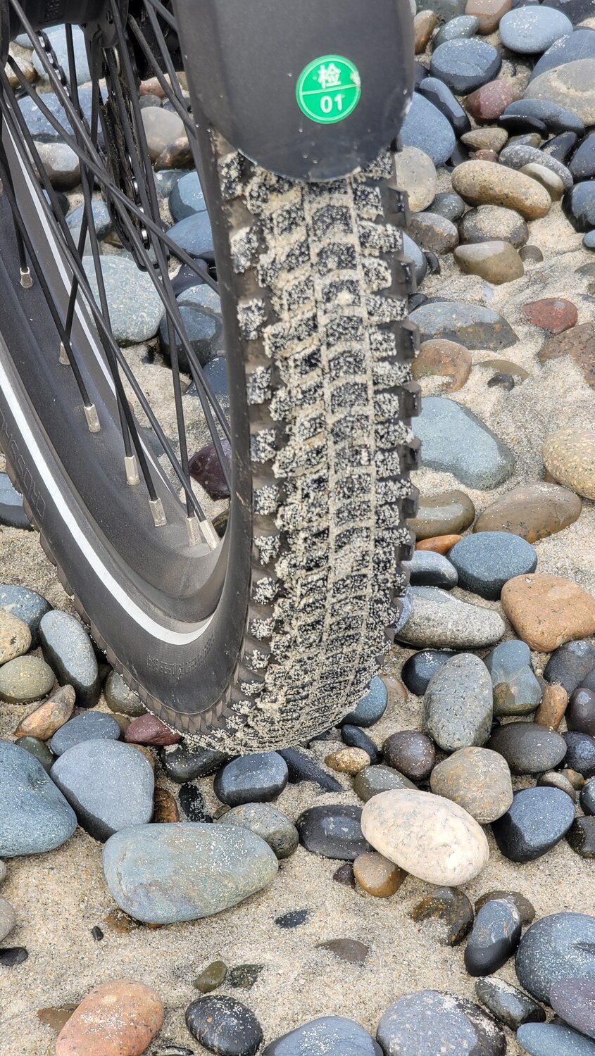

I think you'll want hybrid tires with good puncture resistance for your intended riding. Hybrid in this context means reasonable rolling resistance on pavement with decent traction on gravel.
Hybrid tires generally have low center treads with higher side lugs. My bike came with commuter tires. I had the dealer swap them for the hybrids shown on assembly, and I'm really glad I did. You don't need full-blown MTB tires.

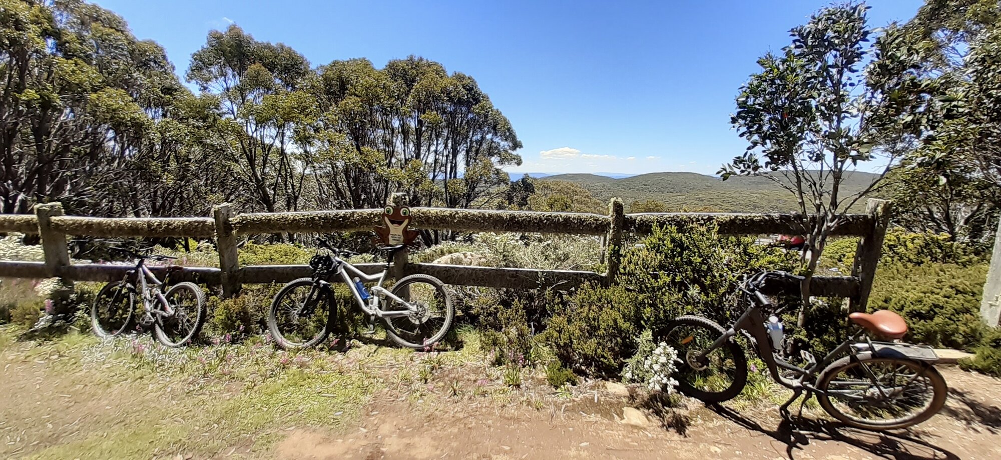

I notice you mention how much fun your bike is , and I totally agree. Part of the reason we haven't moved to a scene vlt is the extra weight will take away some of the fun. My wife rode a front hub converted version of her scene, and once the novelty of zooming along under throttle wore off , she started to notice the bike was heavier and she felt less comfortable. She doesn't like the power delivery of my giant, and my specialized SL doesn't produce enough power to justify the extra cost / complexity for her.
We've tried a couple of alternatives to keep her happy on the scene - my preferred option is to ride beside and lend a hand - literally pushing a little on longer hills. I used to have a retractable tow line on my seat post, it was great for towing young kids up hills ( and later for them to tow me ) , Not safe in traffic. Ultimately, saddle comfort limits endurance more than legs, so we enjoy social cruising for what it is.
