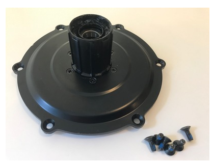

Thanks, I'm glad you found the post useful. I got the parts from greenbikekit.com and they are genuine Bafang replacements. They are in China and it took about 2 weeks for them to arrive. Here are the details:
Bafang fatbike motor RM G06 cover with cassette base
rmg06-cst-cover​
1​
$33.00​
Original Bafang SWXK/BPM/SWXH/SWXB/SWXP/SWX02/fatbike RMG06 motor clutches/platenary gear set Please choose motor model for the clutch SWX02/RMG06/fatbike motor 250W/350W/500W​
8fun-clutch-swx02​
1​
$23.50​
My bike uses the SWX02 motor. Shipping was $21.02. Greenbikekit was responsive and shipped quickly. I think they will be a good source for e-bike parts!

I ordered the Bafang part pictured above, and the cassette nut tool from Hilleater; and a chain whip via Ebay. The cassette nut that came with the chain whip worked fine. A trip to H-Freight for the torx bits that are "hollow" for "security" torx screws was necessary. Cleared the problem no noise after 20 miles. Couldn't see anything wrong with the old part but did not try to take it apart.
