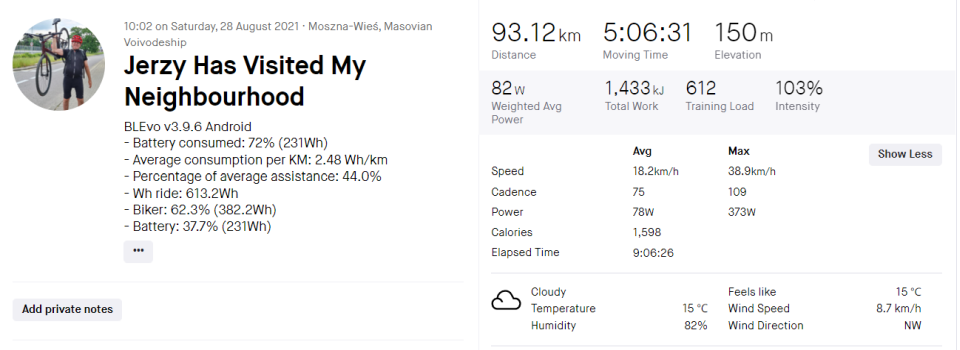

Dave, not sure if this will help you but I looked to my stats. If the SL motor is ridden at average assistance of 45/45%, the battery consumption is 4.0 Wh/mi (no hills). If you want to leave the 20% of the main battery at the end of the ride, you could use 320 Wh * 0.8 = 256 Wh, giving you the practical range of 256 / 4 = 64 miles. However, a significant elevation gain or headwind on your trip might leave you with a flat battery. Are you taking the risk?
You could of course ride with Smart Control set to your planned distance, elevation gain and declared 20% of the battery left. SC is disappointing at the beginning of the ride though.
57.9 mi, 490 ft elevation gain, avg assistance 44/44%, 28% of the battery left. No wind. Slow average speed.
