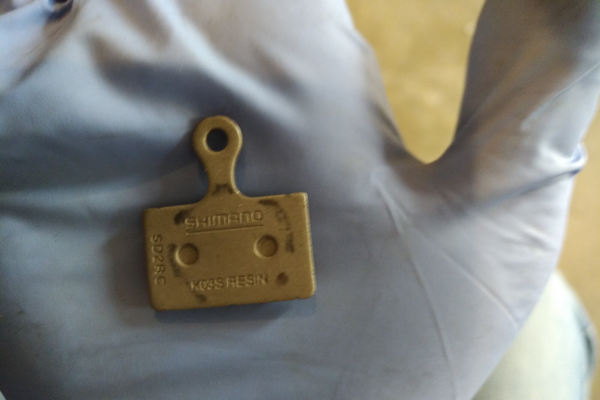

I hope this is not a derail. I've got about 2,200 miles on my Aluminum Creo. I don't hear any of the sounds that suggest the pads (or rotors) are in need to replacement. But I find that applying the left brake seems to come up short on stopping power. The bike actually keeps moving forward almost as if I have not been squeezing that brake much at all. I don't know if it is because I'm a Lefty or just habit but that is the one I tend to grab in quick response mode. I'm not that accustomed to disc brakes so don't really know what to expect.
Any thoughts? The local bike shop is kind of backed up for servicing.

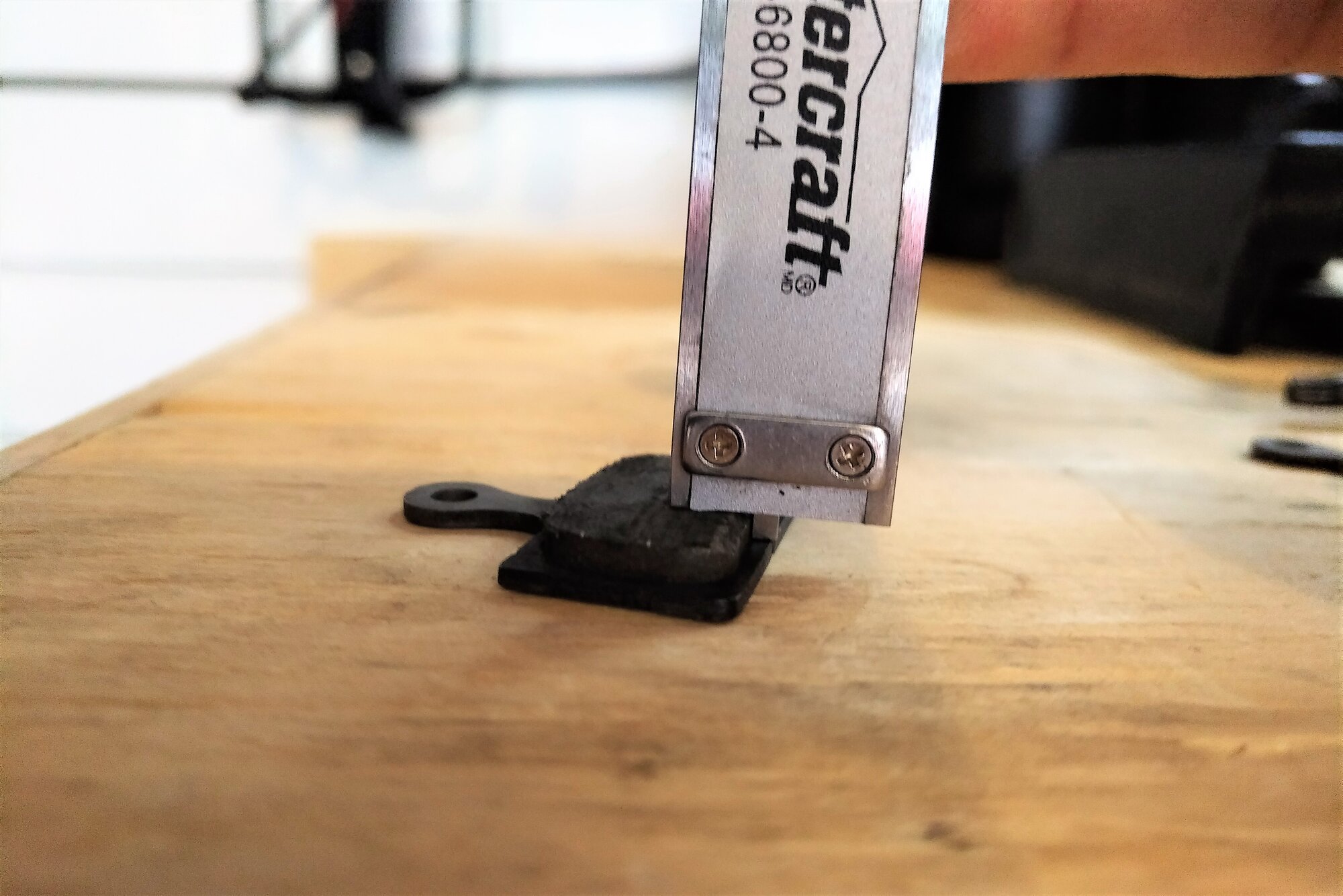

I checked the brake pads on my Creo EVO CC last week. Just pull the wheel and check the thickness of the brake pads. If they are over 1 mm thick (equal to about 3 business cards thick) they are good. If your brake pads are OK you probably just need to adjust the tension in the brake cable. Park Tools has videos on checking and adjusting brakes as well as how to replace the pads.

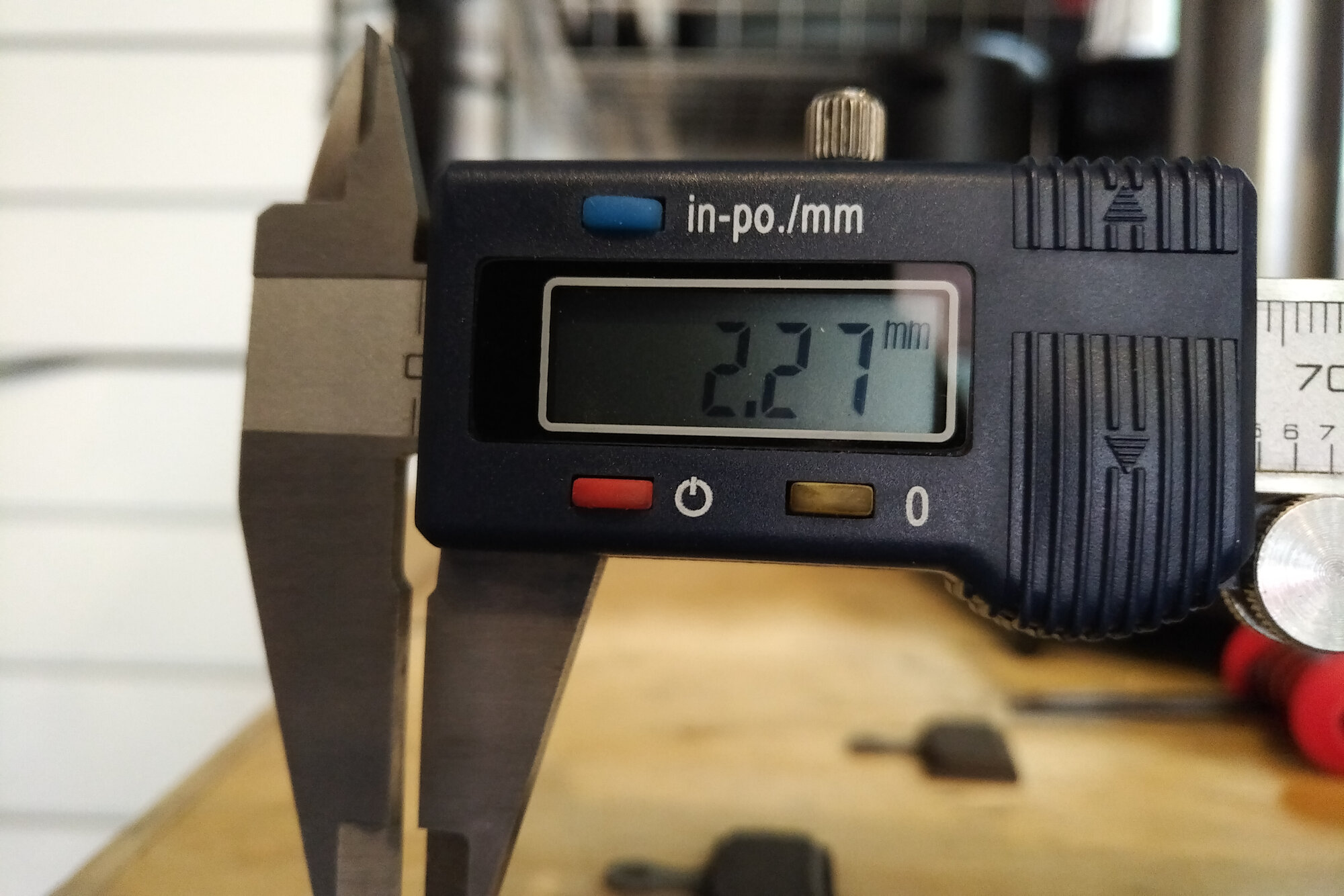

As @JeffC57 suggested, pulling out and inspecting the thickness of the pads is pretty easy to do. Having a digital caliper on hand will provide an accurate measurement.

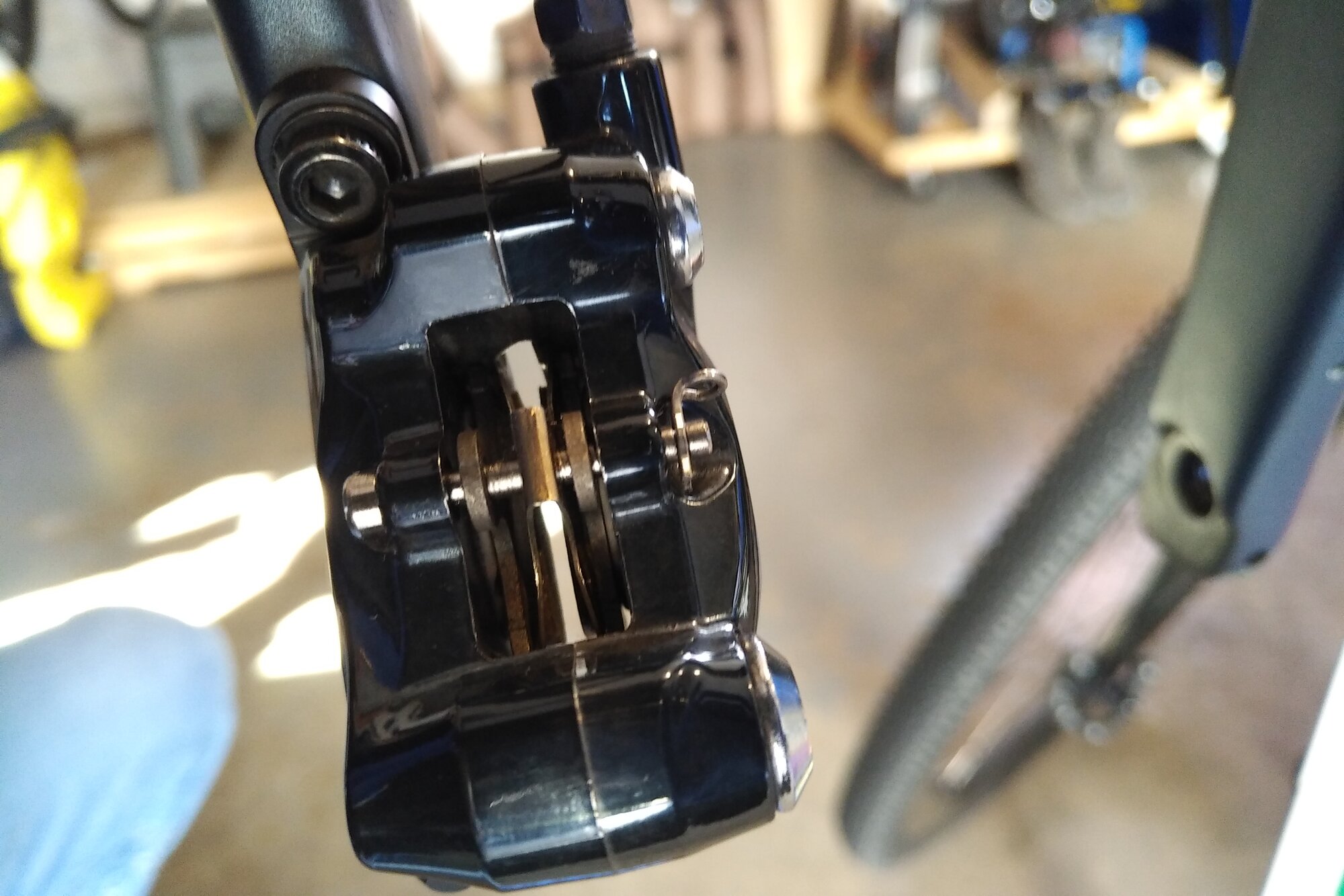

In the case of the Creo's Shimano (Ultegra/GRX) brakes, it’s simply a pad pin and retention clip.

@Prairie Dog - so one can just unscrew the pads and measure? I've got this nice cheap plastic caliper!
@JeffC57 - I'm gathering business cards as we type... (one from my eye doctor, one from a gate company (gift for family expecting a new child) and one from an artist)

Personally, I would probably replace the pads before they get down to 1.5mm. Yes, it's just a matter of removing the clip, unscrewing the pin and pulling out the pads along with the spring. Below is a tutorial on brake pad removal. I’m sure there are others out there but this should provide a general guide to the process. I use regular brake cleaner but don’t apply it directly onto the parts. Instead, I spray a bit onto a rag and use that to clean the dust from the pistons and caliper. Same goes with the rotors.
