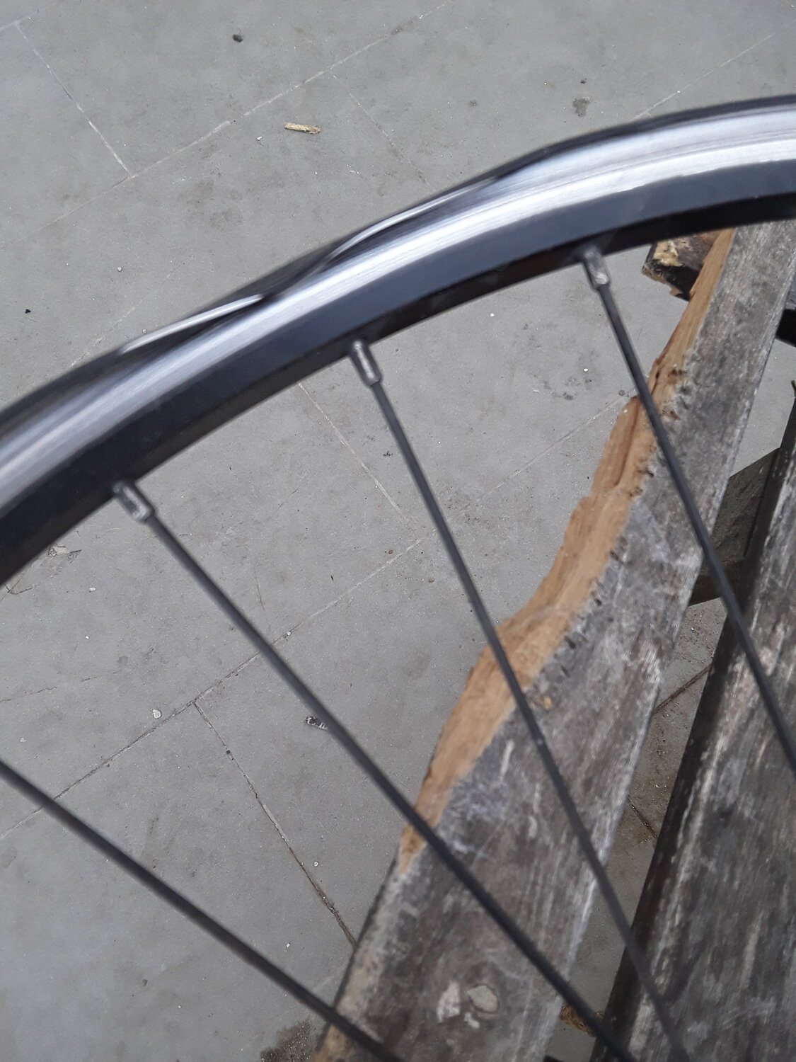

This is the front rim, the damage happened at the time.
The rear rim however was my less damaged, whenbthe inner tube exploded, but I had 3 miles to walk home, so by the time I got back, it is now more damaged.

Looking at that picture, my bet is that rim was damaged somehow (a rock, a pot hole, etc), and that damage was the reason the tire let go. This based on the severity of the bend, and the fact it's bent inward rather than outward.
It is difficult to see from this photo, but definitely blow outwards.
I did think someone had done it.
I dont know how.
But everyone seems to think it is a tyre, pressure issue.
