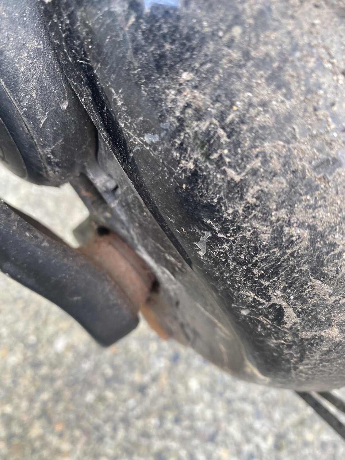

I just noticed the rust maybe because my bike just dried out the first time in days

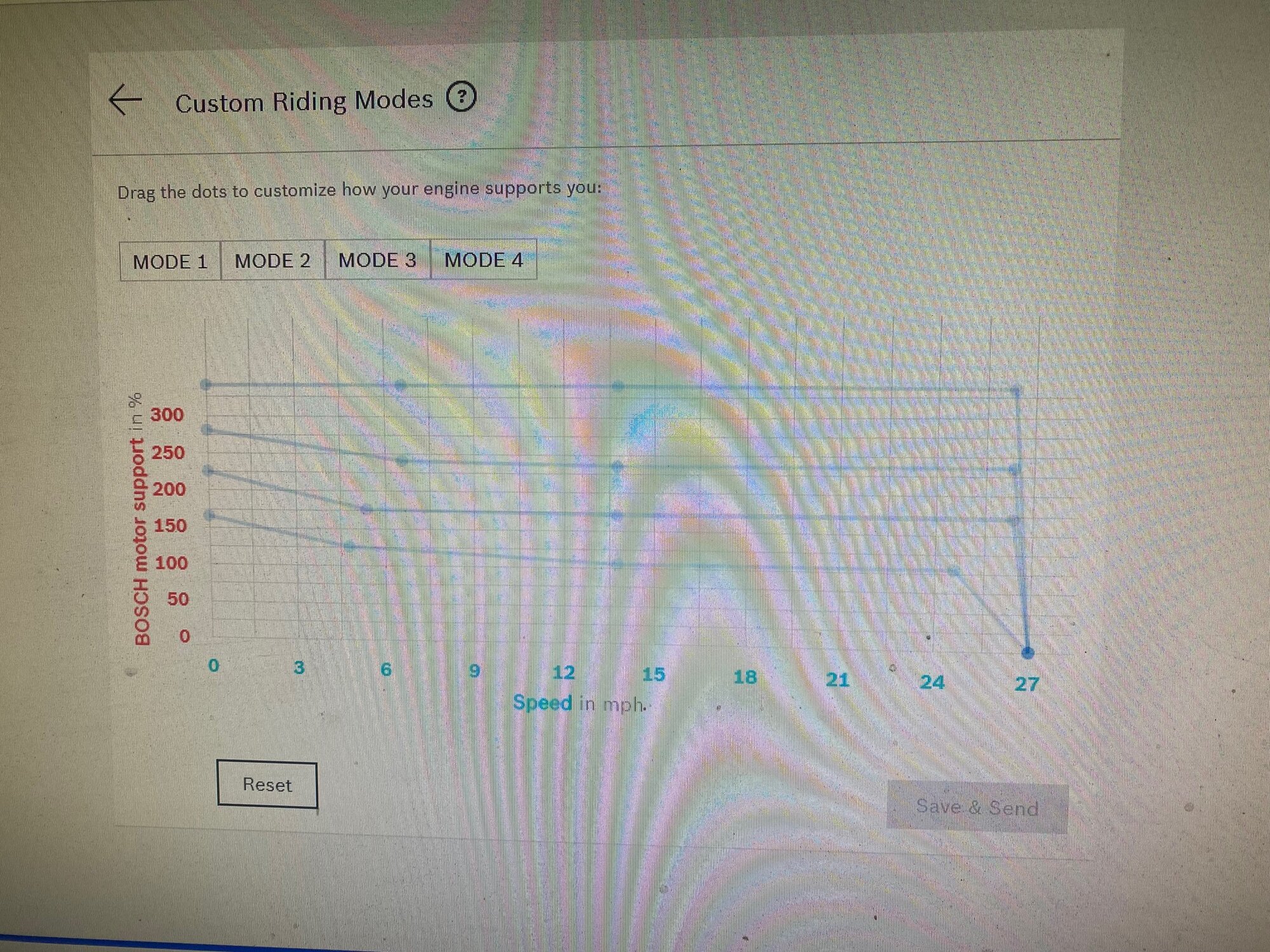

I put the lube Around it because its been squeaking like crazy. but the rust has ran down below the crank spindle the whole spindle was rusty with rust running down the motor housing. the problem was it has been wet for a bunch of days so I did not notice it till my bike dried out. I had noticed some kind of spinup sound for the last couple weeks when I pause and start peddling again. but was thinking it was just when I started using using custom modes again. I had the headset do the same thing so as soon as I saw it I knew the bearing was rusting. I took it to my local trek shop yesterday and the mechanic is going to talk to his bosch rep.Got any clearer pictures of the rust? Traditionally, there is no seal between the crank arm and the spindle interface of the drive unit.
no road salt here and this is the 3rd year of rain riding. but this is not a little rust and the bearting was dry as a boan and squeaking as it is so dry.A common thing around here this time of year. Plenty of road salt and water makes for lots of rust.
so there is no way to really repalce the bearing without it getting rebuilt? Plus if the seal failed could there be water in the motor? I ride in the rain sometimes twice a day this year we had a lot of rain but then its been dry for awhile.
portland Oregon. sometimes my bike does not dry out for days. thats why I didn't to notice the rust for so long till we had two sunny days and it fully dried out. so does the motor need rebuilt?There is a bearing replacement kit for that drive unit that replaces the drive side bearing. Riding in the rain is not an issue. All drive units rate at IP54.
What area of the country are you in?
I have a local trek shop and he is looking into it. no pressure washing ever but man the rain so much rain. I have 14,000 miles on the bike in 2.5 years.With the vision of the picture and reading your symptoms, I cannot speak to whether your DU needs service. I would refer to the local dealer in the area for service. The dealer has further resources with Bosch if further action or service is needed.
We have riders all over the country riding in all types of elements (couriers in NYC, riders at the beach) and the DU's should protect against elements like constant rain. I have 3,200 miles on an Active Line Plus DU that has been trashed in the rain and elements and is smooth and is smooth as new.
Pressure washing is the one area we see water ingress on a regular basis.
ya by the time you see the rust the bearing needs replaced.
Might be useful after the replacement at certain intervals.ya by the time you see the rust the bearing needs replaced.
yep.Might be useful after the replacement at certain intervals.

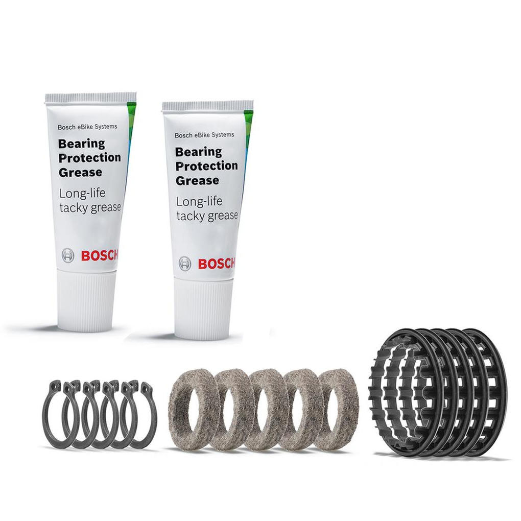

Yes I used it on on my connection and on the bearings after I found them rusted.And then treat it with some ACF50 anti-corrosion formula. Once or twice a year does the trick nicely, and it plays well with electronics. I use it on my motorcycles as well.
I think if you keep up the grease that comes with that kit i linked, it might be better/more compatible with any other chemicals Bosch use (the ACF50 may get inside and dissolve existing greases).Yes I used it on on my connection and on the bearings after I found them rusted.
