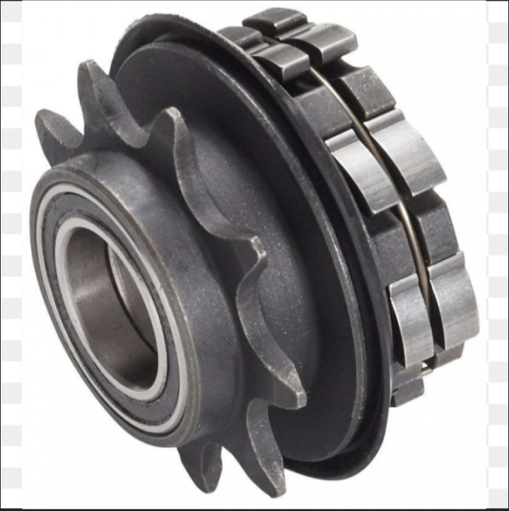

You've got a one speed, so your hub guts probably look like this,..
The spring loaded one-way ratchet pawls are binding and not ratcheting.
They need to be cleaned or lubed or replaced if they're damaged.
The wheel has to come off and the hub taken apart to get at the mechanism.

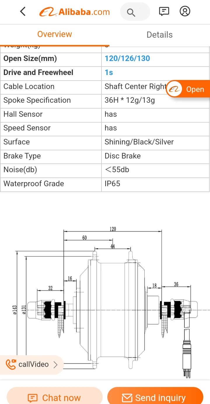

Thanks! This really helps clarify things. I found the part number for the hub motor and the entire unit is only $50 on Alibaba so it doesn't surprise me that it doesn't work optimally.
Seems like I'm just going to live with this minor issue, and then maybe someday upgrade the motor to a Bafang (recognizing that's a big project).

Your hub motor is fine.
It's the single speed ratchet assembly that attaches to it that you need to clean or lubricate.
It looks like that motor doesn't include the single speed gear??
You might be able to remove the wheel and just spray some lube all up in there to get it going again?
You'll make a big ole mess, but you can clean that up and maybe get it going without removing the single gear from the hub motor?

I found another picture that should help,..
That gear should spin freely in one direction and grab in the other direction.
When your gear is "spinning freely", there is so much drag that it pulls the chain and pedals with it and that activates your cadence sensor.

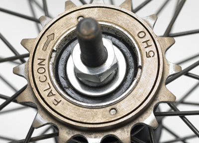

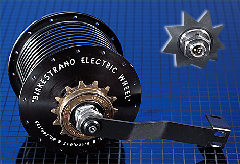

Here's some more pictures that should help,..
The freewheel/sprocket/ratchet assembly is probably threaded onto the hub motor like in this picture.
(Same idea, but you've got a motor instead of just an axle.)
You probably need special tools to unscrew your assembly?
We didn't have the special spanner wrench when we were kids, so we used a flathead screwdriver on an angle into the little hole, and pounded the Hell out of it with a hammer. 😂

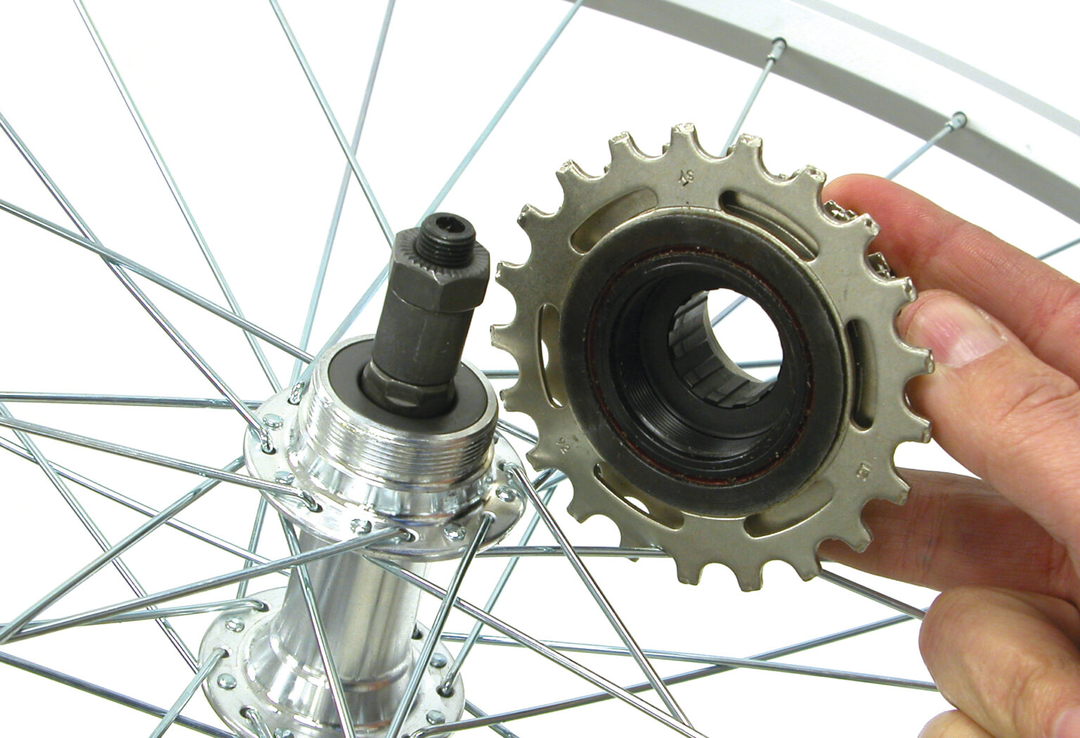

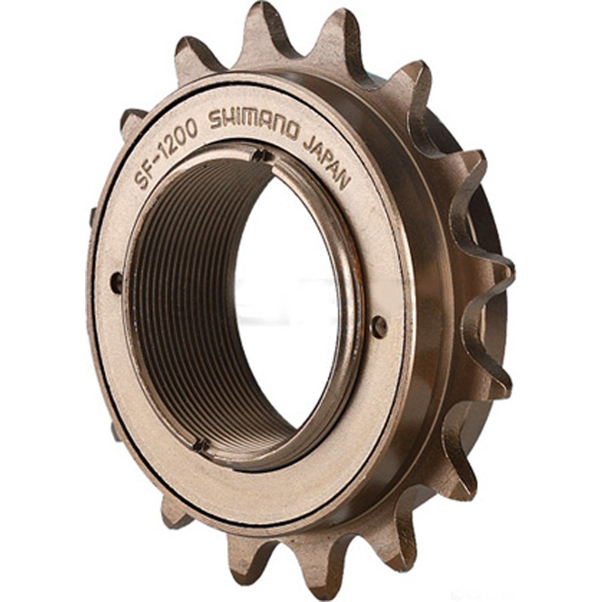

Again super useful. Any reason to not just replace the super cheap OEM freewheel with a still cheap ($30) Shimano 1200 freewheel?
Spending $30 for a better part seems like a much wiser choice than trying to service the crappy one.
