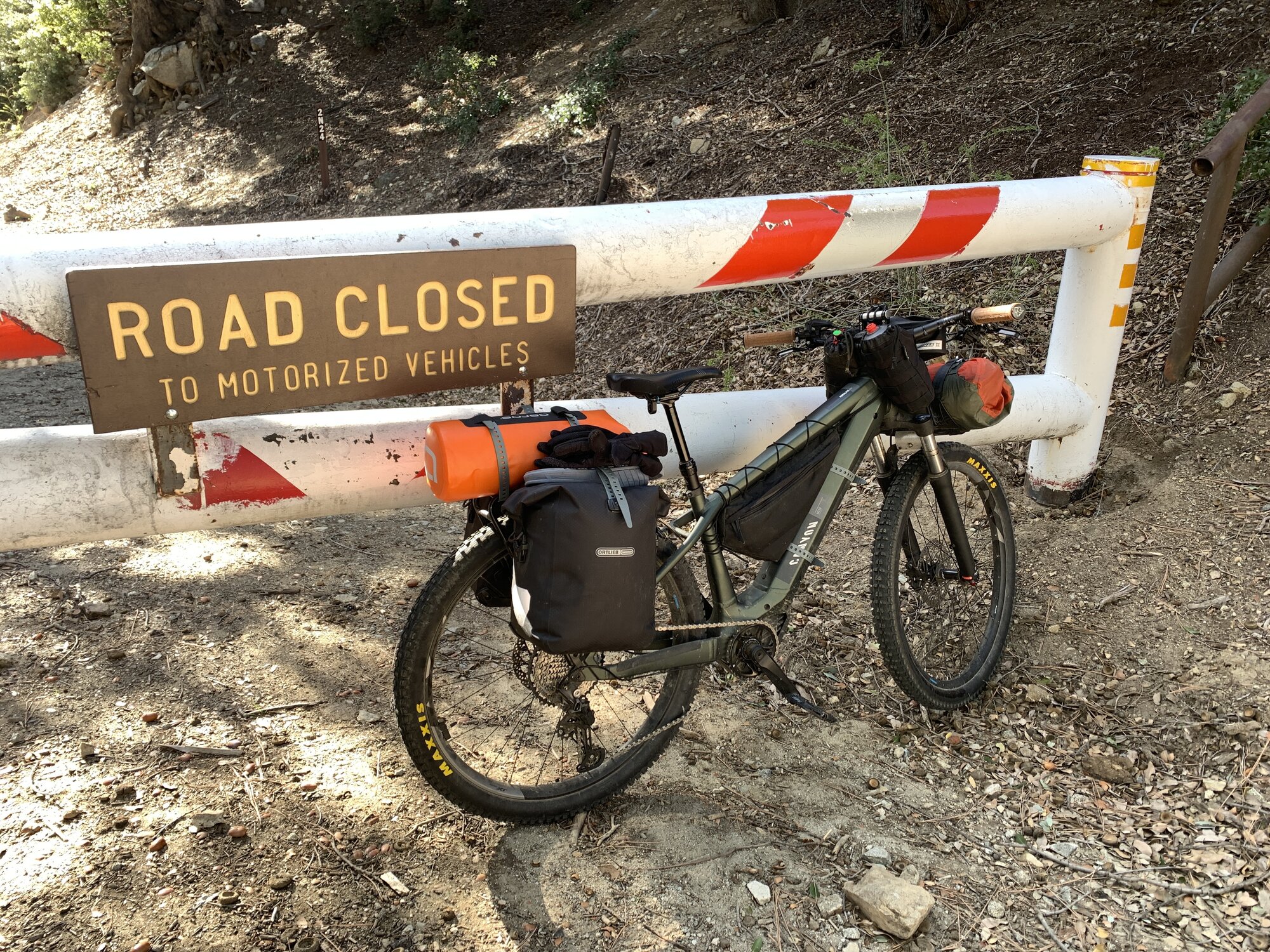

I set up my hardtail e-mtb for single or two night bikepacking. Overnight destinations are usually trail camps, off trails or fire roads. For less grueling rides, no long steep climbs, I’ll use my acoustic all terrain bike, my Ritchey.
