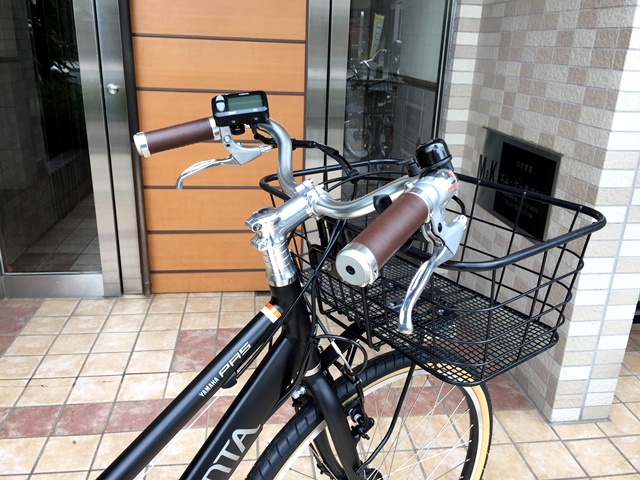

As my concern is about posture for the VIENTA5 due to the lower and more forward handlebar, I wonder whether it might be possible to add a stem raiser / use a stem with different angle / use a different handlebar, were posture turn out to be an issue for me.
This gives a detail of the part (from someone who changed the handlebar):
How does one investigate what kind of modifications are possible for a given bike?

I think it’s likely your bike will have a standard 1” steerer meaning you could fit any 22.2mm quill stem like these Nitto brand from Japan https://www.sheldonbrown.com/harris/stems/index.html#onethreadlessstems
It should be a simple swap and your bike shop should be able to source them if they don’t have a variety of different heights in stock. You could buy it from Rakuten but stems come in different heights so to figure out which height you like it’s best ask a bike shop to help you try out different stem heights.
If you want an adjustable stem, consider getting the Gazelle switch stem in 22.2mm that you can easily adjust the angle by lifting a handle, Again comes in different heights so find out what height works for you before ordering the corresponding stem

Following the suggestions I have been looking around, indeed it should not be too problematic to (have a bike shop) carry out the required modifications.
It would seem the bike shop can fit the bike. One thing about extreme changes is possibly not enough slack in the cables to raise the bars. Looks like they already used all of it on the Vientas being ridden by the gal in your link, and I would not bet on whether it's threadless/threaded.

@Nova Haibike, how did you figure out that the Vienta5 uses a threadless steer?
Because I am a professional bicycle technician and I can tell just be looking. ;) Beyond that, I looked at the bike's manual (page 33) to confirm it. As far as cables are concerned, the shop should be able to install longer one's if necessary to accommodate a taller stem and/or handlebars. It is not difficult.
