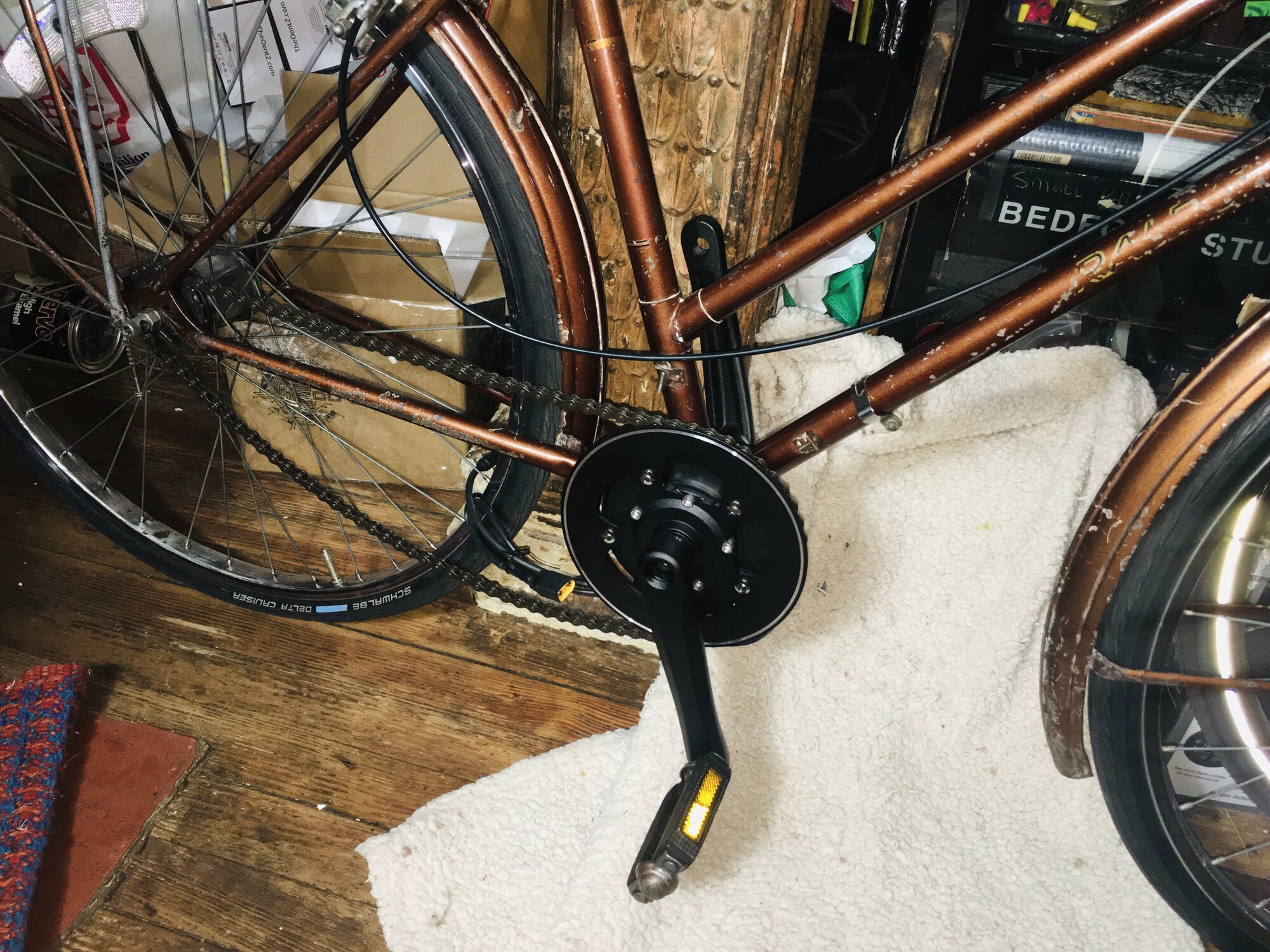

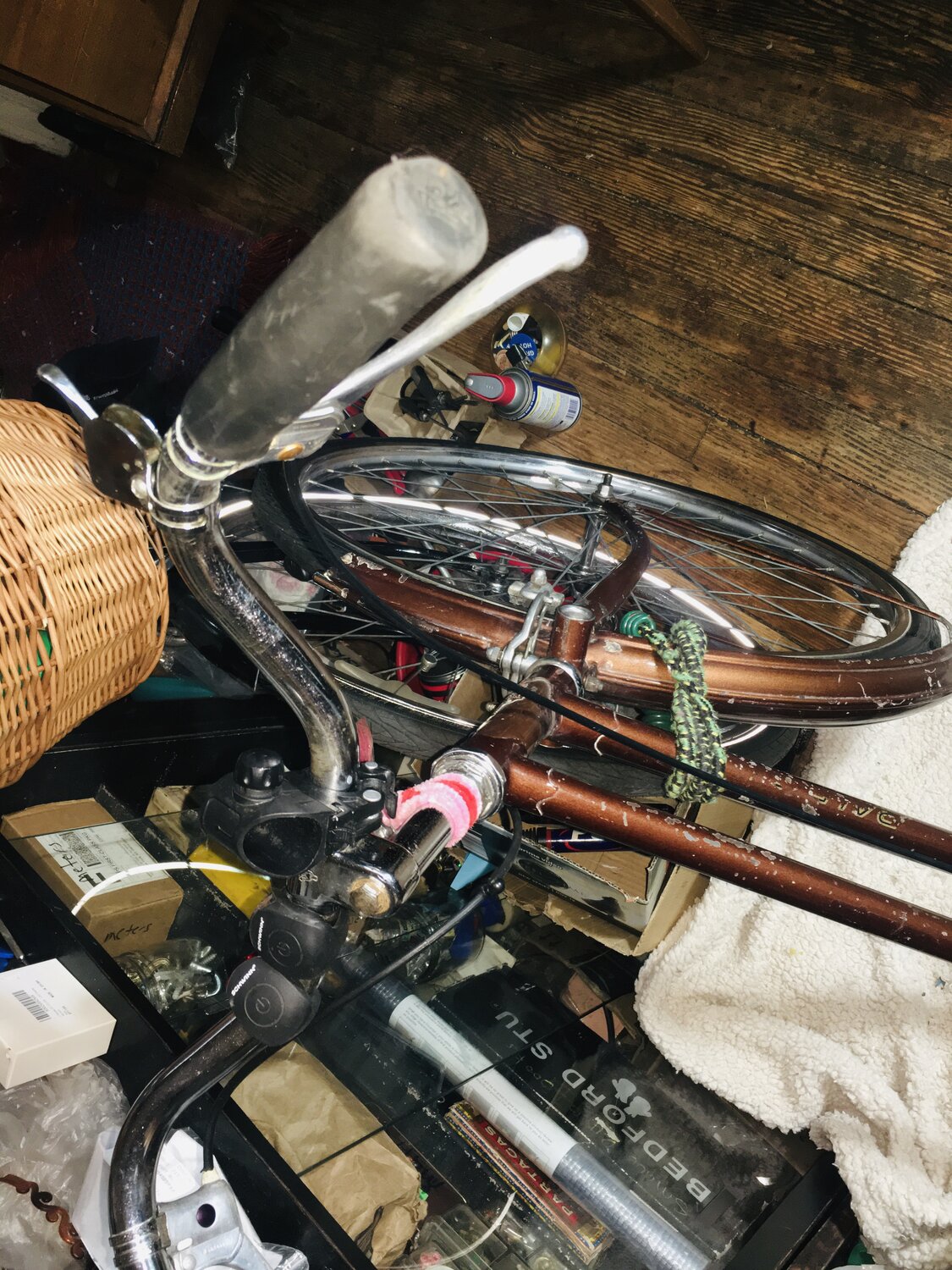

I have a 1970 era girls Raleigh Sport three speed that I'm converting to a Tongsheng E bike and I wonder what you recommend for a good cushy handle bar grip and seat for that matter. And how do you get those damn grips off without ruining them?

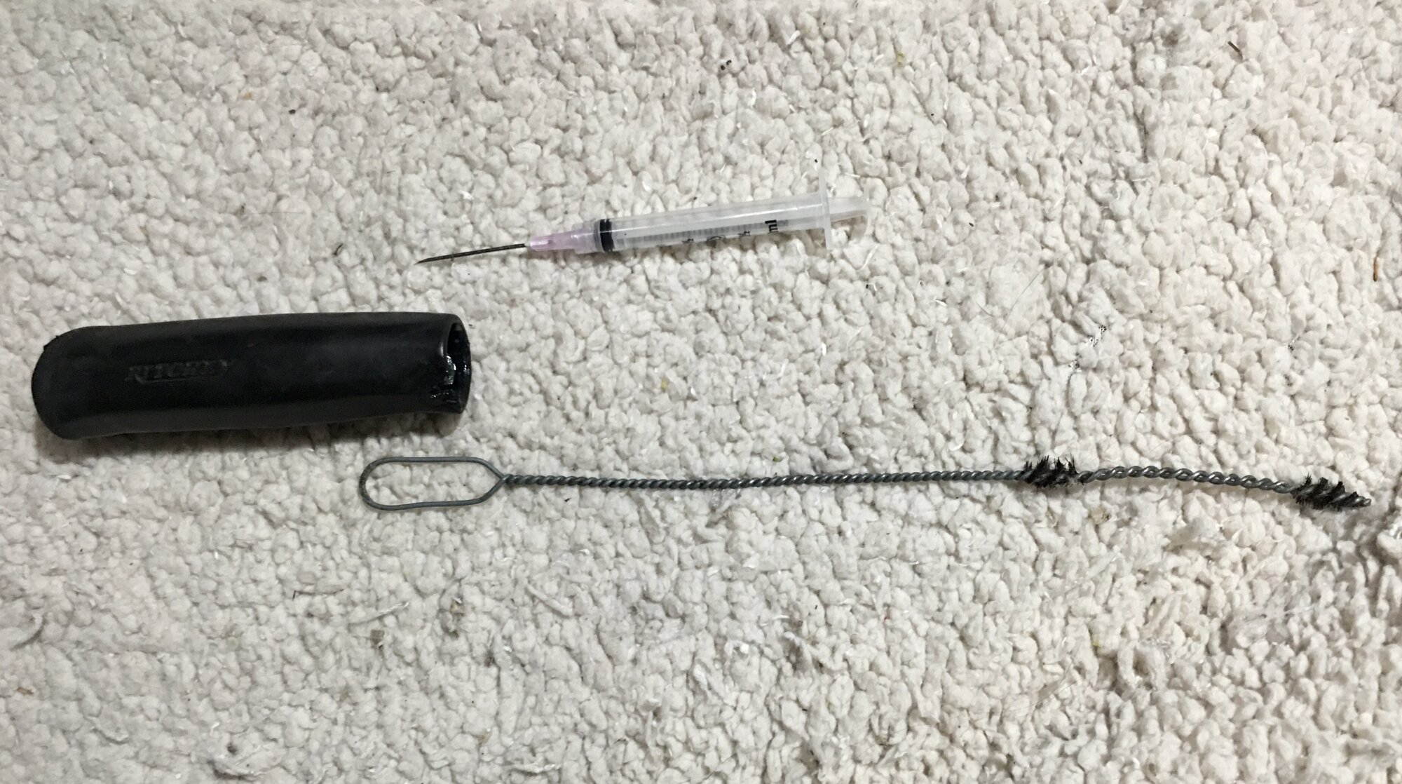

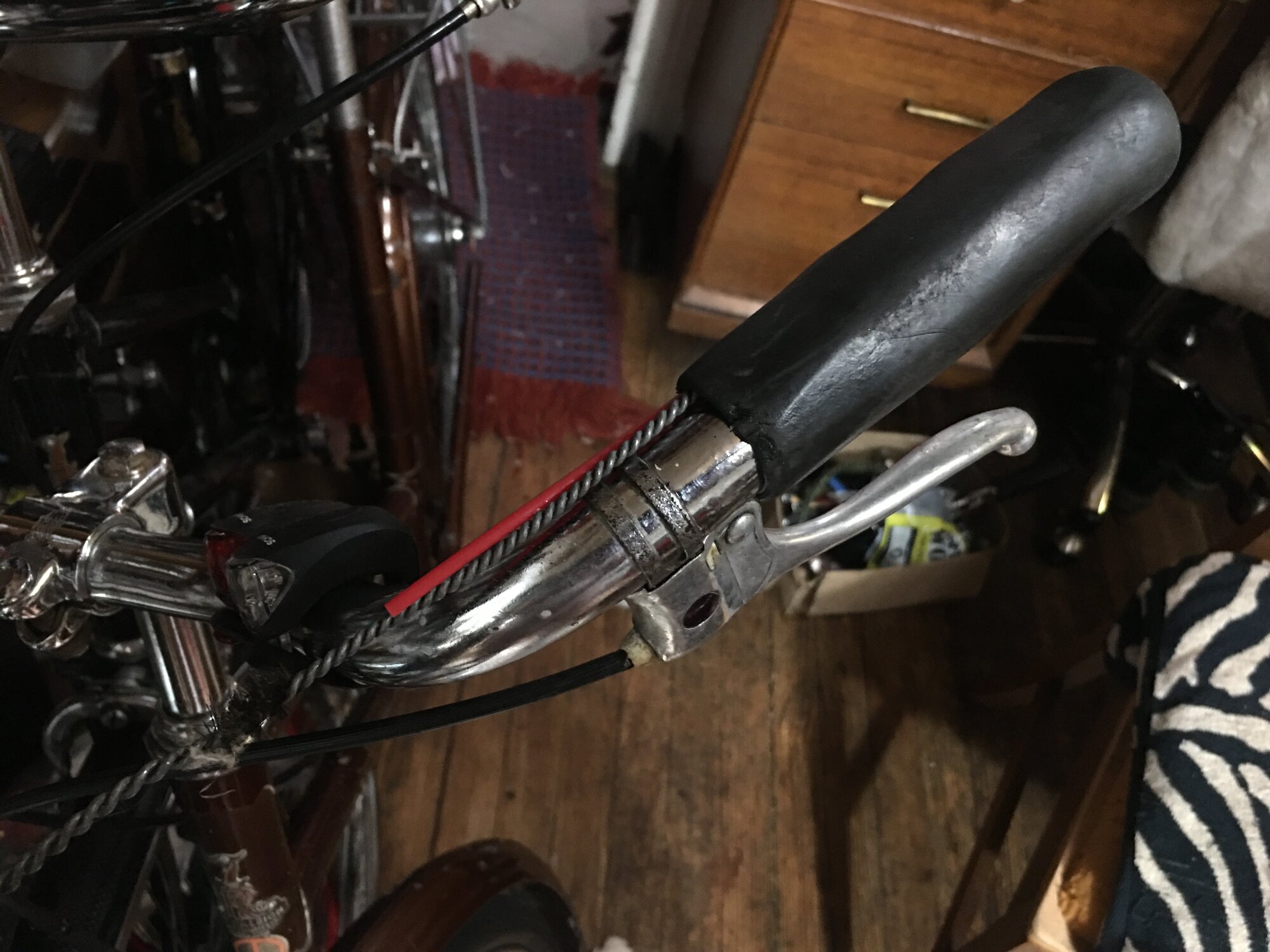

I just found an easy and clean way to remove your grips. I took a syringe filled with dish soap and water with a 18gauge needle. I slid it in all the way and squirted a little soap under it. Then I took the handle of a bottle brush and inserted in the same spot little by little you squirt and dance the wire handle. When the handle is at the end you remove the needle and twist the grip from side to side. It will free it up real easy!

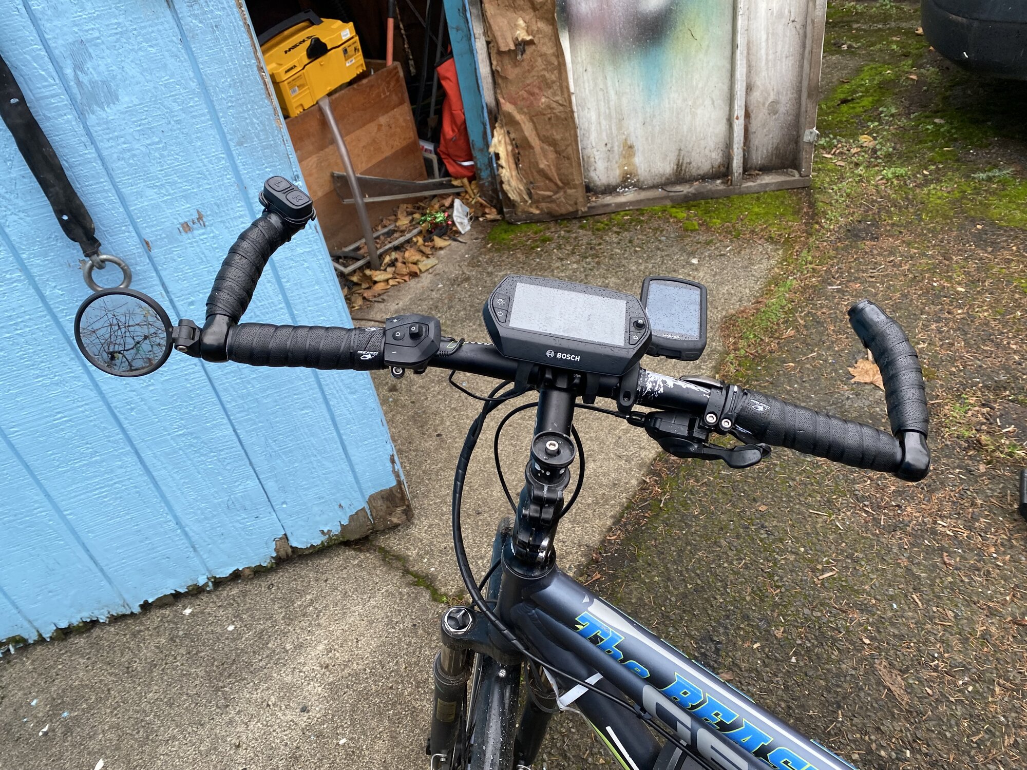

Questions about handlebar grips and saddles are such a subjective thing to answer cause what works for one may not work for someone else. Anywhooo..... after using the Ergon GP handgrips, I found them to be too hard and unforgiving after alot of miles on the road. Pictured here are the only grips and bar ends I'll ever buy: Ergon GA2 Fat handlebar grips. Thicker overall diameter and a nice, soft rubber to help absorb vibrations. They are long wearing. Not to be confused with the Ergon GP's, which are made of a harder nylon/plastic. Link: https://ergonbike.shop/collections/grips/products/ergon-ga2-fat-1

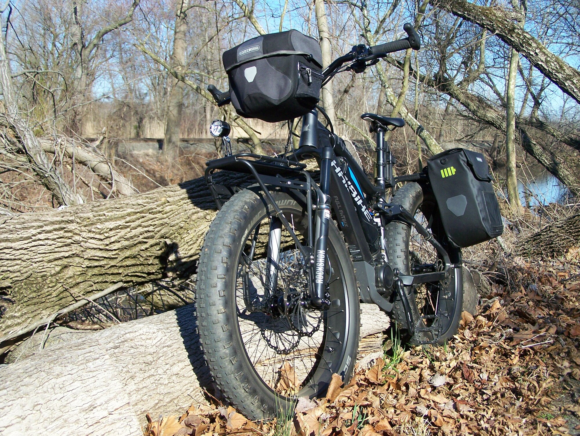

The bar ends that I have on 3 of my bikes, including this Haibike, are Cane Creek Ergo Control Bar End Grips. These things, unlike what @fooferdoggie shows, fits snug in the palm of your hand. Made of soft, kraton rubber, they take road vibes and hits with no problem. Having the ability to move your hands to multiple positions helps ease fatigue and aids in climbing hills, too. Link: https://canecreek.com/product/ergo-control-bar-ends/

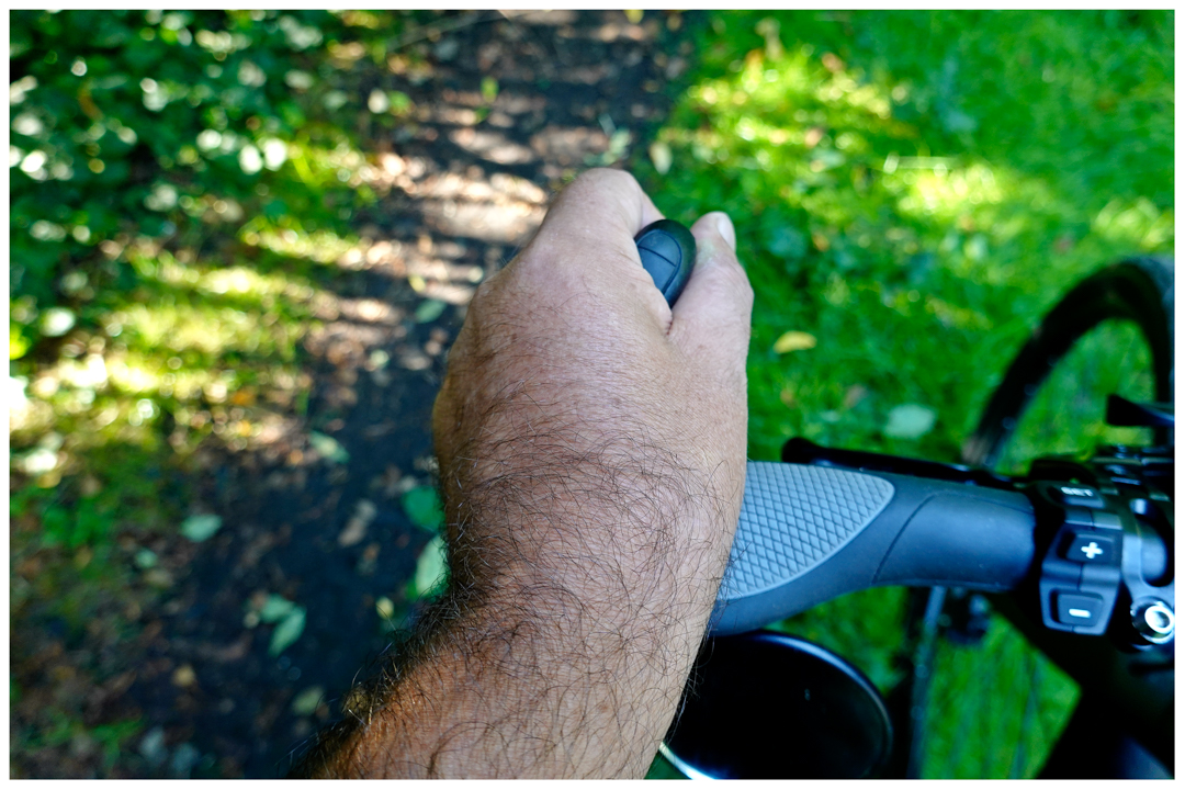

Multiple hands positions on a long ride. Ergon grips that are equipped with bar-ends are to be held as if the handlebars were a car's steering wheel. Meanwhile, you rest the part of the the palm below the thumb (cannot remember the English name) on the protruding part of the ergonomic grip. Your hand is very comfortable with that, you feel better control over the steering, and the riding experience is greatly improved.
One of possible hand positions on Ergon GP3 grip. Recently, I've come to like the GP2 even more.

Thats quite a great bike you have there.
