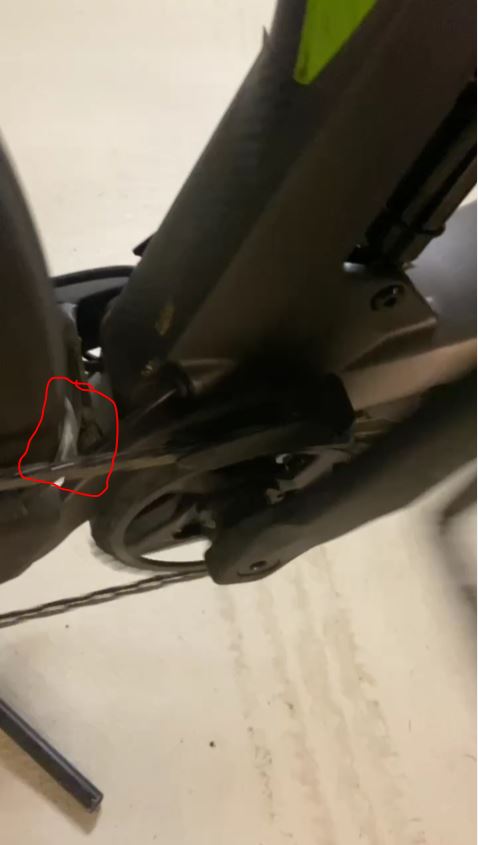

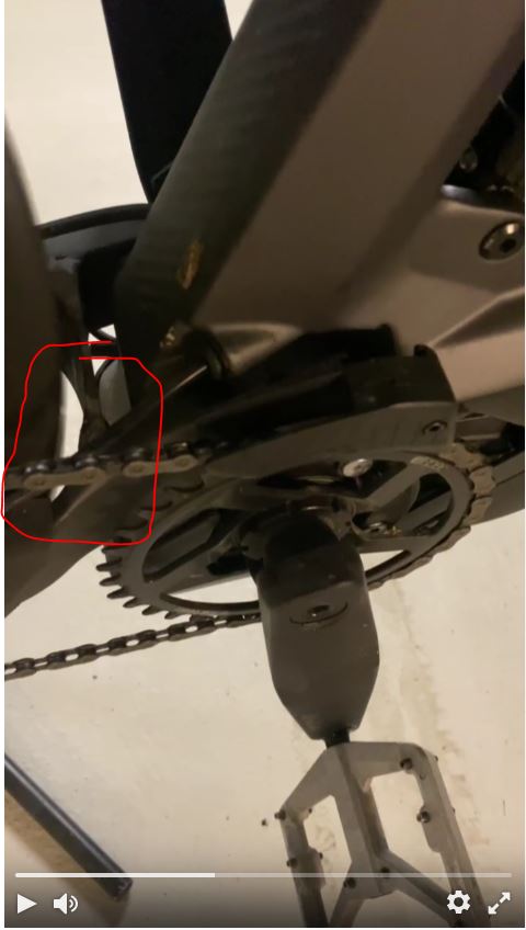

Just watching the first video...
I thought I could see something slap the frame around the chainstay area when the tyre rotates...
It's not perfectly clear in the video but a flash of black is kind of noticeable for a fraction of a second every time the wheel rotates. Not long enough for me to be able to pause the video on it - and its harder to see when wheel spins faster, but I wonder if this is causing the slapping/clicking sound. Maybe worth checking if anything is caught in your tyre...
You might be able to see what I'm talking about below...
