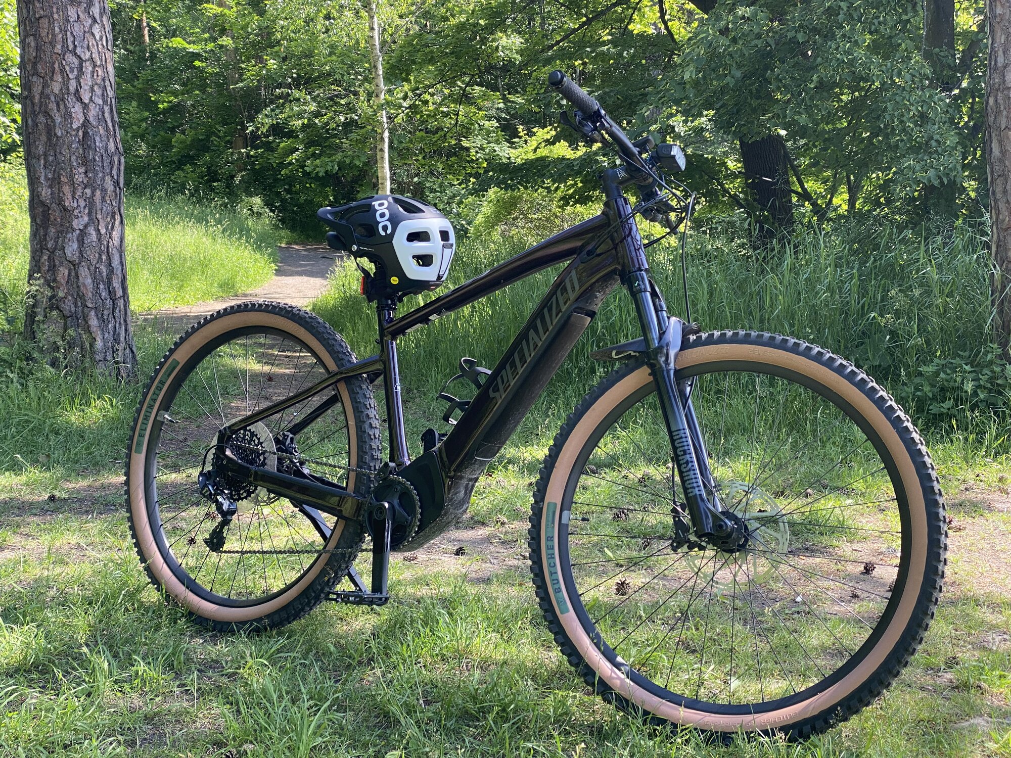

I'm pretty much satisfied with my Turbo tero 5.0 but it's impossible to charge a iPhone through Mastermind even when it's shown in the Mastermind ad.
When I put in the cable it connects showing a green light but after a couple of seconds the connection is lost.
It would have been so cool if this was possible but it's not therfore I'm surprised Specialized show and say it's working.

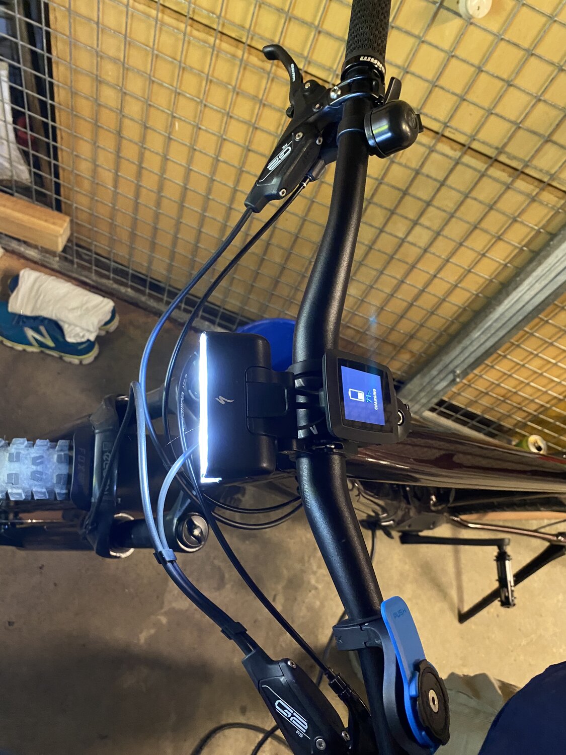

I have a Specialized Flux 1250 front light so maybe I can connect it to Mastermind I just have to buy the correct cable
