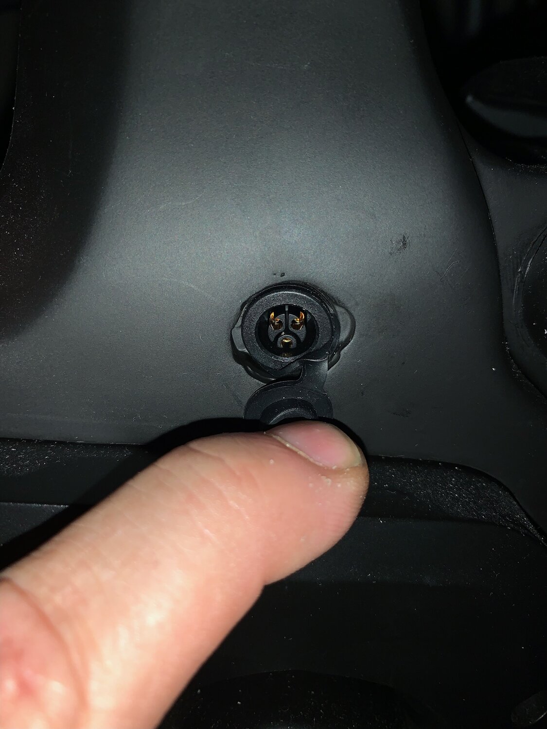

Charger Needed for my Hydra Fatty
Cuz Vinny
Need a charger that works with this port. My other Hydra has a small single hole for the charge port. Would like one that works with both bikes. Suggestions?
The connector is called an ST3
Thank you for posting the name of this connector! I'm pleasantly surprised to find it rated for 15 amps!
I called WW and Gregg wrote me up an invoice for a 3 amp charger for $50. No complaints here, but it is not programmable so it will charge to 100% and hold it. I just needed a travel charger I could fit in my bag, the 10 amp charger that came with my bike is a monster.
