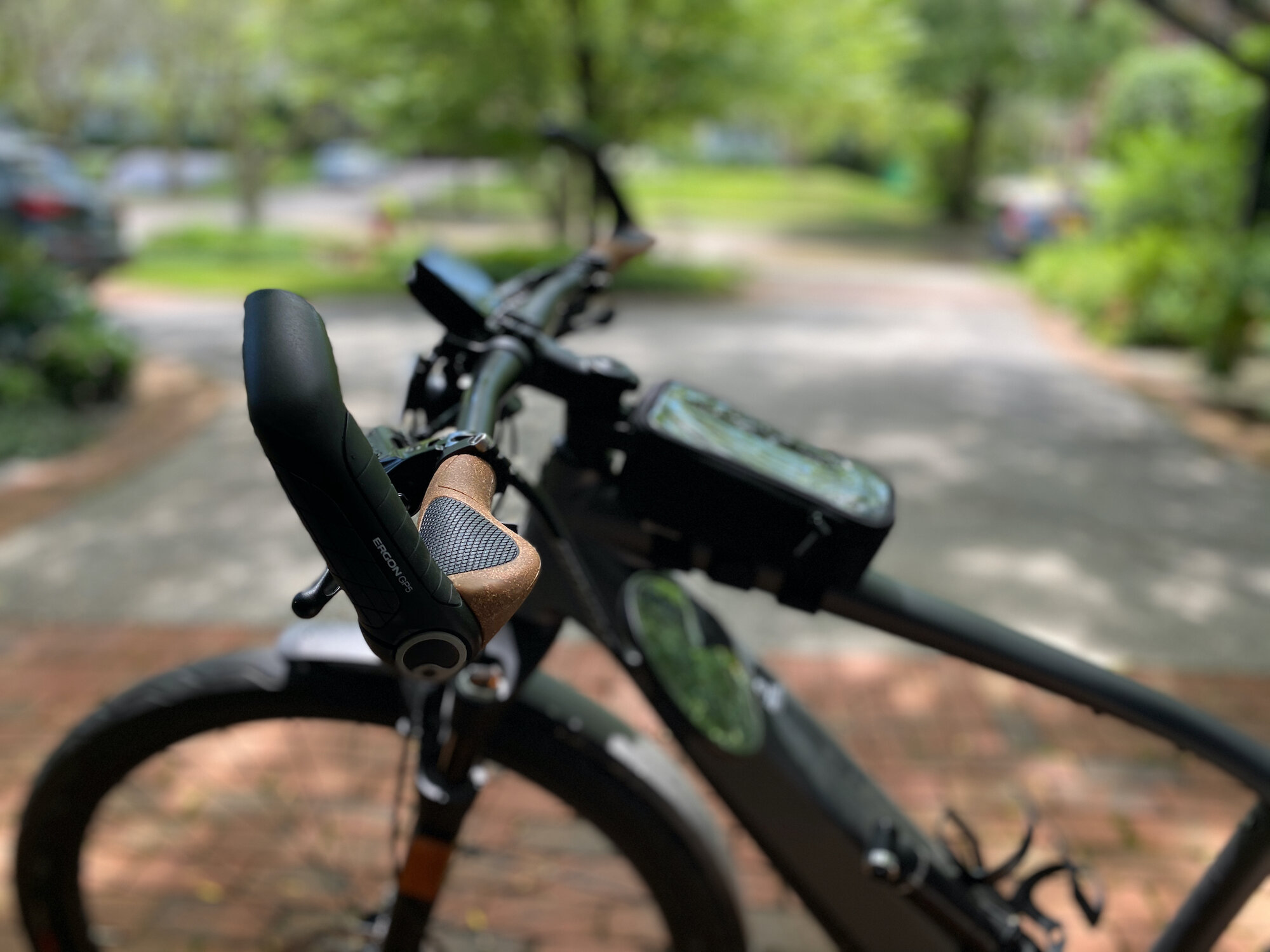

I just installed the Ergon grips this morning on my 2017 turbo Vado 5, took all of 5 minutes, most of which was ensuring that the position of the grips was identical on both sides. A very nice addition as raising my handlebars has proved to be much more difficult.

Just installed the Ergon 5's on my 5.0. The thicker grips are worth the upgrade, didn't realize the difference that would make. Would have been nice to have the grips and horns with separate clamping mechanism. Still have to give it two thumbs up for the price.
The grips and bar ends are separately adjustable, but they do share a single handlebar clamp.

I just used my GP5 on a longer ride. I have the large size and was very comfortable.
I did get a bit of discomfort in my right thumb (my existing issue). I am sure I need to just get used to them.
I also am experimenting with and rotating the angle of the grips.
the horns were a good addition.
I need to find a comfortable fit or o’clock position. Probably something more upright. Then I’ll like them:). Seem pretty wide when using them.
I have the bar ends set almost vertical so when I am tired of bending over the handlebar I can take a break and sit upright for a little.
my issue with the grip is it might be too large for me. Or I also need to find a o’clock position so my palm can sit comfortably on the grip wide section.
Think that is what i am going to do, more vertical. I would have preferred the bar ends to be same diameter as the handles.
Was watching a YouTube on the company and they have put in lots of work designing the barends. Don’t know what but must be a reason for the shape.
assume you have large grip size?
