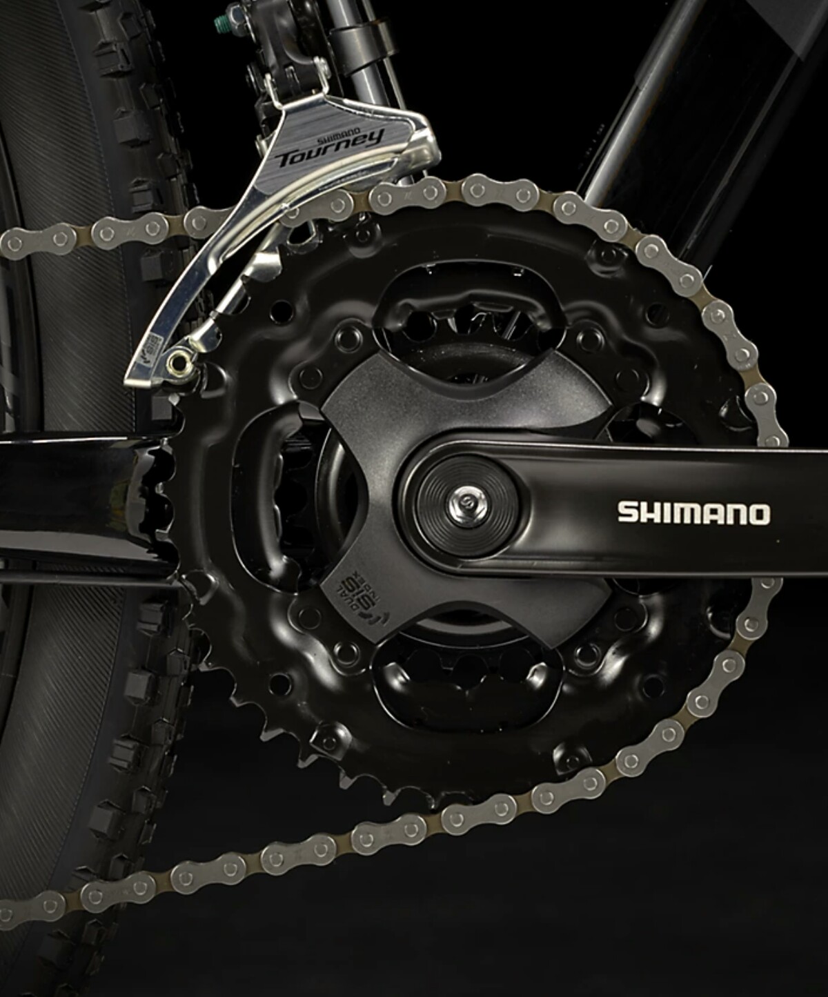

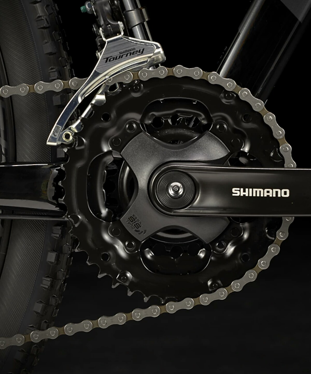

edit.. Just looking at the Marin 5 pics... The stock ring looks as close as your photo.
I will definitely post when it's finished :)
The issue is that the frame curves inward from back to front so that the stock rings just fit and the larger 52t ring stretches out to past where it curves in. Haha I hope that makes sense.
