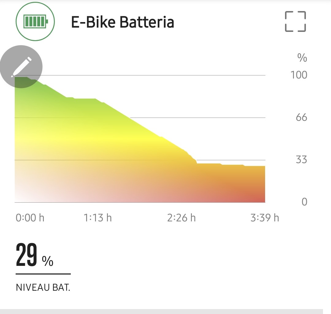

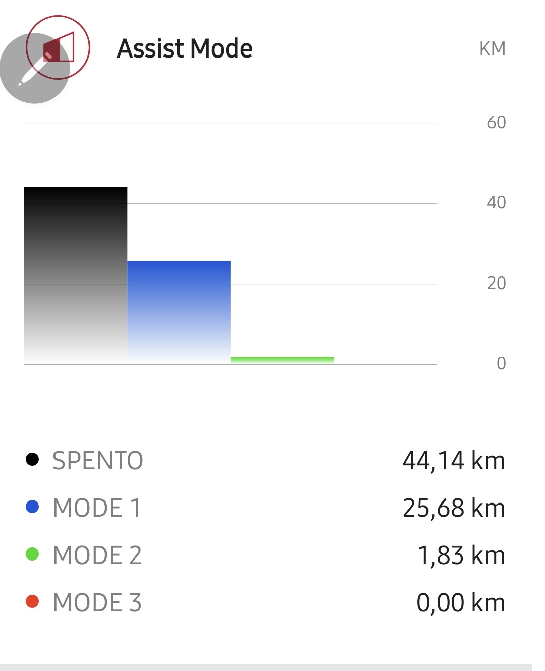

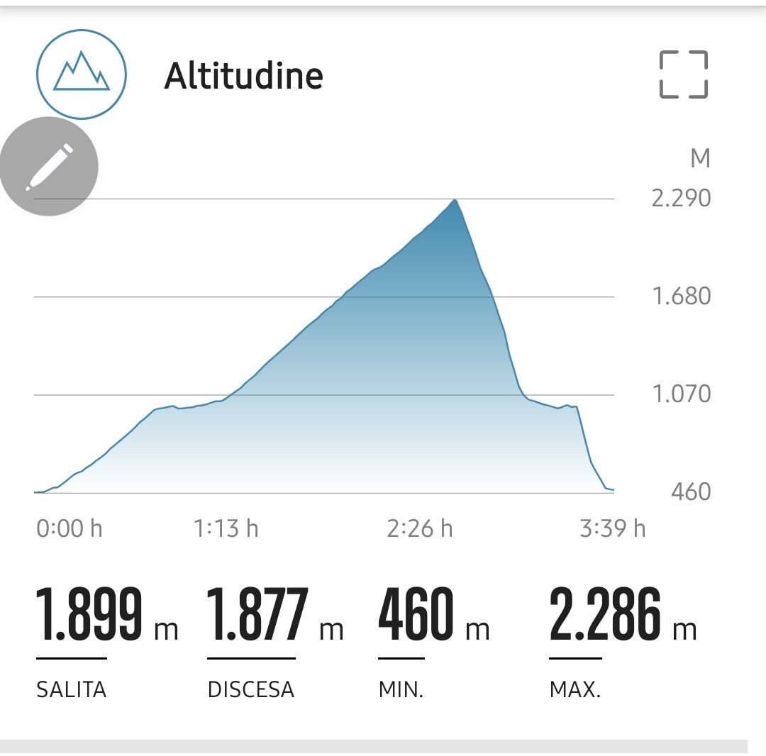

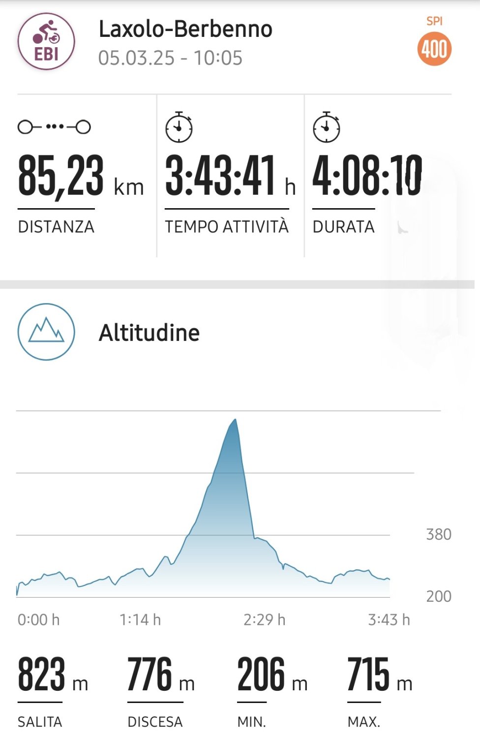

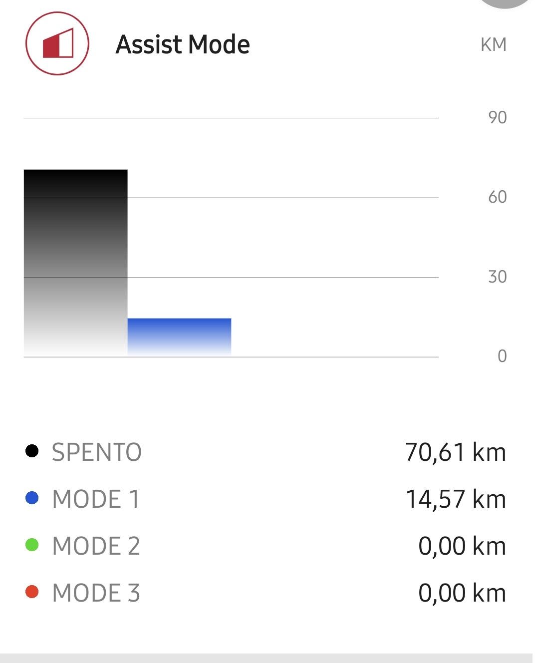

I don't know if You can find useful or of any interest, I enclosed the today's data just as example of typical consumption.As showed 85km/823mt ascent,total battery consumption 23%.
I'm 177cm×77kgs..classified as Young-Senior 😄 even not sure being over 70...
I'm 177cm×77kgs..classified as Young-Senior 😄 even not sure being over 70... View attachment 190234View attachment 190233
Very useful indeed. Fazua is a real mountain motor! Based in my research above, TQ would also work for me although Fazua has more juice (60Nm vs. 50Nm and 432wH vs. 360wH).
