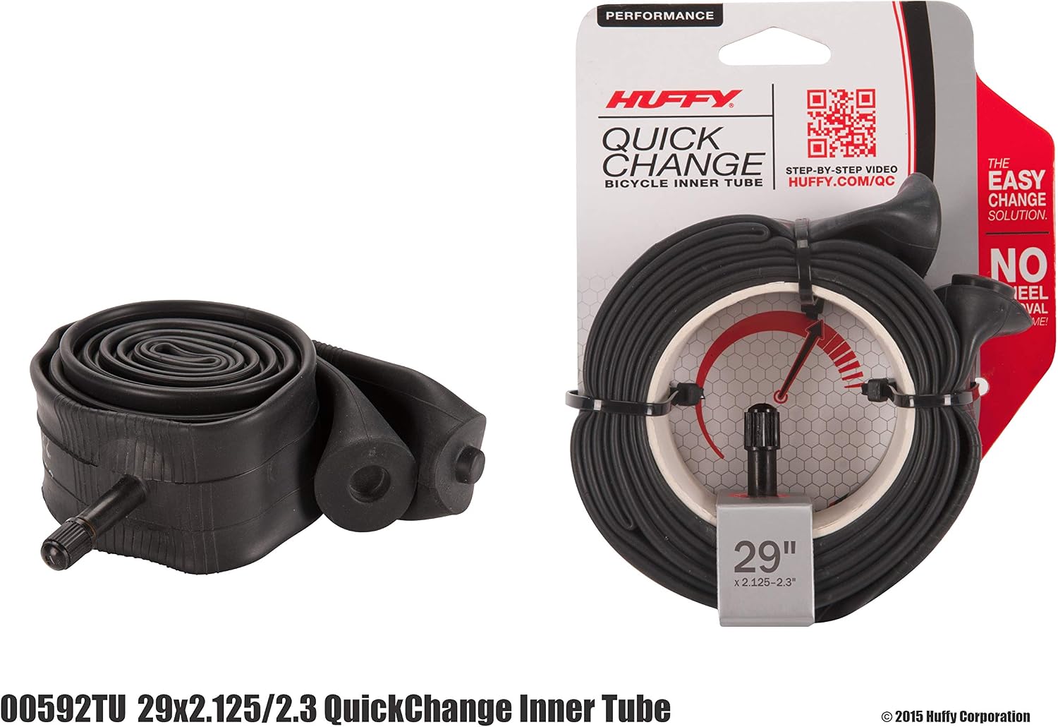

Hey ya'll, Just got a flat on my way home. First one. Haven't changed before. I did buy the Axel nut remover from Juiced. What tube and size do you recommend I get and is there a better tutorial video out there besides the Juiced site one? I do remember there being a tube you can change without taking the wheel off. I don't remember the name and not sure of the quality. Obviously at this point my bike shop is closed and need to get this going asap.
Thanks so much for any responses.

Hi the tube you can use without removing the wheel is called Gaadi. I’ve had one on my rear wheel for around 800 miles and it’s been fine. Highly recommend
