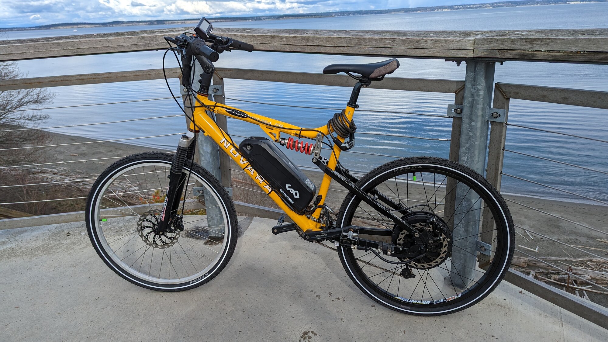

I've started building ebikes out of orphaned bikes. As such, maintenance is a continuous process on everything.

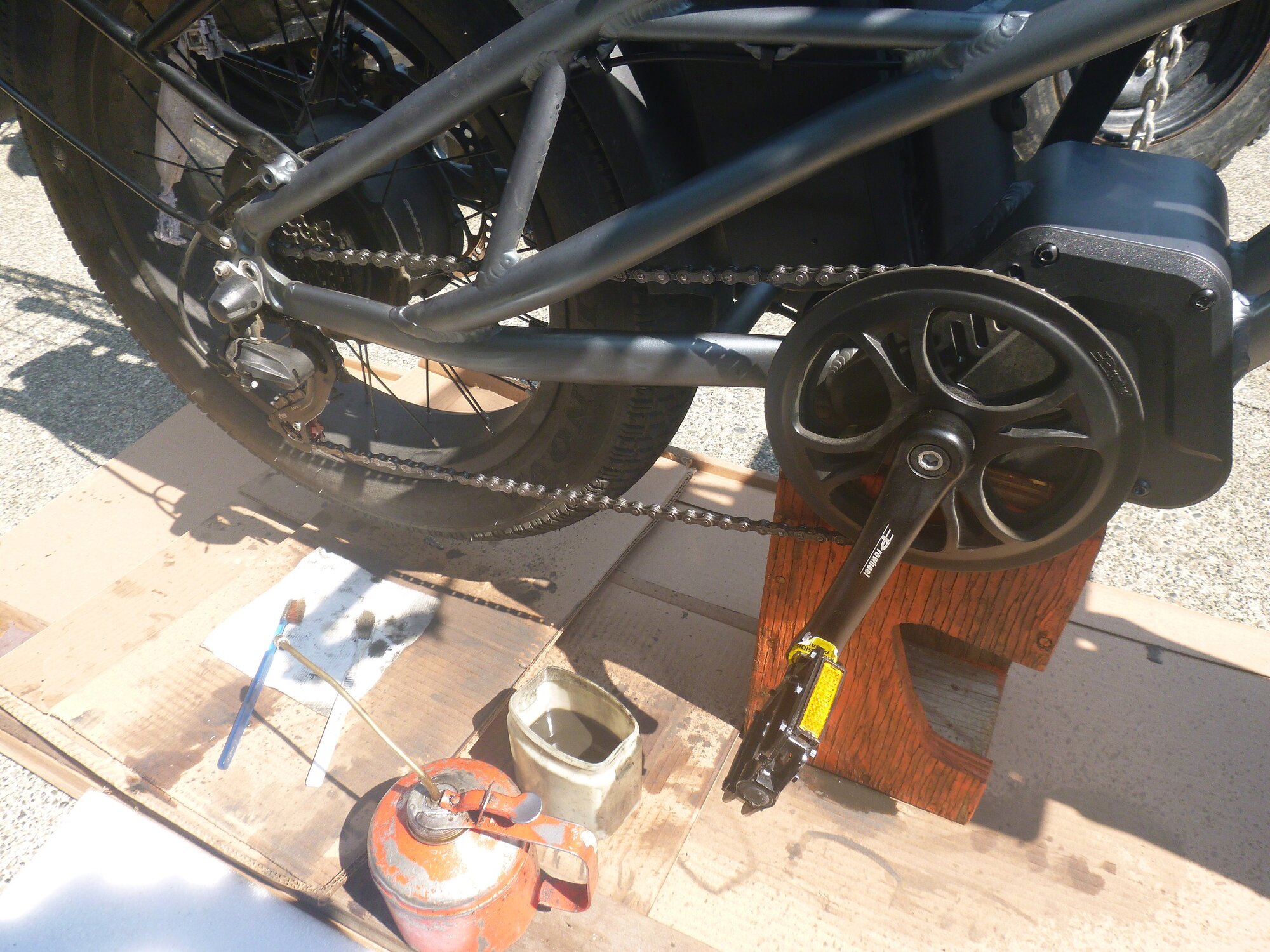

There is a beautifull Bike Trail like a 40 Km round trip but the Trail is hardpacked Gravel which is quite Dusty during these hot Days depositing lots of Grit on the Chain.
To do preventive Maintenance I clean the Chain after 4 to 500 Km, wash/Brush the Chain in a Gasoline Bath while I rotate it on the Bike. Then let it drip off over plenty of Cardboard & Newspaper overnight and then relube the Chain with new 10/30 Engine Oil. Works very well and fast.
To run the Chain in the Gasoline Bath I use a old Starbucks Coffee Mug Filled with Gasoline and push this up on the Derailleur so the Chain makes a sharp Bent and has to travel trough the Gasoline while a old Toothbrush brushes the Grime off. Its a bit Messy so do it outside and dispose of the soiled Cardboard & Newspaper according to local Bylaws.
Simple, efficient, very cost effective and best of all environmentally responsible.
