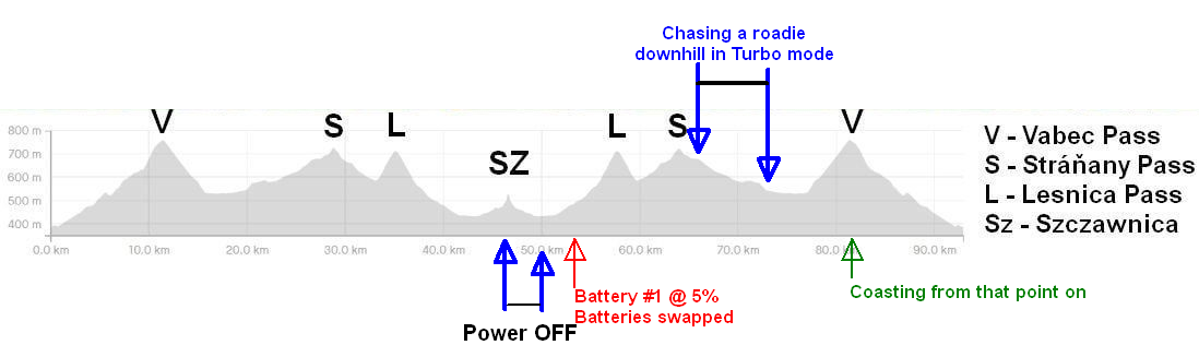

The range considerations need to take many parameters into account. Here are the main factors eating up the battery charge:
  • Rolling resistance
  • Air drag
  • Gaining kinetic energy
  • Gaining potential energy
  • Electronic considerations.
Rolling resistance
It is down to the type of terrain ridden, the tyre type, and to inflation pressure. Of course, smooth asphalt offers far lower rolling resistance than gravel or (especially) dirt. Thick knobby tyres cost a lot of battery charge compared to thin slicks. Lowly inflated tyres will use more of battery charge but are beneficial for ride comfort and better traction. Just compare typical road bike/asphalt vs MTB/forest speeds on traditional bikes.
Air drag
Theory explains that with all other parameters constant, the power demand grows in the third power (cubic) of the increasing relative speed of the bike/cyclist/cargo against the surrounding air.
  • If you want to ride fast, expect high battery charge use;
  • If there is headwind, maintaining good speed will cost the battery charge, but:
    • Provided the wind is blowing with constant speed from the same direction, riding a loop will greatly cancel the headwind losses on the tailwind ride segment
    • It is a grave mistake to plan a loop route starting downwind, as that typically ends up with an empty battery
  • Rider's/bike/cargo frontal area: Just compare the speed of a road bike with a slim cyclist riding in the drops, and wearing spandex to the speed of a cruiser bike with a big cyclist wearing casual clothes (even a poncho) taking the upright riding position and carrying panniers and/or a trailer. The latter (cyclist) is just an air-brake.
Kinetic energy
Whenever you start riding your e-bike, and you accelerate, the battery charge (plus your own pedalling) are converted into the kinetic energy. Kinetic energy gain depends on the moving object mass and acceleration. The heavier the rider/bike/cargo combo is and the more the bike accelerates, the more battery energy is spent. Now, if you let your e-bike coast, part of the kinetic energy is used to maintain the bike's motion until other resistances eat the kinetic energy as much as the bike stops. Note: heavy rider/bike/cargo object will coast far longer. If you, however, use the brakes, your precious kinetic energy will be irreversibly lost to heat in the brakes.
Constant speed on the ride = low battery expenditure. Frequent starts/stops/acceleration = high battery use.
Note: Riding at constant speed in a straight line means you do not waste any battery charge for kinetic energy gain; only rolling resistance and air-drag are countered.
Potential energy
Whenever the rider/bike/cargo combo is to gain elevation, the rider's leg power + the battery charge are converted into the potential energy. Potential energy gain is the product of the object mass and of the elevation gain. It is why hills cost you so much of the battery juice.
Now, it is an interesting phenomenon: the descent. As you're riding downhill, the potential energy is converted to the kinetic energy (you're accelerating, and a heavy object accelerates more). If you can allow coasting on a descent, no battery energy is spent whatsoever. So you have lost battery charge on climbing but your range would increase greatly if you could coast downhill for many miles/kilometres. There is, however, a big "if". If you need to apply the brakes on descents, the precious potential energy gets irreversibly lost to heat.
See this interesting chart:
A planned mountain road trip (a loop) had three big hills in each direction (plus a small one at the ride midpoint). With the spare battery setup, it was necessary to meticulously plan the battery use. It was my fifth mountain riding day, and I had the assistance plan established (the values refer to the full power Vado 5.0 with two 600 Wh batteries and 38T chainring):
  • Eco: 40/60%: used for the rides on the flat or against mild ascents
  • Sport: 60/80%: used for intermediately steep ascents
  • Turbo: 100/100%: used for climbing steep ascents (like, 10-12% grade)

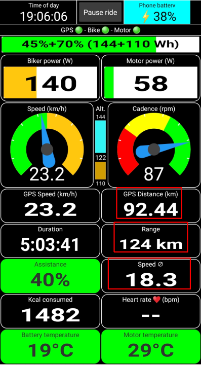

Now: I was using BLEvo to determine the remaining battery #1 range on the outbound leg of the ride (with the 5% safety factor). In case I couldn't make my destination, I would simply give up and start the return leg. I reached my target with some 10% of the battery. Therefore, I was pedalling with the power OFF using the descent nature of the first return segment, and then I rode up mild ascent until the battery #1 reached 5% state of charge and needed to be swapped. At that point, I cleared 57% of the route, so I was on the safe side.
At some point, I was chasing a roadie on a mild descent, and could afford riding in Turbo mode (the energy expenditure downhill is low, as the most of the energy comes from the potential energy loss). Additionally, I knew the very last segment of that ride would mean mostly coasting, so I felt no range anxiety at all.
  • The more energy your legs can input, the less of battery energy is spent (as long as we'are talking the same average speed)
  • Low ambient temperature provides far less energy available from the battery. Important in the wintertime.
Have I forgotten anything?

Jay @Atlgaga,
Now see what you can expect from Vado SL (with Range Extender) if you agree to ride slowly (distances are in km, speed in km/h. Divide by 1.609 for miles. You can also take the 10% safety factor into consideration) :D
Average assistance level was 44%, and my own contribution was 62.3%. Battery consumption (recalculated to the main battery) was 72%.
Jay @Atlgaga,
