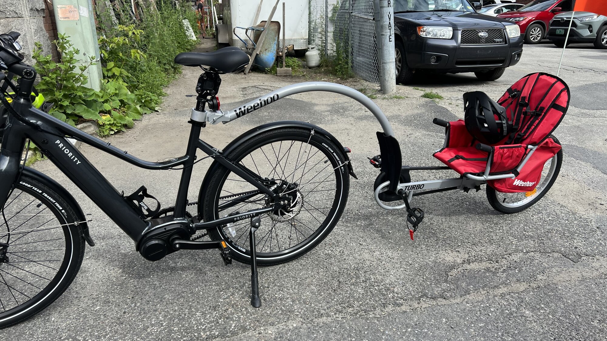

You have the weehoo turbo? (The one with pedals).
I think the issue is my kid doesn’t naturally balance on a bike yet. And he is 77 lbs. there were times when it felt balanced, particularly on smooth road where I was comfortable lifting off the brakes and could let momentum take hold. Then it felt fine.
Haven’t done uphill with him in it. Attached a photo. Trying to find a rack that will fit under that arm. It makes a lot of noise going uphill empty.
