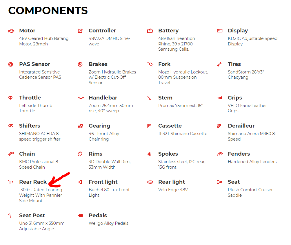

Check those passenger weight limits, which are often buried deep in the specs, if listed at all...
On the new Cafe Cruiser, Ride1Up says 130 lbs

Passenger is within the 130lb limit. Not a balance issue, just can't pedal much.

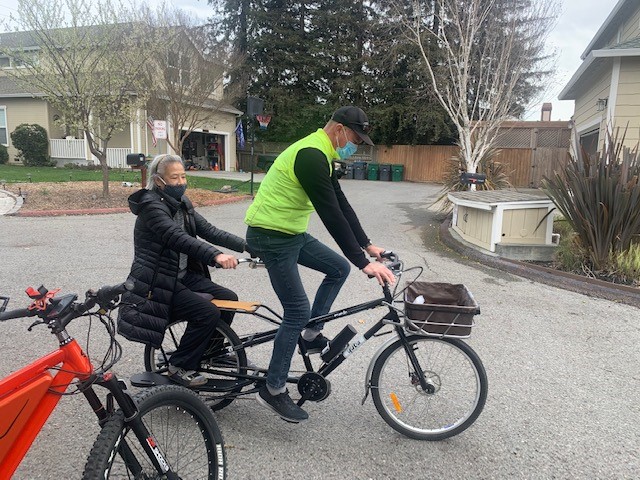

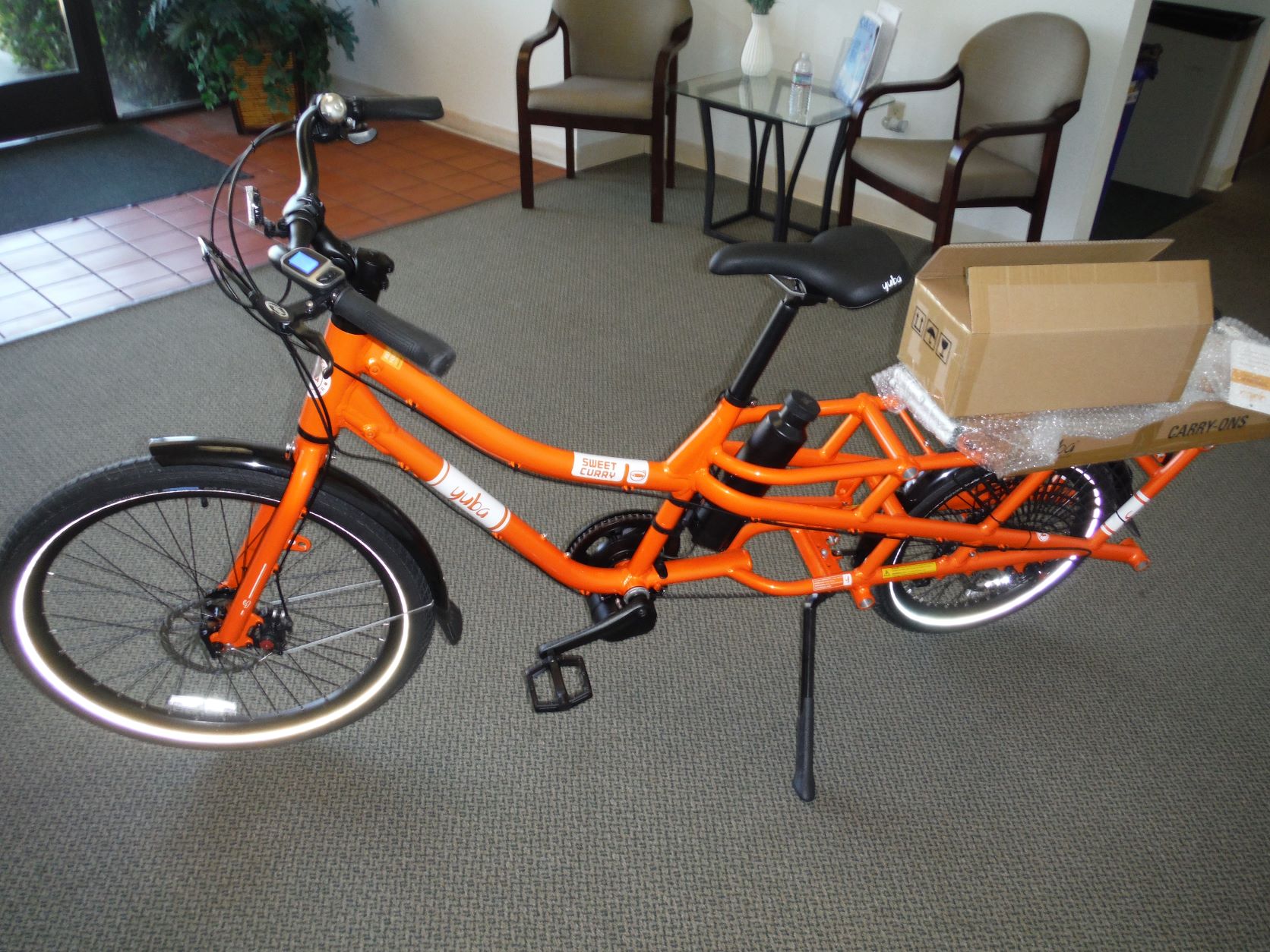

I made a bike specifically for my friend Alan. This orange one. His wife used to be an avid rider. He and their friends still are. He wanted her to join in. On a low speed test ride in a safe, flat parking lot. She fell off once and they nearly crashed twice within two minutes. She can walk just fine but because of her impaired coordination their timing was slightly off and they were overcompensating for each other. I have also experienced being the lead rider with someone with slight coordination issues on the back of a cargo bike. I have good balance and was constantly fighting her to keep us upright. It was a very strong bike, a steel Mundo, but with her on it it felt like a wet noodle.

Are you under 300lbs between you (including stuff you might carry)? That's the total payload cap of the Cafe Cruiser
