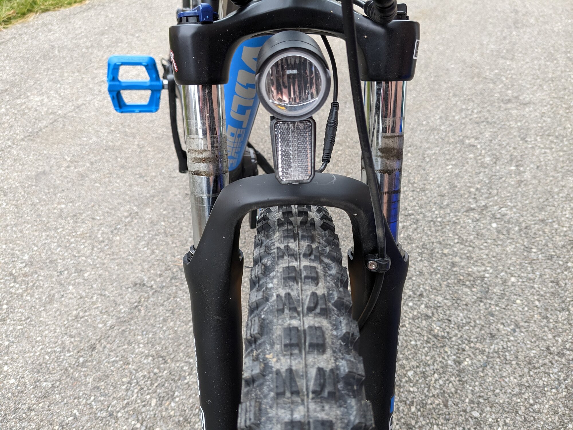

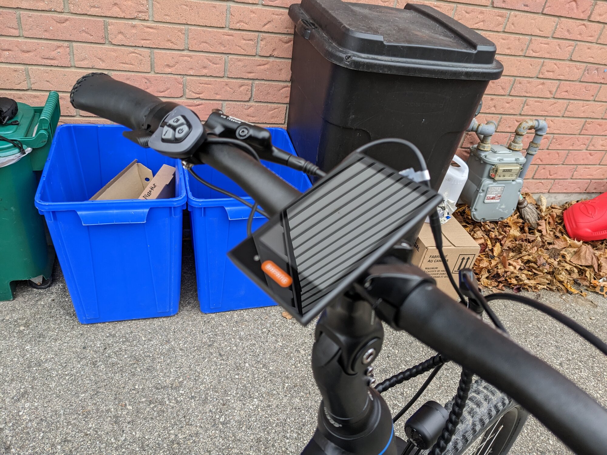

So my headlight is built into my wiring harness. It's about a 40 lumen lamp standard $20 headlight they put on every ebike and is not very bright. Let's assume it's a 12v or 20v light, is it possible to upgrade this to like a 1500 lumen head light? I know it will draw more current but how do I know what my controller will allow. How can I test to see if it's 1A or 5A or even 500 mA. Is there an easy way to find out? Also what happens if I put something on it that draws too much? will it just provide it with the max and that it or will it damage the circuit if I try to draw 2A and it's only rated for 1A.

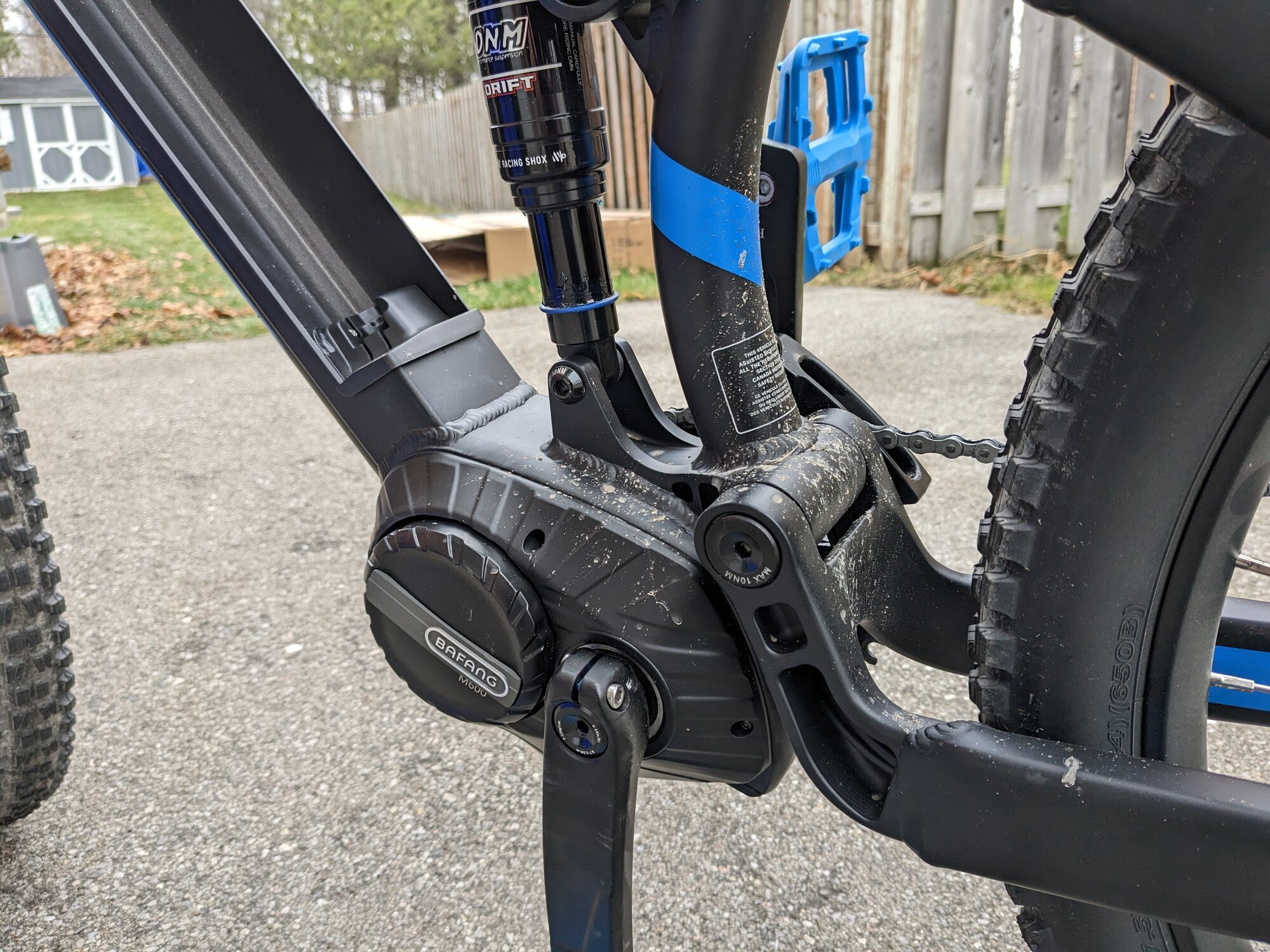

For reference I have a 2022 VoltVike Enduro with the Befang M600 motor and color screen. I have no idea the controller.

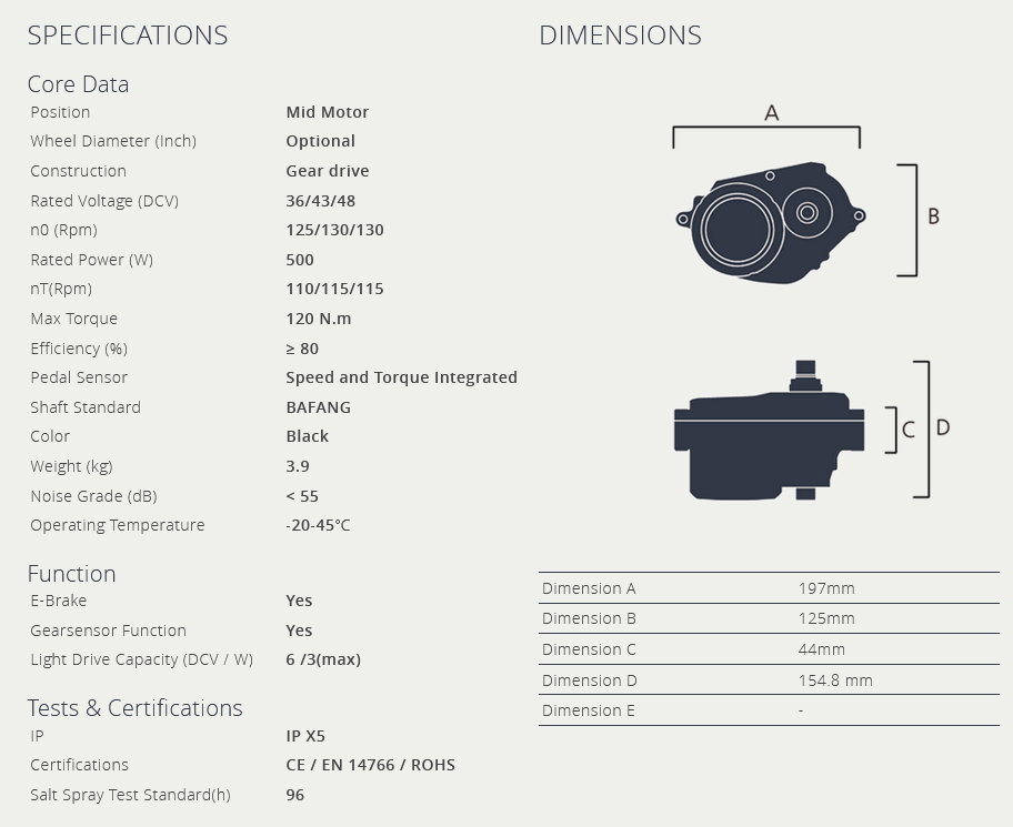

No. The controller simply won't support a powerful light (6V, 3W max):
