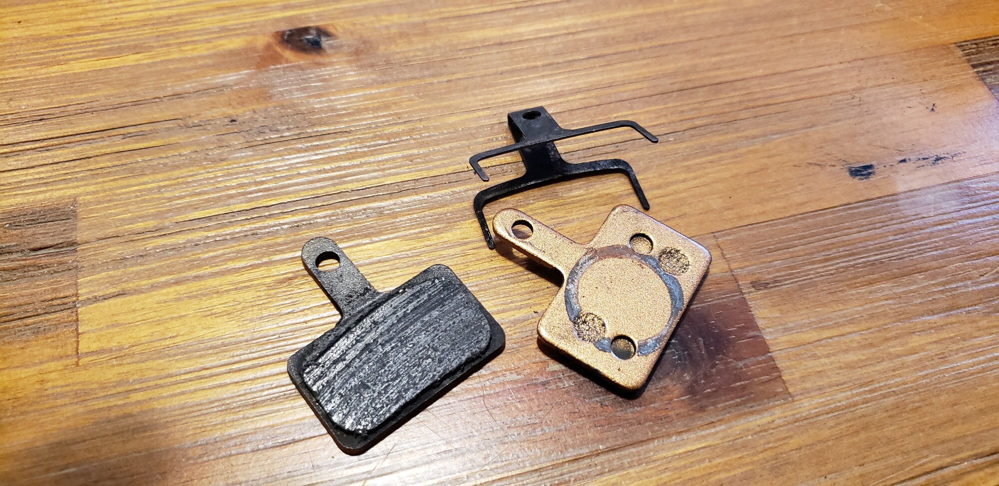

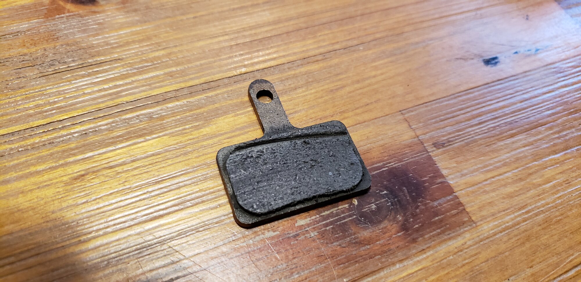

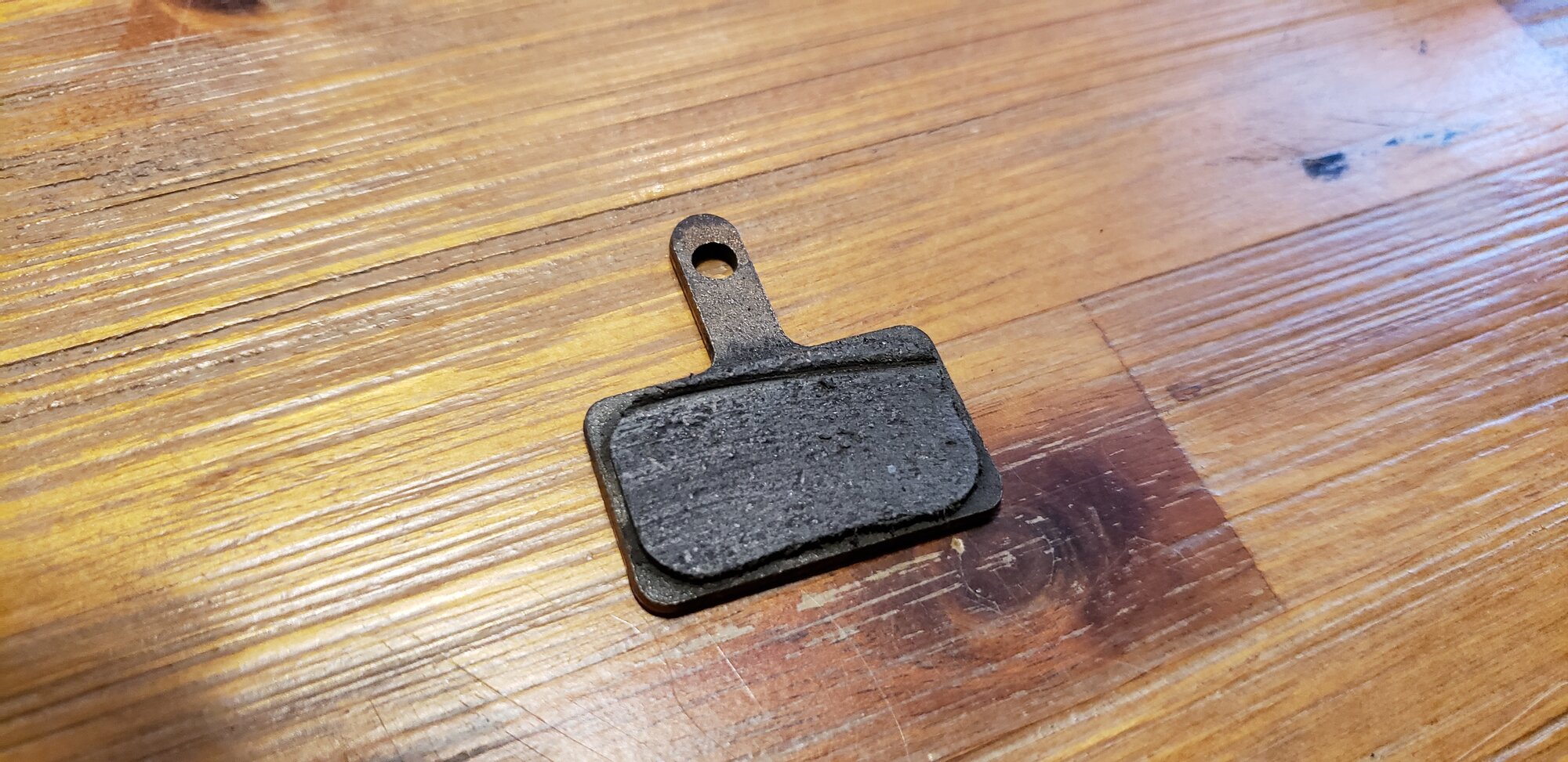

I've got 600+ miles on my X3 Pro and absolutely love it :)
Was out riding yesterday and it started making an annoying rubbing squealing sound from the rear tire :oops:
Thought it might be a bearing, but after getting home, I gave it a quick look and it appears my rear pads are toast :(
1) What are the best replacement pads that will not make noise? (the front brakes are more like a car horn when I grab them, which is why I tend to use the rear more)
2) Are the front pads the same as the rear? (If they are, I'll most likely do a swap just to get by until the new ones arrive)
Just checked and actually have 755 miles on the OD
Ordered a set of Corki pads (first thing that popped up on Google) and they should arrive later today
I hope they fit cause just eyeballed them
Swapped them around for now and the rubbing noise is gone, but squeals like crazy under hard braking

Swapped them around for now and the rubbing noise is gone, but squeals like crazy under hard brakingView attachment 99245View attachment 99246
They look like the same style some Shimano and Tektro use.
Organic pads stop better in most circumstances and are quieter than semi metallic pads, but don't last as long. There's always a tradeoff.
This thread is my experience with new pads at ~500 miles;
Cleaning the rotors and 'bedding in' the new pads is always a good idea to help eliminate squeals.
BTW - From your pics it appears that the pads have a ridge worn into them. Seems that the calipers might need a bit of adjustment, just sayin' 😎
