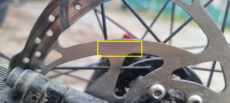

Let me start with the current thickness of the TRP TR180-29 rotors on my bike is:
  • Front: 1.67 mm
  • Rear: 1.57 mm
This is rather a surprising discovery, as one might expect the front rotor would wear faster! There is still a lot of life in the rotors, as the limit thickness would be 1.4 mm, and the original thickness was 1.8 mm.
The model number is barely visible on the rotor.

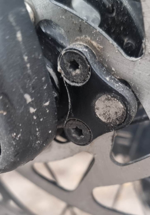

The Tektro e-bike magnet holder for 6-bolt rotors.

Shimano uses anti-loosen plates on some rotors to secure the bolt heads against loosening. Such a plate cannot be used with the Tektro magnet holder (which requires a flat rotor surface to be mounted).
(5) Rear wheel magnet holder.
It is very difficult to find and order the proper part here. Shimano is happy to deliver a combo of a rotor with matching e-bike magnet holder; at an absurd price, taking into account the magnet holder price is some US$10, were it available!
