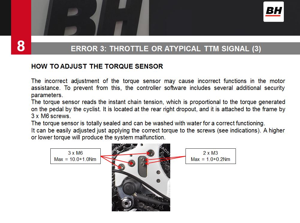

There is one very noticeable difference between the Carbon and the Cross and I suspect it has something to do with adjusting the torque sensor. I've ridden both and the Carbon is noticeably more responsive to lower torque levels. The Cross won't kick into pedal assist until a significantly greater force is put on the chain. If anyone can point to a manual that describes adjusting the sensor I'd appreciate it. The torque setting on the Carbon is much better.....hopefully it's a matter of adjustment on the Cross.

We have two Neo's as well and they are pure delight to ride on. I looked up my manual regarding the Torque sensor adjustment and I am attaching the file here. It should be fairly straight fwd if you use the right tools. Did you check with your dealer as to why this discrepancy in sensitivity ?

We have two Neo's as well and they are pure delight to ride on. I looked up my manual regarding the Torque sensor adjustment and I am attaching the file here. It should be fairly straight fwd if you use the right tools. Did you check with your dealer as to why this discrepancy in sensitivity ? View attachment 1079
Thanks Ravi. I did talk to the bike shop tech, who did talk to support and they confirmed that the sensor can be adjusted. Make an indicator mark on the fastener and plate, and make small adjustments, test and repeat until satisfied with the result. The only reason I want to adjust the sensor on the Cross is the difference between the two bikes, it's very noticeable, they don't work alike at all! Funny, if I had only ridden the Cross, I'd probably not know that there could be that much variability in the pedal assist.
