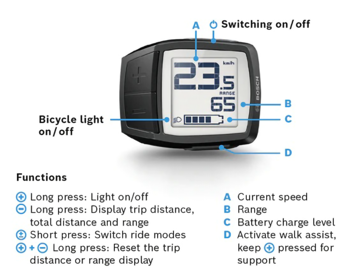

On the Bosch system you are pressing the + button which is at the top of the remote. Not ideal for walking and pushing, at least when you are fighting rocks at the same time.
Button layout on the remote for the intuvia etc is roughly the same. You would need to push the D button to activate the Walkassit mode and than keep pressing the [+] button.
speed related. you need to shift to the hightest gear (smallest cog/flat mountain with enviolo etc) for the most speed with the walkassist, than it would go up to 6 km/h. with the lowest gear possible it would go slow but it would be rather powerful to push the bike up a hill (fully loaded). Shifting is key in this.
