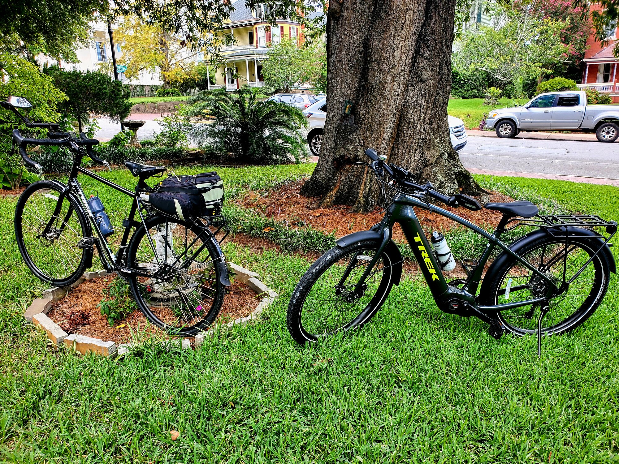

There are always people who enjoy making childish criticism. By the way my phone also ejected from the phone mount on my 23 Allant 8S. This happened on my first ride after hitting a small hole. As a nimble 76 year old, I caught the phone before it hit the ground. I'm looking for solutions, but having a hard time in finding one. I do like the bike as it is a beast.
