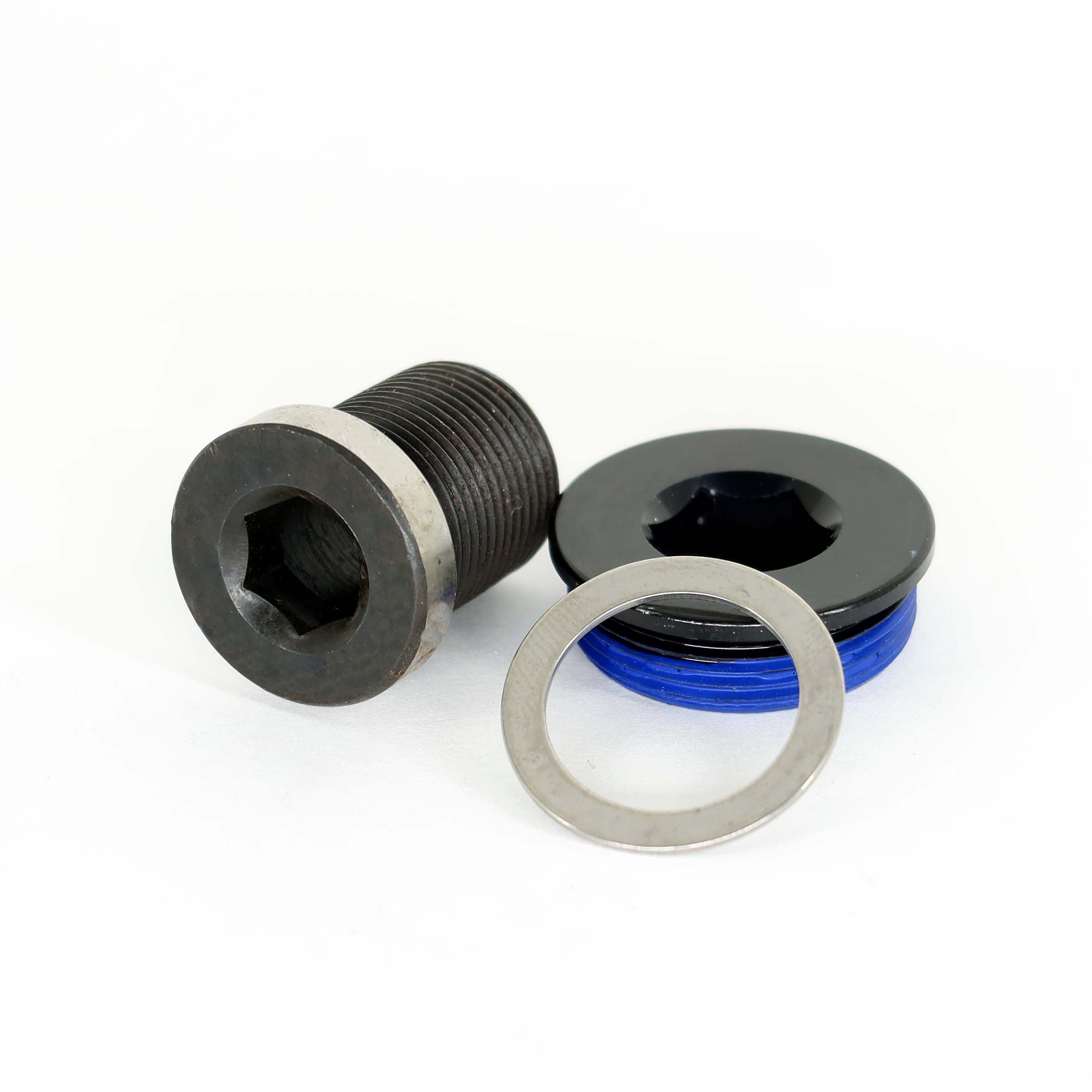

I looked at a photo of the Samurai, looks like it has e*thirteen e*spec plus cranks. Note the mounting bolt part number at the bottom of the photo - looks like a pretty standard m15, not self extracting.
Link to the bolt
