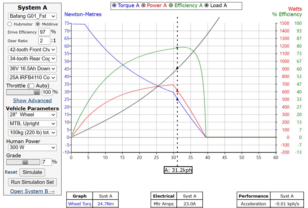

Yes, it is complicated and it is a problem that Bosch is so unwilling to share information. But the kind of information I'm looking for exists for other brands. For example here: https://ebikes.ca/tools/simulator.h...hp=300&cont=C25&batt=B3617_35E&motor=MG01_FST
Maybe someone has an idea as to which of the stated motors is most similar to Bosch CX?
Also note that if you switch controls, the red curve will also change quite significantly if you go from 20 to 25A. This is related to my original post. But of course it is not as simple as A times V equals W. The controller also has other ways of regulating the engine's performance.
